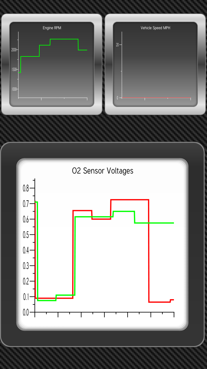

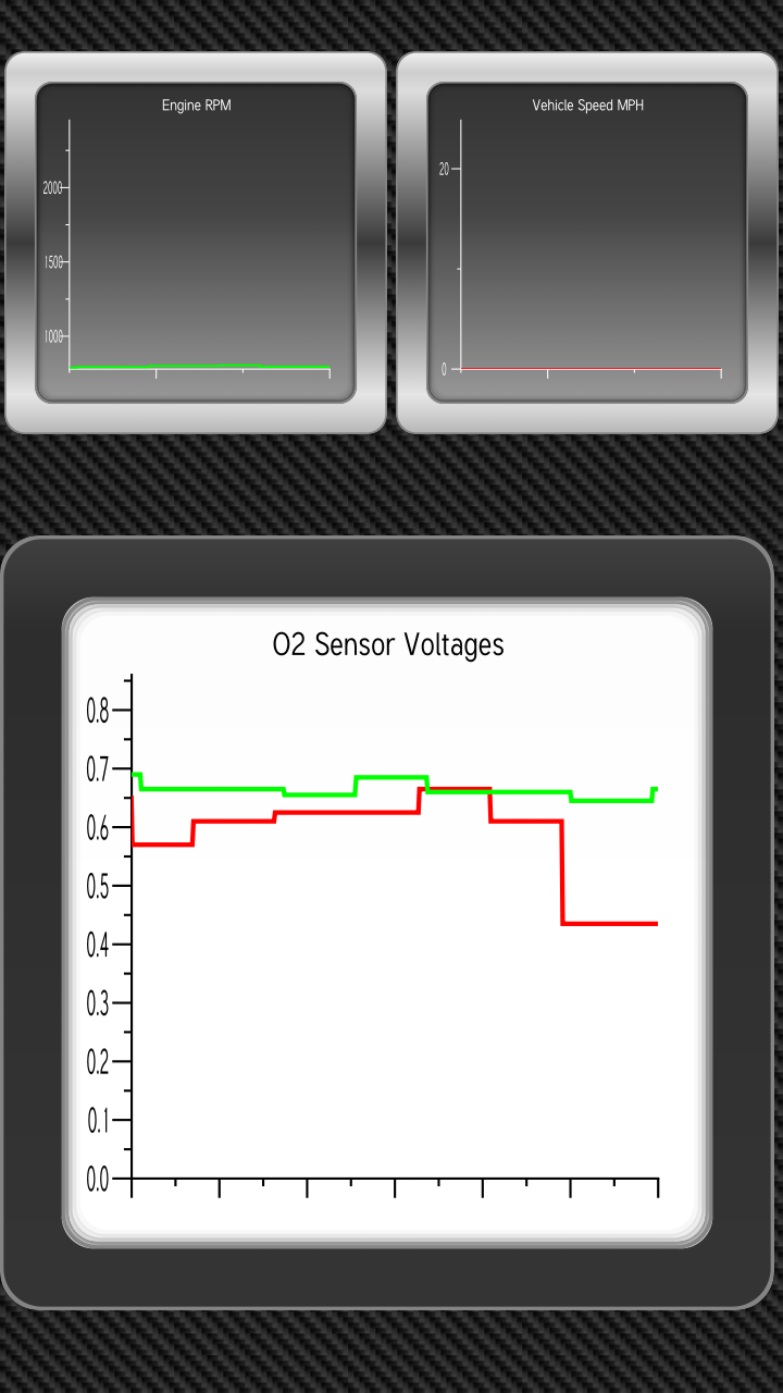

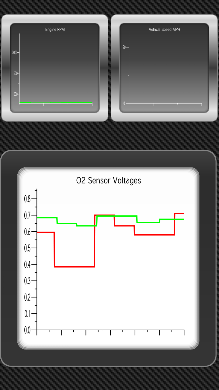

    I am struggling with huge burning that has nothing to do with computer readings.
    Are the indications as in the pictures below correct? The engine is warm.
    Probe in front of the catalyst - red
    Probe behind the catalyst - green
    Correct Lambda Probe Readings for KIA Carens 1.8: Comparing Front & Rear Catalyst Probes
    Correct Lambda Probe Readings for KIA Carens 1.8: Comparing Front & Rear Catalyst Probes Correct Lambda Probe Readings for KIA Carens 1.8: Comparing Front & Rear Catalyst Probes

    Jarzabek666 wrote:
    The picture does not give the most important data "time" these charts mean nothing without time and tension.
    Tomorrow I'll try to do another program.

    TomekB123 wrote:
    take a meter and check how fast it is oscillating.

    Combustion is affected only by the first probe and the graphs show that it works properly.
    Check the signal from the probe during engine braking and acceleration, and how the ignition timing changes.
    Unscrew the candles and check their color.

    Jarzabek666 wrote:
    within 5 seconds once what disqualifies her as functional.
    It does not necessarily disqualify the poll. the probe can work well and the problem may be on the fuel supply side of the engine (for example)
    Which doesn't change the fact that you can't say anything from the charts.
