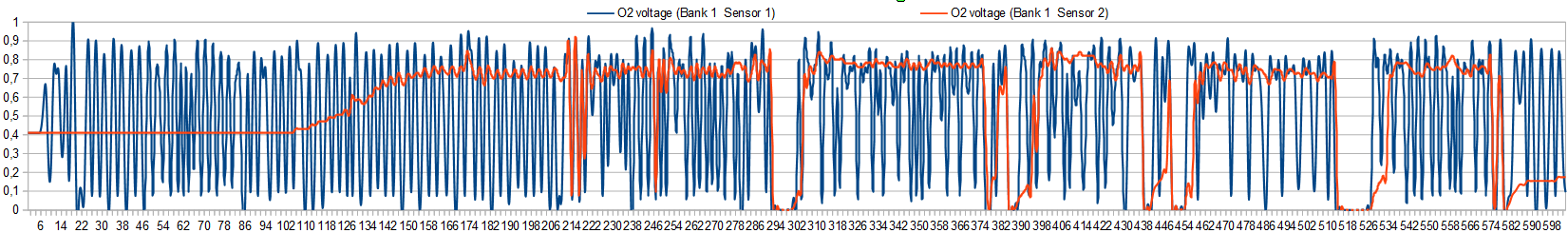

    I get error P0133 from time to time. The first probe in front of the catalyst has been replaced with a new one, the error still pops up. Please let me know if both probes work well on the attached chart. The graph starts with idling, accelerating the car up to 90 km / H, with some engine braking (when the values from both probes drop to zero in the graph) and ends with the vehicle stopping.

    I understand that the vertical axis is tension and the vertical axis is time or what? How is time in what units?

    Yes, vertical axis voltage from 0 to 1 V horizontal axis time in seconds increments.

    In case of sporadic problems with sensors, it is worth reading the frozen frame, i.e. the error conditions. It cannot be otherwise. The graph of the first is correct, the second probe initially works too linear, but it should show fluctuations of about 200mV (This one works like a new one)
    You do not need to drive because it is not known when there is an anomaly, when accelerating, when braking, when changing gear, etc.
    Do the same with idle, second plot around 3000 rpm
    But as I mentioned, the error can only occur under certain conditions.
    You have replaced the first probe, or maybe the second is faulty.
    The probe downstream of the catalyst performs the function of monitoring the operation of the oxidation catalyst and the diagnostic function of the operation of the first probe. If it doesn't work properly, the driver will interpret it as a malfunction first.
    The frozen frame was read and deleted three times. This error occurred while driving at constant speed out of town.

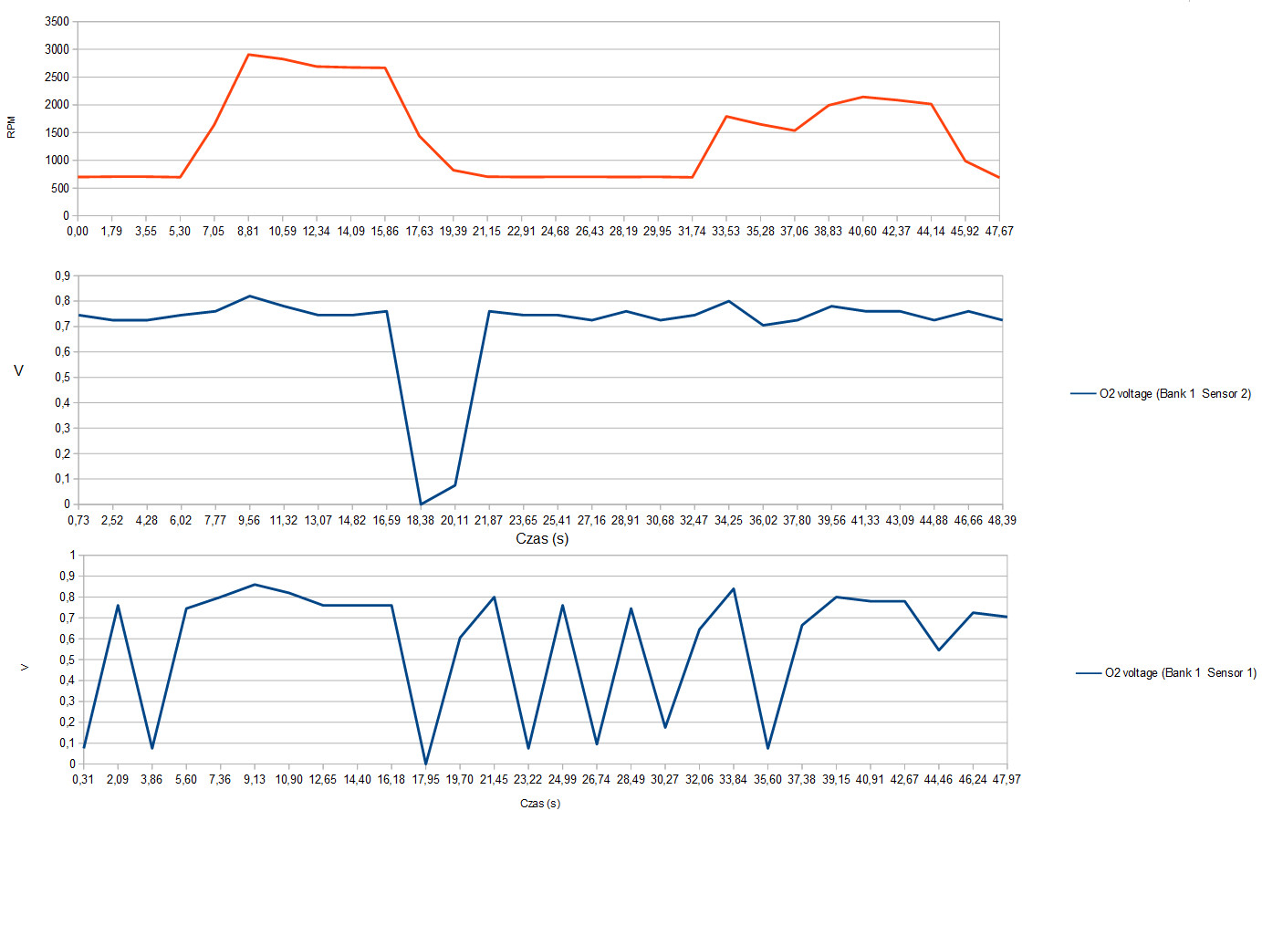

    I did the second chart this is real not "squeezed" :) . Now it seems to me that the data is sampled and saved too slowly from the probes at intervals of about seconds.

    Thank you for your answer. This information is very helpful in understanding how it works. I will try to replace the second probe and present the result of its work.

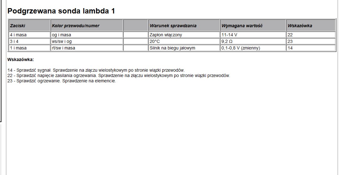

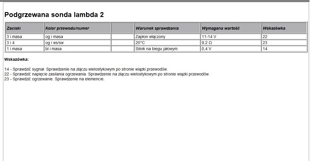

    The pictures show the measurement results for probe 1 and 2

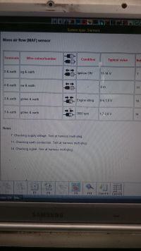

    Could I have the same factory data for the flow meter please check it too.

    Leave the other probe alone. What was the description of this error - slow response? Check the heater power supply, pins in the plug, the harness between the probe and the ECU.

    Here you have a flow meter

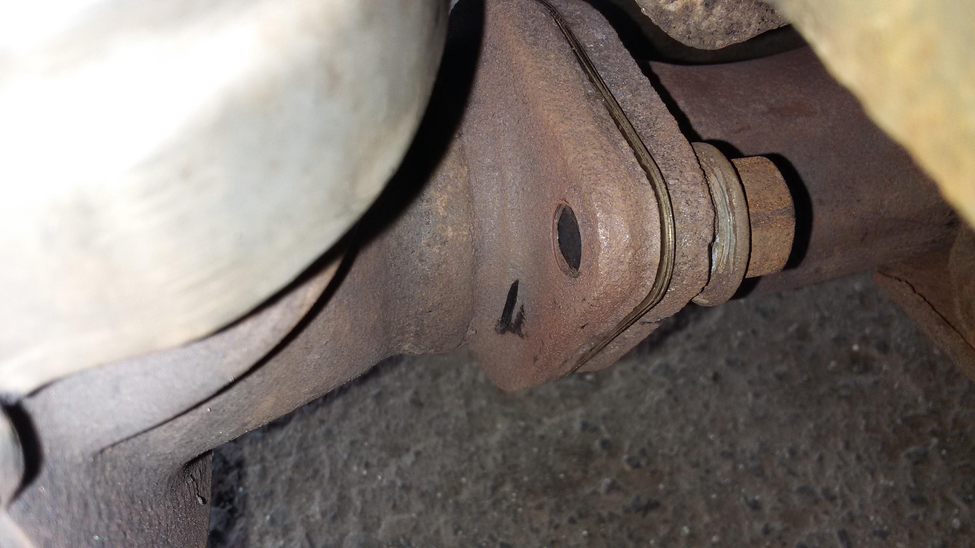

    Thank you for sending the parameters. I measured the resistance, according to the diagram it shows 2 ? instead of 0 ?. I found something else regarding the leak. I recently had a flexible link replaced. At the top of the seals you can see a little black and the seal itself can be moved to the sides with your finger on one side.

    I sealed this place the error is back. I keep searching.
