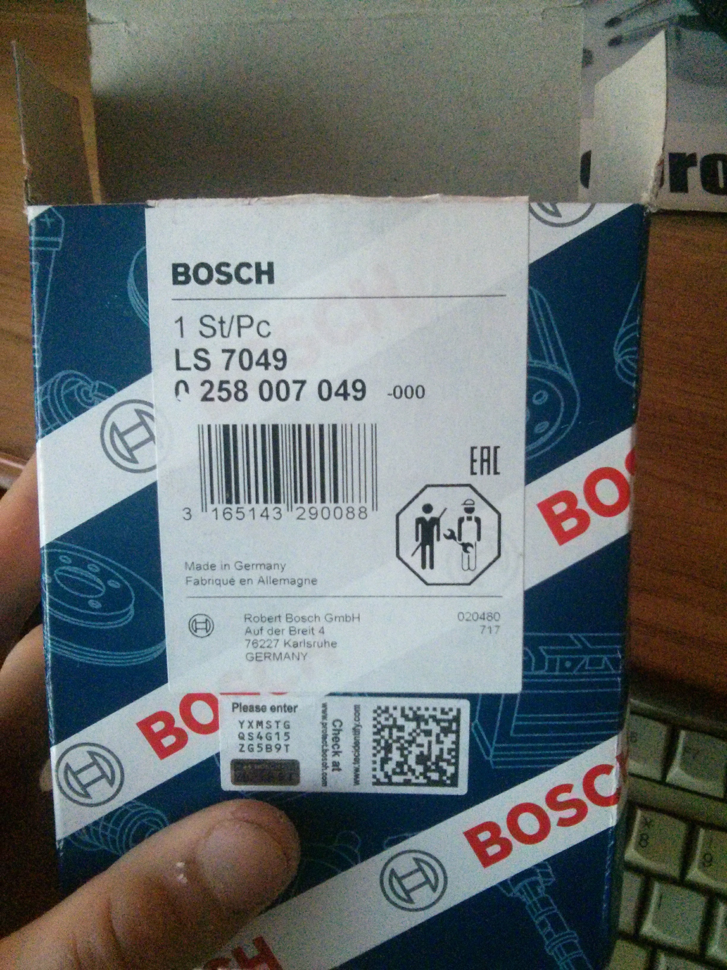

    Recently I got a lambda probe fault (lambda probe heating circuit bank 1 sensor 1). Without thinking about it, I replaced the probe with a new one. But the error has not disappeared. It's still the same. I checked the wires running from the controller to the probe and it seems to be okay. The thickest cables running from the controller to the cube are 12V, with the engine running, it was slightly higher. I measured the resistance in the old probe on the white and gray wire because it would give them voltage running from the controller and the meter showed nothing. I also measured in the new probe I bought and the meter did not show anything. Here my question arises whether I received a faulty specimen or whether the voltage running from the controller is too large and burns the heater. Is it possible that the fuse is too big?

    You did not write what probe you have.
    The colleague gave a description for NTK (NGK) and you have Bosch LSU-4.
    For Bosch, the heater is gray (+), white (-).
    Gray has power after the ignition and the mass is given from the ECU, i.e. the ECU controls the power of the heater.

    Yes, I have a bosha and I have to understand that the maximum voltage on the probe is 12V and with this voltage nothing will happen to the heater?

    How much did the new probe cost?
    This probe in the original from Bosch is about PLN 500.
  • #7 16446605
    koles2233
    Posts: 17
    Rate: 15
    Board Language: polish
    I bought a new original boscha for about 350 zlotys at a discount. I have no idea what might be wrong. The only variant that suits me is that this probe is faulty. I checked the voltage in the plug and there is 12V and there is no resistance on the white-gray wires on the probe. Is there any other possible way to check this probe? Seat Leon 1.8 20V - Lambda Probe Fault: Replaced Sensor, Error Persists, Wiring & Voltage Checked
    The exchange helped. The new probe was faulty :)

    Replacing the probe helped :)
