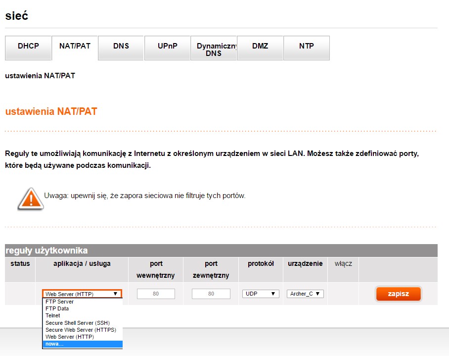

    strzala232
    Posts: 10
    And when it comes to port forwarding from FunBox, this is what we're talking about:
    TP Link Archer C58 OpenVPN Server Setup: Connecting to Local Area Network Remotely Overseas
    Added after 2 [hours] 53 [minutes]:
    Typing in the public IP address helped. OpenVPN connects to a given IP address. Now I have another problem / question:
    How to get to a folder shared by one of the computers (one of the computers has a shared folder that can be seen on other computers in the local network).
    I connect remotely to the TP link router and the computer is connected to the Fun Box with a cable
