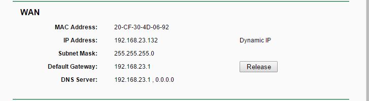

    I would like to remotely access my computer from an external network.
    The router I have is TPLINK TL-WR740N.
    1. I have set the IP address of the computer I want to access to 192.168.1.102
    2. I set the redirection of port 3389 to the address 192.168.1.102 in the Forwarding -> virtual server tab on the router
    3. I went to the website: http://twojeip.wp.pl/ and got an external IP
    4. On a computer in a different network, I launched the remote desktop, I entered:
    my_external_IP: 3389, but I can't access it.
    What else should I set? What did I do wrong ?
    Thanks for the answer and best regards :)

    #6 14298001
    jimasek
    Posts: 35287
    Help: 3783
    Rate: 2681
    You have several options:
    - purchasing a public IP address from an internet provider
    - TeamViver application for remote access
    - purchase of an account for VPN or VPS servers with VPN service

    I don't know your ISP's network configuration, at first glance it looks like a public IP address is shared by a few or a dozen users on your ISP's network.

    I called my provider, he didn't have any problems and reportedly he redirected the public address to my address 192.168.23.132 on the spot. I am not able to check now, when I will be at home, I will let you know. Theoretically, after entering the public IP address, should I be able to access my router now?

    I set up www access on my router and now I have public IP access. The supplier told me he had forwarded all the ports. Tomorrow I will check if port forwarding works, I want to set up Ubuntu on a virtual machine and set up a file server and a web server. Before I buy a Raspberry Pi, I would like to practice a bit on what is immediately available :)
