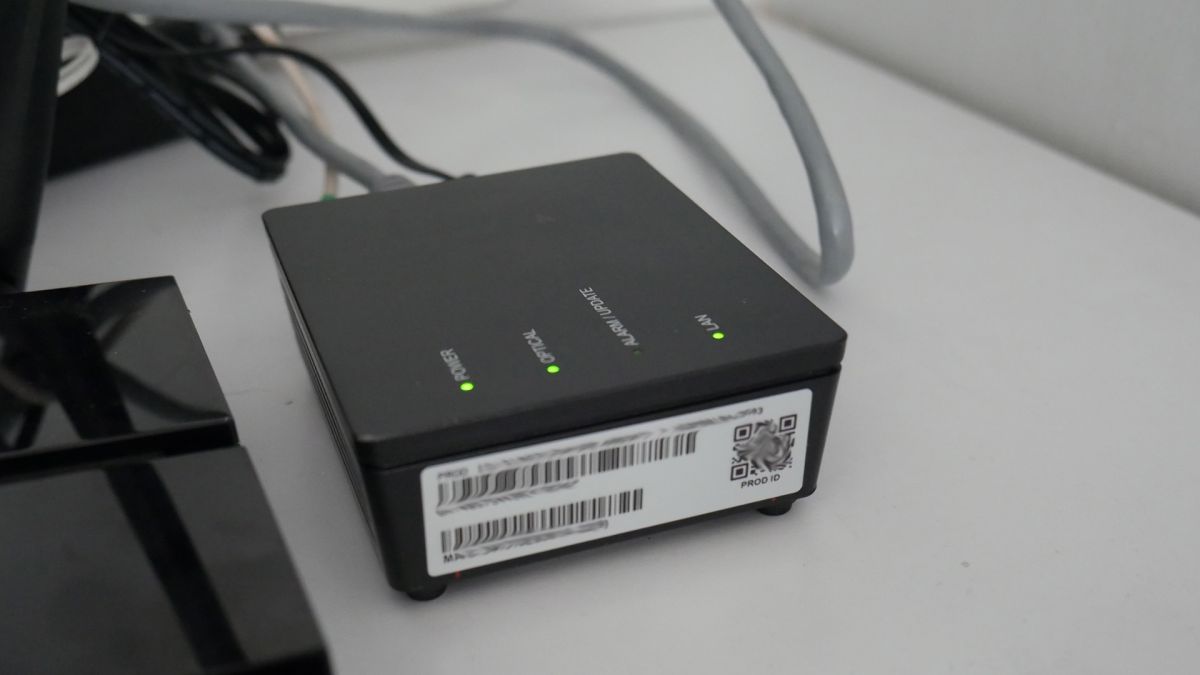

    A simple puzzle (probably), I would like to know how (and if it is even possible) I can connect my own router (Archer VR400 v3) to an external ONT from Orange instead of Funbox 6. I tried to do it myself, but I failed and I ran out of ideas, I also looked through other threads on this forum and other forums/sites, but I still couldn't find a clear answer.
    I am interested in completely replacing Funbox 6 with my own router, so that I only have one router connected, but if that is not possible, I would also be content with connecting my own router to the Funbox, so that the Funbox is a kind of "bridge".
    I am asking for help from some kind souls.

    KOCUREK1970 wrote:
    And did you get a separate ONY and a separate FB6?
    Did you only get FB6?
    I got ONT and funbox 6.
    The ONT is separate, it looks like this:
    Orange fiber optic 600 MB/s, funbox 6, external ont, own Archer VR400 router

    Have you set up login details using PPPoE? And VLAN 35 for internet access?
  • #5 20203284
    Anmitsu
    Posts: 43
    Board Language: polish
    oculars_increasers wrote:
    Have you set up login details using PPPoE? And VLAN 35 for Internet access?
    No, because I don’t know where to get Orange’s login details, as they are apparently downloaded directly from funbox.
    I tried using the old ones but they don’t work.

    Everything is possible. Orange probably has the most liberal policy of the large operators in this matter.
    Anmitsu wrote:
    When I asked the technician, he told me that now there is no need to enter the login and password, that now they are downloaded directly from the router.
    Did he lie or just not tell the whole truth if it is as you write?
    He spoke the truth. But this only applies to FB, which downloads data automatically from the operator. You enter the data into your own router.
    You do this
    1. You call the hotline and ask for PPPoE login details. Alternatively, you log in to the My Orange application and after confirming the SMS, you have a tab with PPPoE data
    2. You configure your router
    a. PPPoE login
    b. PPPoE password
    c. set VLAN to 35
    Everything works. Nothing has changed. I configure it myself so often and the last time I did it was 2 weeks ago. Additionally, you can make a full dual stack, but I won`t tell you how to do it because you still have problems with the basics.
    Another thing is that you want to replace a really good router, such as FB, with some toys.

    Log in to orange.pl, generate a new connection password. You will then receive it via SMS along with your login. You then enter this data in the router's WAN settings. At the same time, you configure the VLAN in the IPTV tab - Internet VLAN ID 35, priority 0, 802.1Q TAG selected. It can't be simpler.
