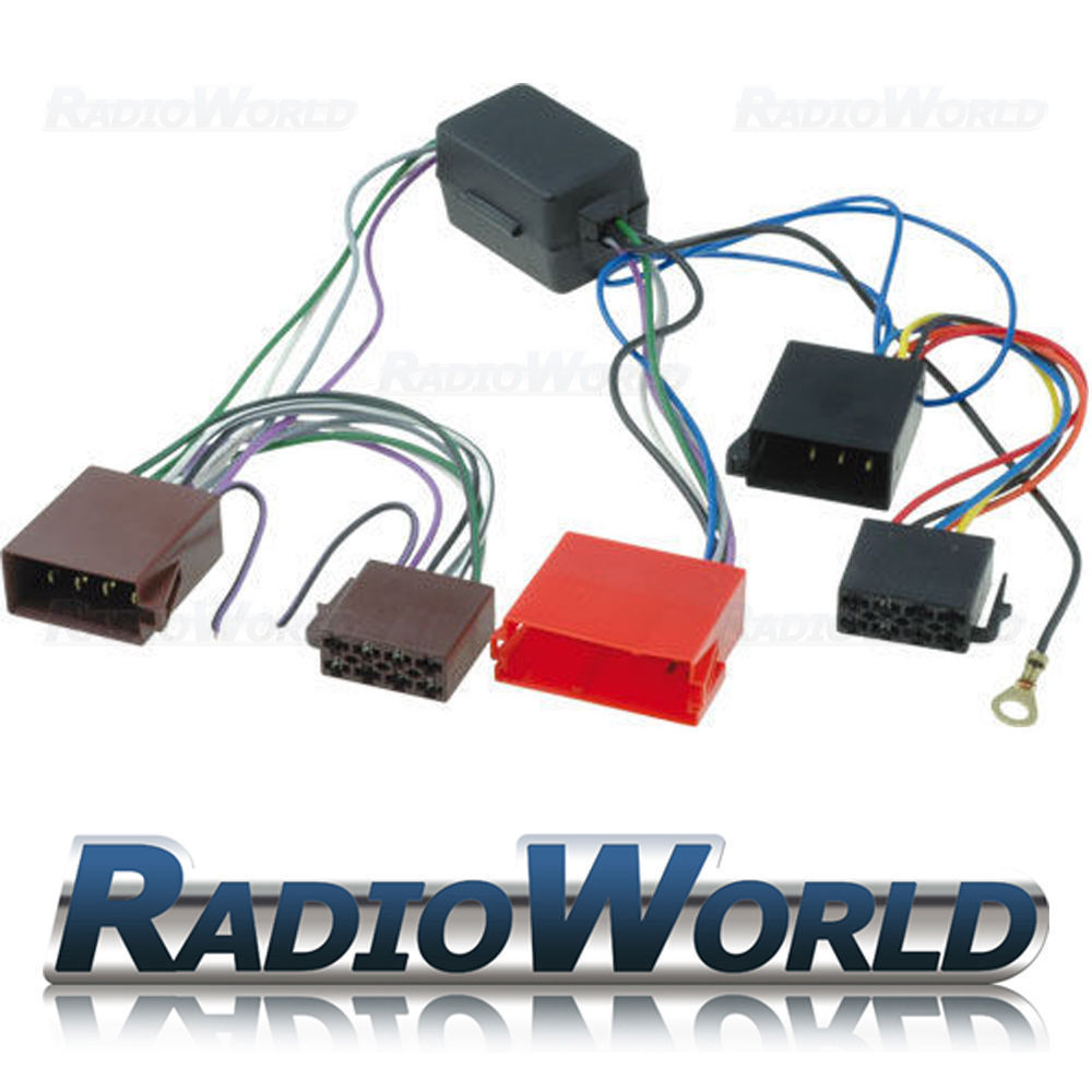

    The car has a BOSE speaker system and I bought an adapter without which, apparently, nothing will work.

    From the car's installation, you plug in 3 plugs into 3 adapter sockets. And the adapter plugs have 2 outputs. You either cut them off and earn money with cables from the radio, or you install sockets on the cables from the radio, which you can buy in any electronic store. You have a schedule, so you should be able to do it.

    Ok gentlemen, I think I understand what's going on. For clarity, I attach an additional photo. I connected what could be connected with plugs. Otherwise, you can not do anything because only the plugs that are connected now fit into the sockets. Nothing else fits together.
    Installing Aftermarket 1DIN Radio in Audi TT MK1 with BOSE Speaker System
    So the plug marked in the photo as No. 1 (red) was not connected to anything at the time when the factory radio was in the car. Only black plugs 2 and 3 were connected to the radio (except for the mass and the antenna too). The only sockets that fit the plugs 2 and 3 are the sockets in the adapters, which I marked in the picture 4 and 5. As you can see, one socket in the adapters is black (4) the other red (5). I do not know what this means, but both car plugs are black (2 and 3).
    The plug No. 1 does not fit the socket No. 5, although the color and size would indicate it, because the rail on the side of the plug is in a different place than in the socket (in the plug it is closer to one edge, in the socket in the middle).

    So unclear is that this:
    it doesn't look like this:
    To be sure, give photos of plugs in the car, this adapter and what you have on the radio.

    From what I am looking at the video, you plug in the socket adapter so that:
    Adapter -> Auto
    Black socket (power supply) -> Black plug
    Brown (looks red here, audio) -> Brown plug (looks red here too)
    Wide socket (changer) -> Wide plug
    And there should be 2 plugs that should be plugged into the radio. If something does not match, then maybe something with this adapter would have to be wrong. And on the radio cable, I would earn 2 purchased ISO sockets so as not to cut the adapter.

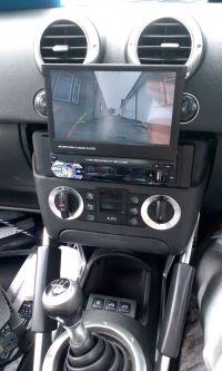

    Thanks again, buddy. I connected everything just to see if it works and it is ok. Even the reversing camera was successfully connected to the reverse gear light. Now I have to route the cables nicely through the car and terminate the connections :spoko:

    Thank you all for help, final photo below!

    Radio and camera mounted according to the posts on this thread.
