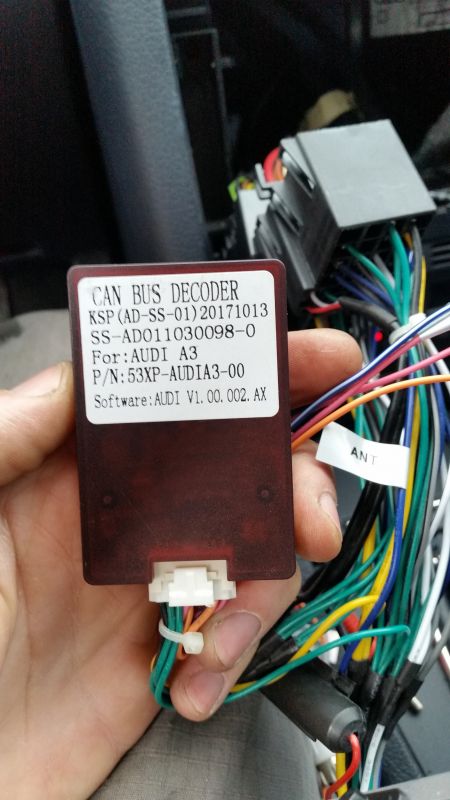

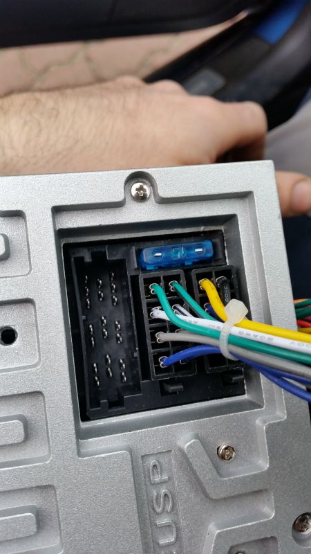

    Radio with navi Audi a4 b7. Replaced for new on Android, a problem well known in the form of non-working rear speakers. I was looking for ISO cables to run the rear speakers but there are a lot of them and I do not know what to choose. I was looking for Natcar audio. I add a few pictures of how the connectors in the car and radio look.
    If someone had a similar problem, please advise which adapter to choose.

    On the radio, the output to the rear speakers is on the marked pins.
    There is no wires in the car's ISO plug.
    The rear speakers have their own amplifiers (BOSE). And the signal comes to them
    from the green plug.

    This is not BOSE. This is the sub version at the back. The equivalent of "green" cubes are chinches, connecting them to the radio, unfortunately, nothing plays ... Is the appropriate module needed for this? if so, which ...?

    Does the sub back know he is supposed to play?
    I get a radio signal about turning on?
  • #5 16944939
    konrad2k9
    Posts: 105
    Help: 5
    Rate: 45
    I didn't check it, how do I check it the fastest? If the CAN adapter has the inscription "FOR AUDI A3" and this is audi a4 b7, then there may be a whole reason?

    Did you manage to solve the problem? I have the same one, namely Android radio with Ali and the rear speakers do not work. However, the amplifier receives a signal because it is turned on, only a slight noise can be heard in the speakers, nothing else.
