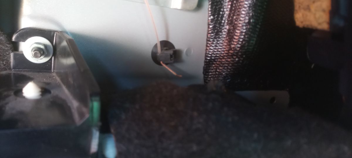

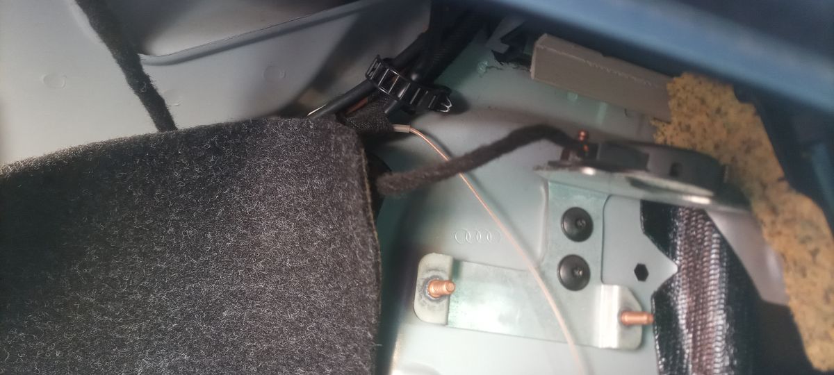

    Hello, it's me again, the radio is plugged in, but I have another problem. I played around and tried to connect without adapter, rear + sub speakers. However, the effect is that only the front + subwoofer works, the rear is not. I soldered the chinche as it was given earlier, but the back does not sound. Any ideas? Add photos.
    Regards.

    You have to squeeze the bottom and top plates of the radio, then you should get all of it.
