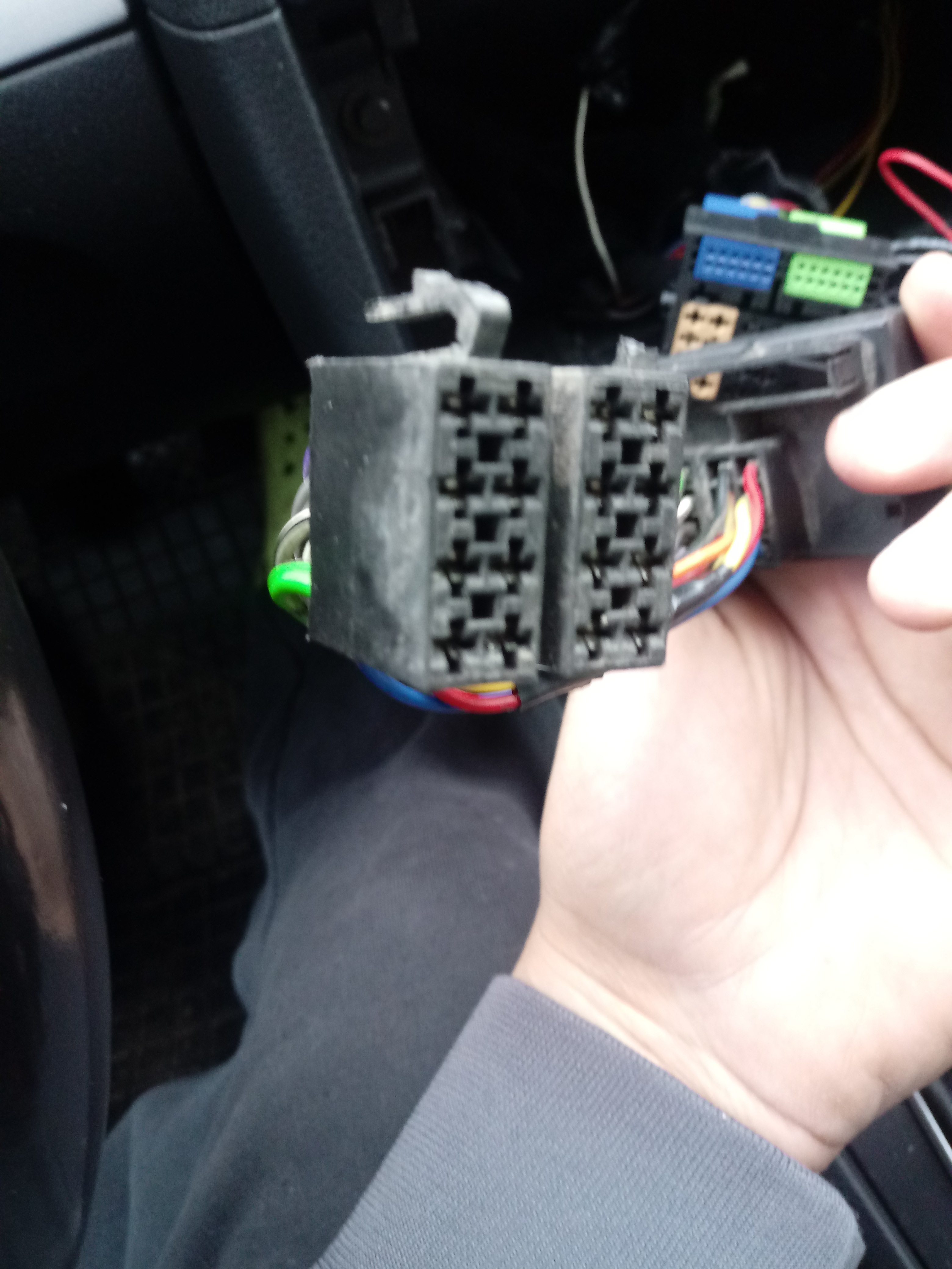

    Then some cube crossing:

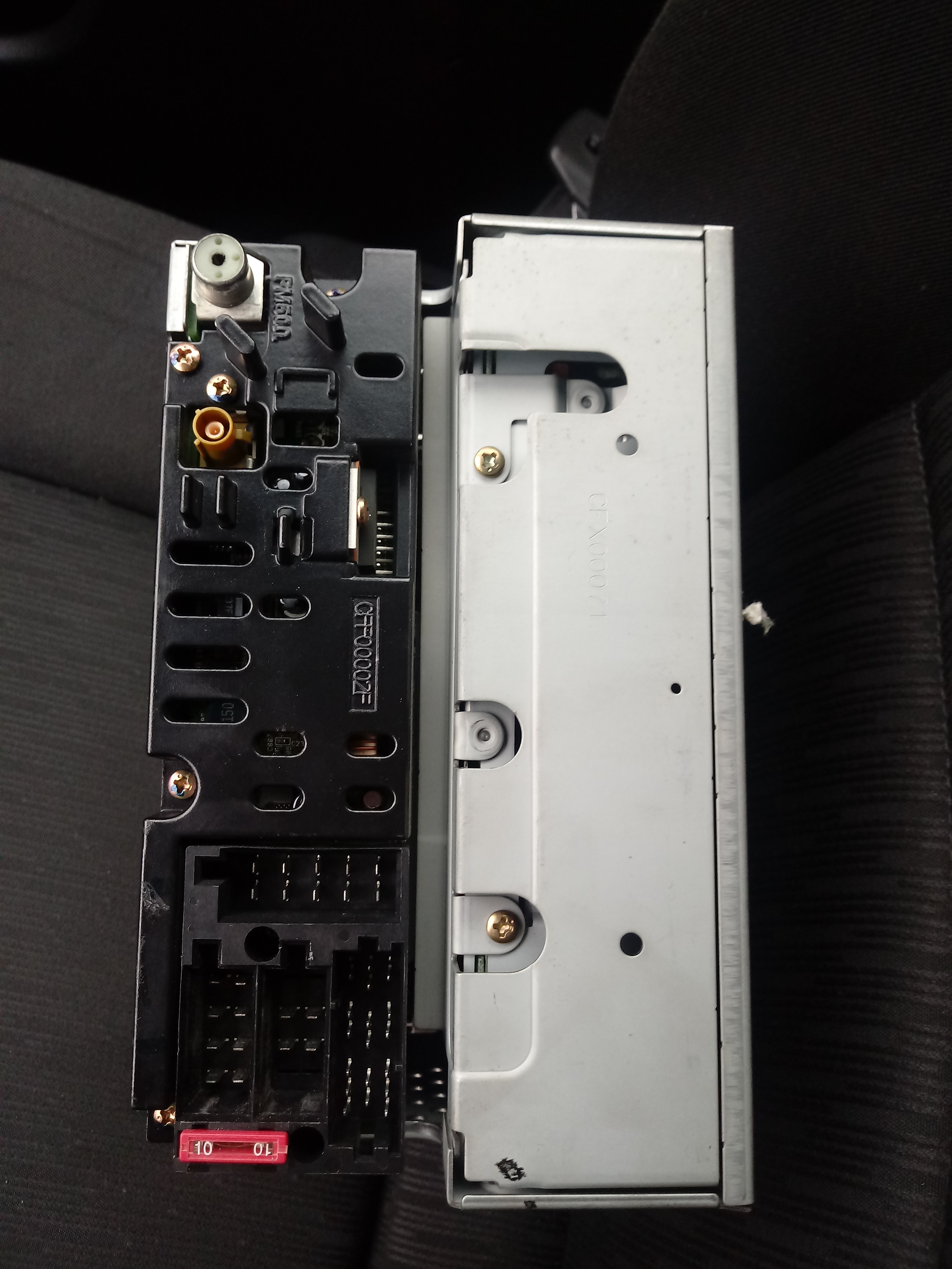

    And the radio itself:
    Connection of factory radio audi a4 b7 avant subwoofer and speakers
    What should I do to change it to make it all play

    Insert cubes and write what and how they work.

    the radio only fits this
    from what is going on, it powers the radio and only the front speakers are played

    Apparently you have an inappropriate radio, check what's supposed to be there after vin.
    Because it's like the radio was from b6.

    It's not bad, you do not have a cut installation ;-) If on this radio what you have now do NOT work on your rear speakers it is already quite well, i.e. there is a chance that no one has fumbled in the installation in the doorways and the wheelills. Watch the double antenna fakra connector, after its layout I think you should have radio concert III on board (or rns, mmi, check the presence of modules in the rear left wheel arch, closed compartment, and the knife fork is a changer, tv tuner or dab .. it is not known). The connector should not have any protruding cables (it is suggested by a photo and a red cable that looks like a connector connected to it).
    Just like a colleague wrote the check in the equipment codes what the radio was in the original (three digital codes, the back plate is in the spare wheel compartment and of course in the service book eventually get information after vin), purchase appropriate and sell it (the best and the cheapest solution).

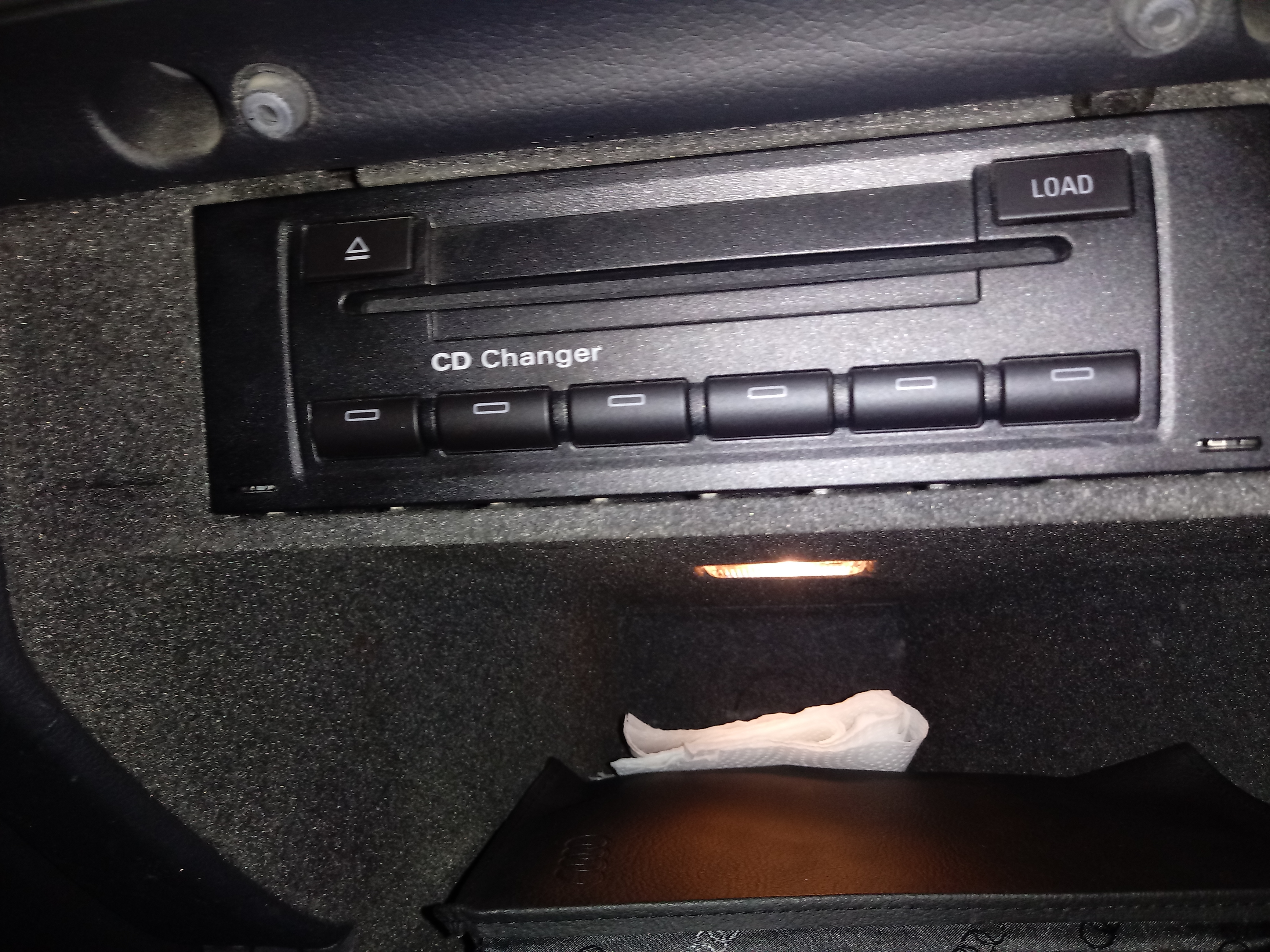

    there is a changer in the clipboard
    and in the boot on the right, such a thing in the bacon

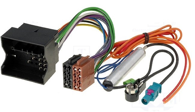

    And without changing the radio you can buy such cubes or adapters

    Search for fakra - iso audi but full fakra - iso + antenna reduction.
    You have a symphony radio can approach it.

    If you want to leave this radio stubbornly, then you need an adapter between those marked in red. It does not guarantee that the changer in the glove compartment, the possible steering wheel control and the correct radio antenna will work, but the active subwoofer + so many speakers should start playing.
    In your place I would look for a concert radio ii + (concert 3 iso2 2din).

    I wanted to go back to the subject for the last time I could not sit down, my radio has a built-in changer, let's get in the clipboard, I'm not interested, just tell me if I can connect my radio to those bones in the car if you give it I give you tips
    I have something where I need to plug the control of the amplifier and the speakers back

    No, you already have one. You need a full one that will be supplemented with these free 2 rectangles with a blue and green car and one that will adopt these rectangles for another connector made of three parts, yellow, blue and green from what I remember. In addition, you will probably need to additionally modify it as in the links that I posted because half of the things will not work. You can do it and it's the same car, but it's sometimes a road through torment. Really, believe me, if you do not have a clue about it, it will be faster and several times easier to get rid of this radio and buy the right one.
