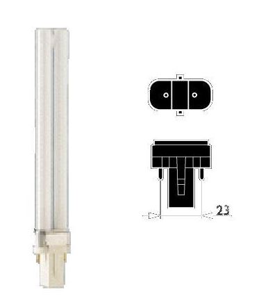

    The lamp looks like (photo); it has 2 electrodes, it has 4, electrodes like a classic fluorescent lamp
  • #3 16533403
    Noostro
    Posts: 11
    I understand that this is about this information:
    G23 base
    2-pin cap information
    2xT12 bubble
    As requested, adds a photo of the bulb  Choosing the Right Power Supply for 6-7 UV 9W Lamps with 15-min Continuous Operation

    It is a classic fluorescent lamp with an integrated ignitor. You only need a choke. Of course, the right layout.

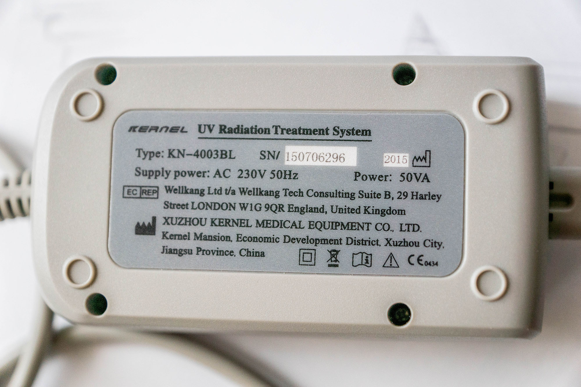

    Show a photo of this power supply.

    This is a PL 9W lamp (not a bulb). Lamps of this type are made in two versions - for an inductive ballast (with a starter in the cap) and for an electronic ballast (no starter in the cap, instead of a capacitor).

    This is exactly what the power supply looks like. It took a while to answer because I had to take a photo :)
    And is the lamp connected directly to it? I do not believe something, and I especially believe in these 50W (probably something else in this device is powered)

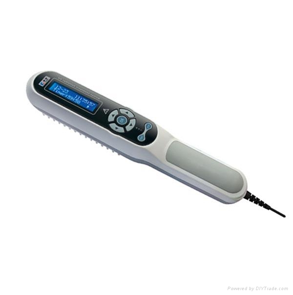

    The device itself, into which this fluorescent lamp is inserted and connected to this power supply, looks exactly like this:
     Choosing the Right Power Supply for 6-7 UV 9W Lamps with 15-min Continuous Operation  Choosing the Right Power Supply for 6-7 UV 9W Lamps with 15-min Continuous Operation
    Apart from a small display whose only function is to measure the time to the end of operation, nothing else is powered there. The manufacturer recommends a one-time operation not longer than 20 minutes due to the possibility of burning the power supply and it is actually hot after 15-20 minutes. Not warm, hot.
    Unfortunately, I do not have any additional data about the power supply, apart from the sticker on it, the photo of which I have inserted. And now I do not know if this lamp (fluorescent) is extremely demanding or if the power supply is really bloody weak.
