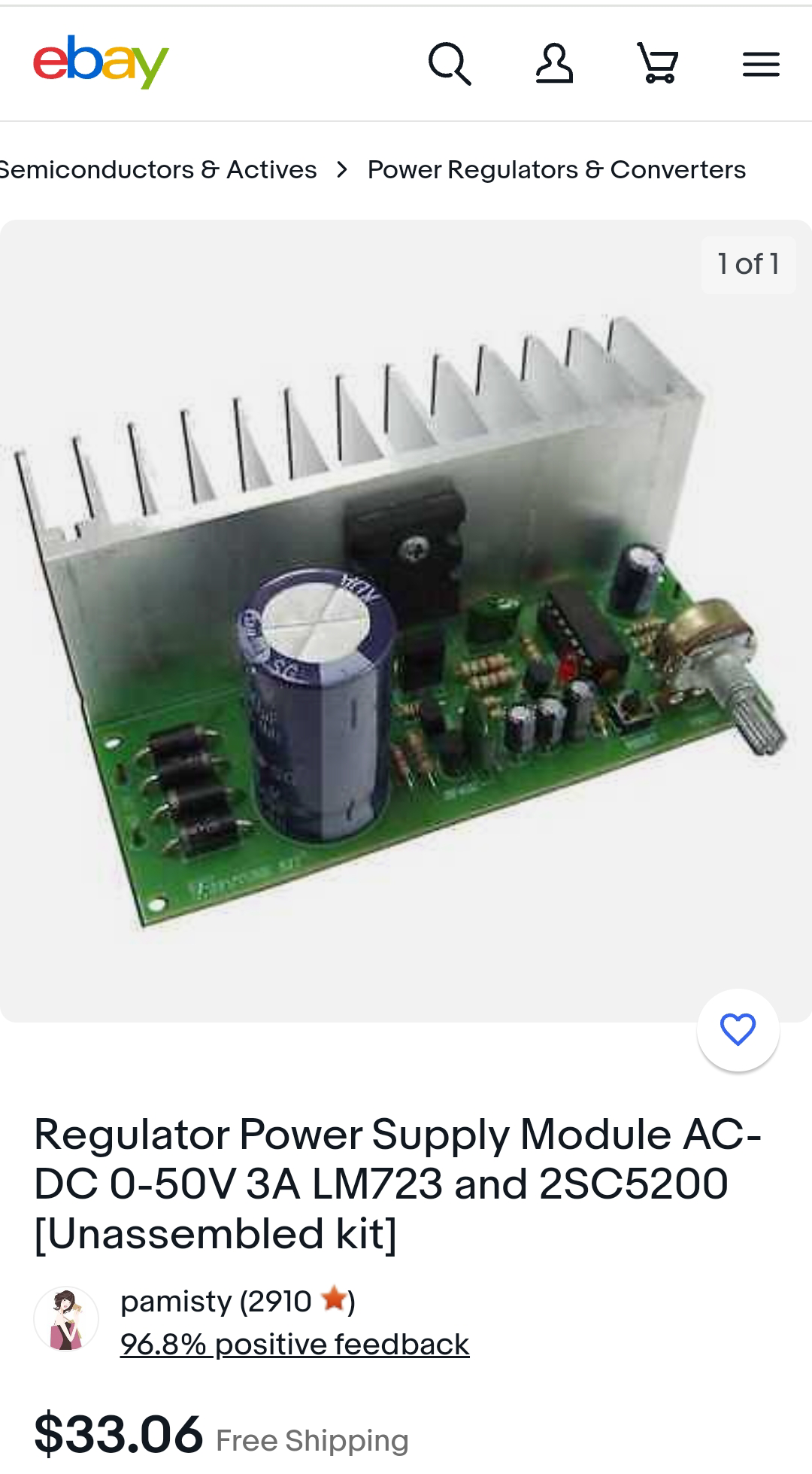

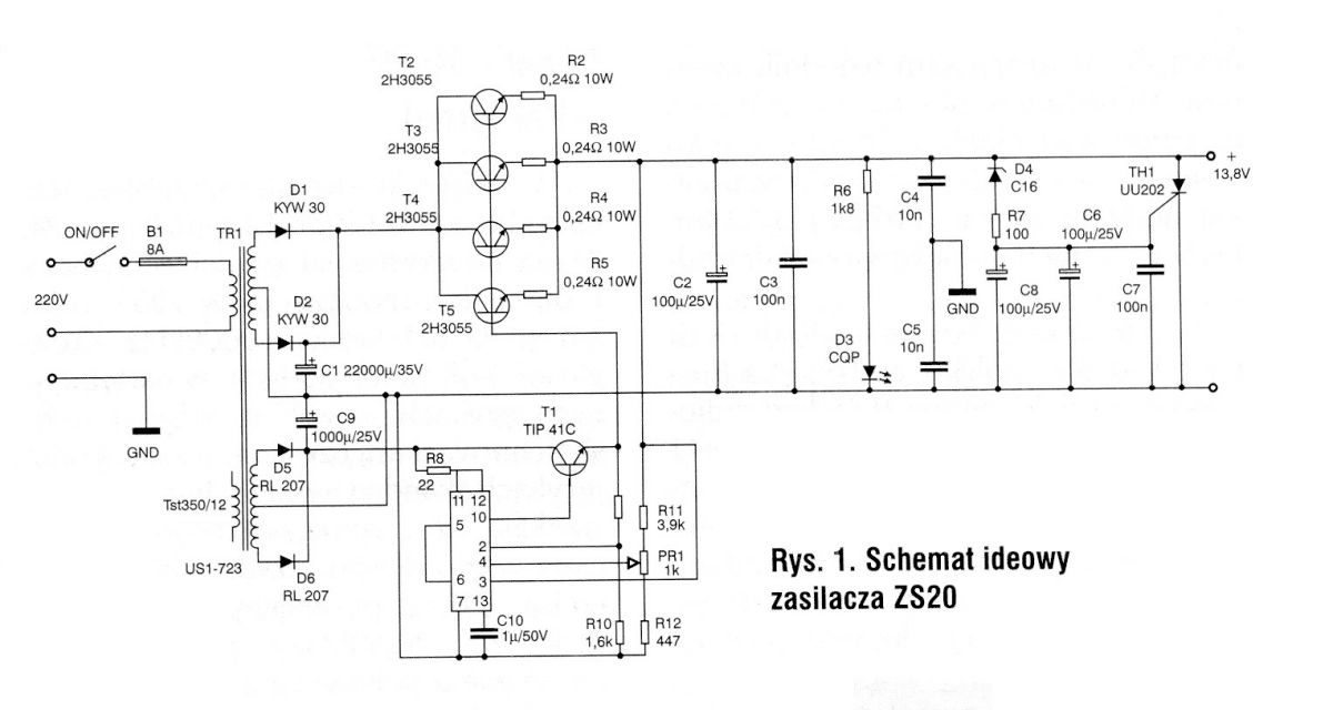

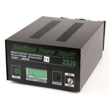

    If you want to do it your way, a very good material for a home-made high-power laboratory power supply at the moment is the ZS-20 power supply available as new in ham radio shops, or sometimes as a second-hand one on allegro. All you need to do is to bring out multi-turn potentiometers on the panel (or ordinary ones with a range switch) and possibly draw a voltage scale or insert a separate voltmeter. In the original, you will get a control range of 0-16V/0-22A max (tray power 350W), or by replacing both single-voltage rectifiers with gretzos you will get 0-32V/0-11A max. There are also ready-to-use 723 modules-boards, but they are only available on eBay. There used to be such modules still on allegro. At one time, the 723 power packs were very reliable and popular in industrial automation, often in TP S.A. switchboards, for example, and also widely described in various variants in books. Unfortunately, I must admit that now, apart from the ZS and a module from ebay, only a memory remains of them, because the 723 is an excellent chip.
    Schematic of the ZS-20
    (thyristor optional - throws a fuse in case of an overvoltage)
    Choice of 30V, 10A laboratory power supply up to 300PLN - request for recommendations .
    Module available on eBay

    Mr. Counter! @Hektar-Zahler This power supply for CB radios :D comes with a 16 volt crowbar! When changing the rectifier to a Greatz bridge this circuit must be removed!
  • Raise D4 zener voltage to match range
    #16 19995213
    Hektar Zahle.r
    Level 30  
    Posts: 1354
    Help: 144
    Rate: 266
    Remove, or Replace, the D4 zener to a voltage a few volts higher than the maximum range of the adjustment you have made and it will be, say, 18V for the 0-16V range, or 34V for the 0-32V range.
