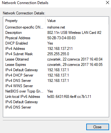

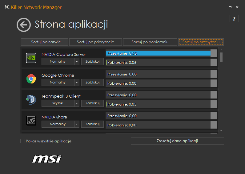

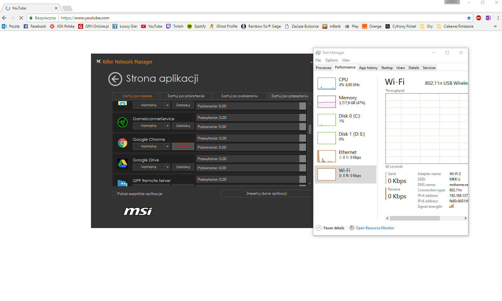

    OK, I will write everything because maybe I am doing something wrong. So:
    Connecting to Two Networks Simultaneously: i7-4790k, 8GB RAM, GTX970, Windows 10 Pro, LTE Internet - you can see the folder and administrator permissions (I tried both 32 and 64 bit versions)
    Connecting to Two Networks Simultaneously: i7-4790k, 8GB RAM, GTX970, Windows 10 Pro, LTE Internet here is LTE cousin internet (the gateway to which I want to redirect the application)
    Connecting to Two Networks Simultaneously: i7-4790k, 8GB RAM, GTX970, Windows 10 Pro, LTE Internet - based on this program, I determined to my network card which geforce experience application sends the image to YT. It is clear that the upload speed is high (sorting from the highest).
    And here is the code for the BAT file in ForceBindIP
    ForceBindIP -i 192.168.137.1 "C: \ Program Files \ NVIDIA Corporation \ ShadowPlay \ nvspcaps64.exe"
    After running the bat file, nothing changes and the network controller (LAN) continues to record data transmission (application: is it not working?). Even after restarting the application and stream.
    Maybe I'm doing something wrong? I am waiting for any corrections / suggestions

    bogiebog wrote:
    To test instead of nvspcaps64.exe use firefox.exe and check if it works.
    I don't use firefox only chroma, but I think it doesn't make much difference. Unfortunately it does not work. Even to be sure, I blocked it in a network (LAN). You can see that the wifi will not vibrate. Connecting to Two Networks Simultaneously: i7-4790k, 8GB RAM, GTX970, Windows 10 Pro, LTE Internet
    I also turned off BItDefender and all firewalls (bitdefender + windows) to be sure - it did nothing.
    you have to give the computer IP to forcebindip, not the ip router.

    bogiebog wrote:
    Wrathtide wrote:
    And not the gateway (router) through which the application is to connect?
    Yeah, until you theoretically understand it, you are not free to try other ip addresses, no one knows what will happen to your computer.
    For theoretical considerations, I refer to the author's website.
    To be sure I tried on chrome - also without results on my computer's ip, i.e. 192.168.137.211
