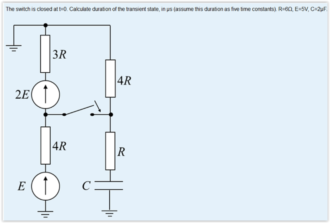

Solving Circuit Theory Transient Analysis Task - Expert Input Needed (Image Attached)

    Can anybody solve it? Solving Circuit Theory Transient Analysis Task - Expert Input Needed (Image Attached)

    Hi
    Starting Condition Uc=0
    Final Condition : Uc=ELP
    Internal resistance for Transient after switch closure : Ri=(4R//4R//3R) R
    Loop Current left = 3E/7R before closing the switch
    Left Potential at switch = E- 4R*3E/7R = E(1-12/7) =ELP before closing the switch
    Potential at closed switch
    i1 left top i2 right top i3 left bottom i4 (C)=0
    final i4=0
    i1,-i2 = -2E/7R
    u1=4R*-2E/7R
    i3, -i2
    u2= E/2
    ELP =u1 u2
    Current = ELP / Ri * -exp (-t/(TAU)) where TAU = C*Ri
    It was a pleasure thanks to Kirchhoff
