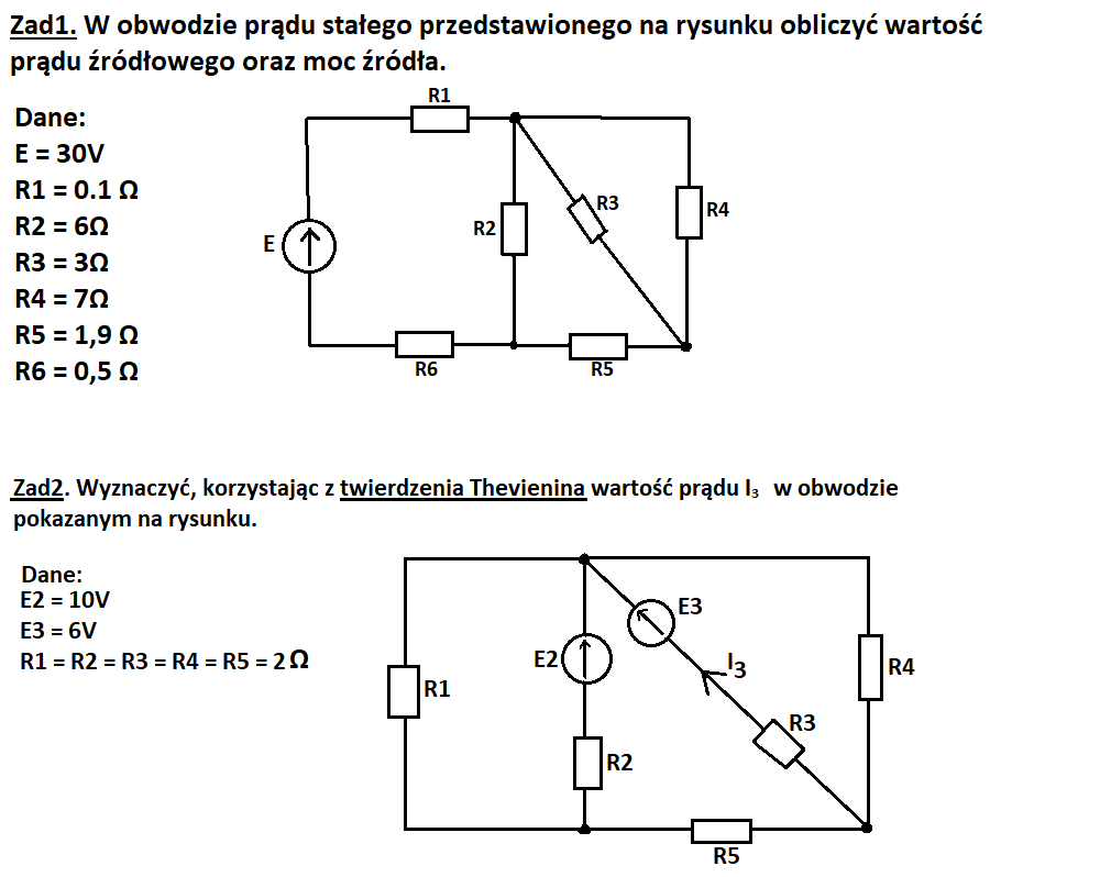

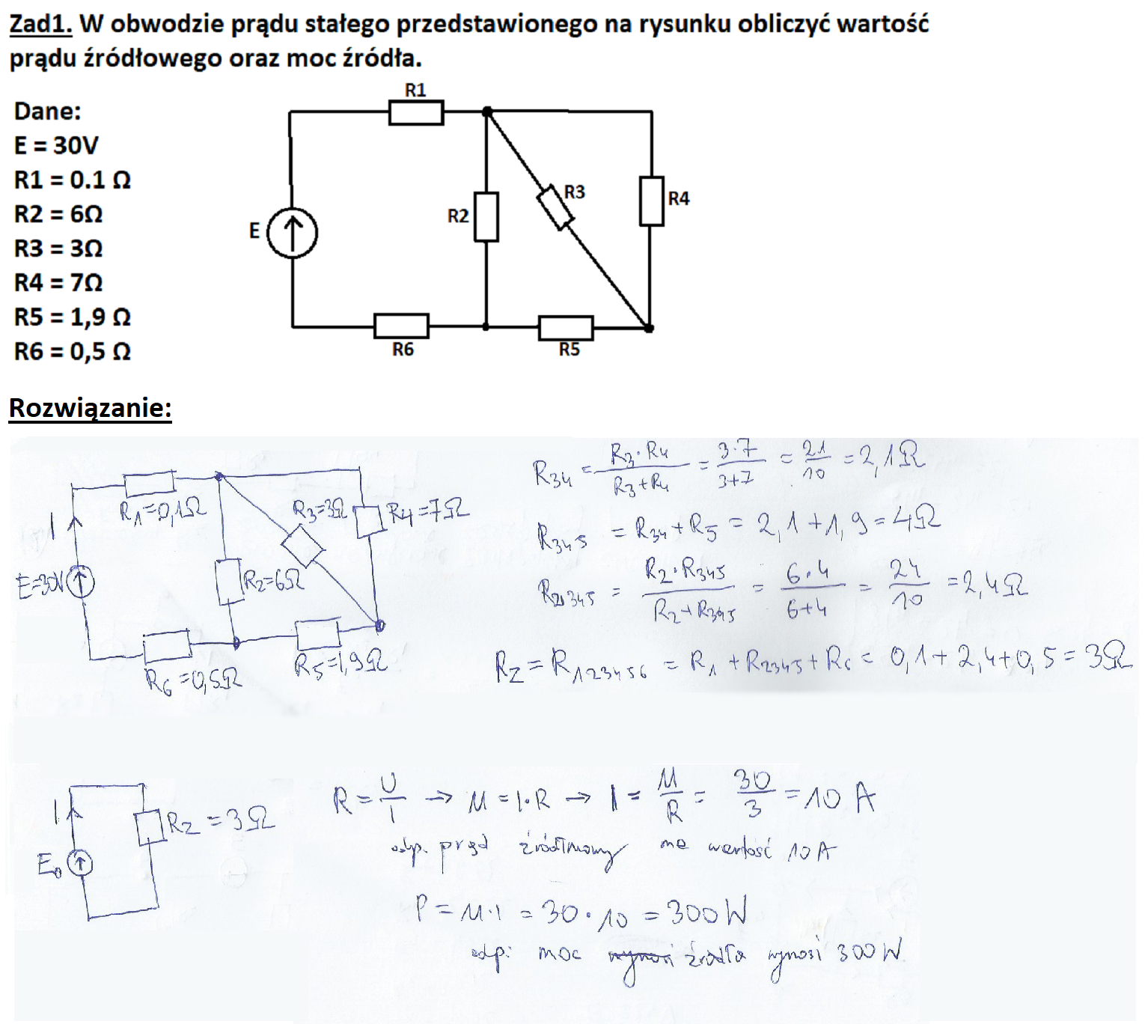

How do I determine the source-branch current and use Thevenin’s theorem to find the no-load voltage and branch current in this circuit?
For task 1, the source current is just the current through the source branch, and the correct value is 10 A; Thevenin’s theorem is not needed there [#16898183] For task 2, cut the branch with the 6 V source, find the equivalent resistance seen from terminals A–B as 6/5 Ω, and then solve the reduced circuit with the remaining 10 V source [#16906525][#16901995] After that, calculate the open-circuit voltage at the cut terminals from the reduced circuit, taking care with the voltage polarity because the directions do not simply add [#16904836][#16908741][#16908856] With the correct Thevenin voltage, the final result is I3 = 1.25 A [#16908926]

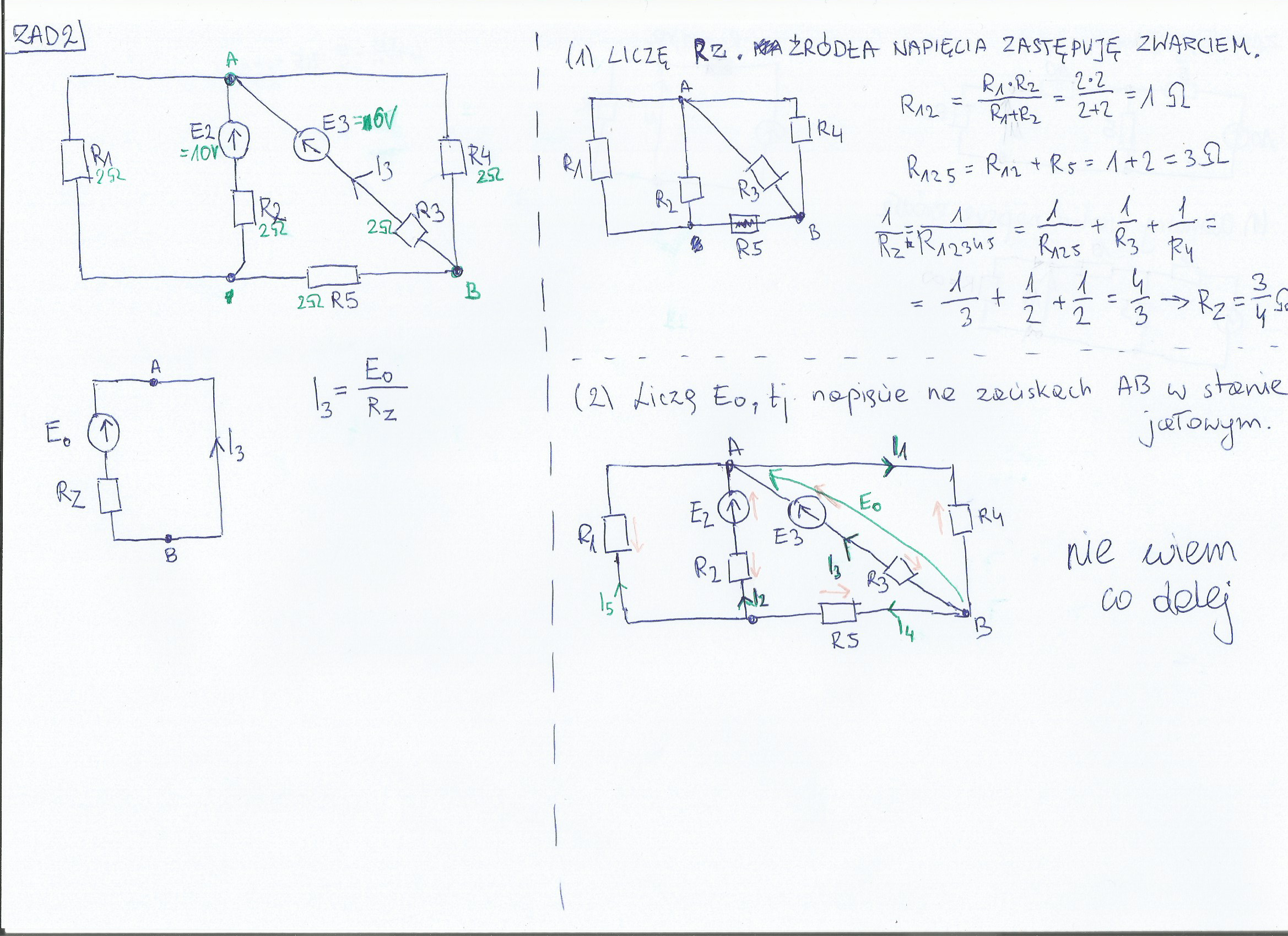

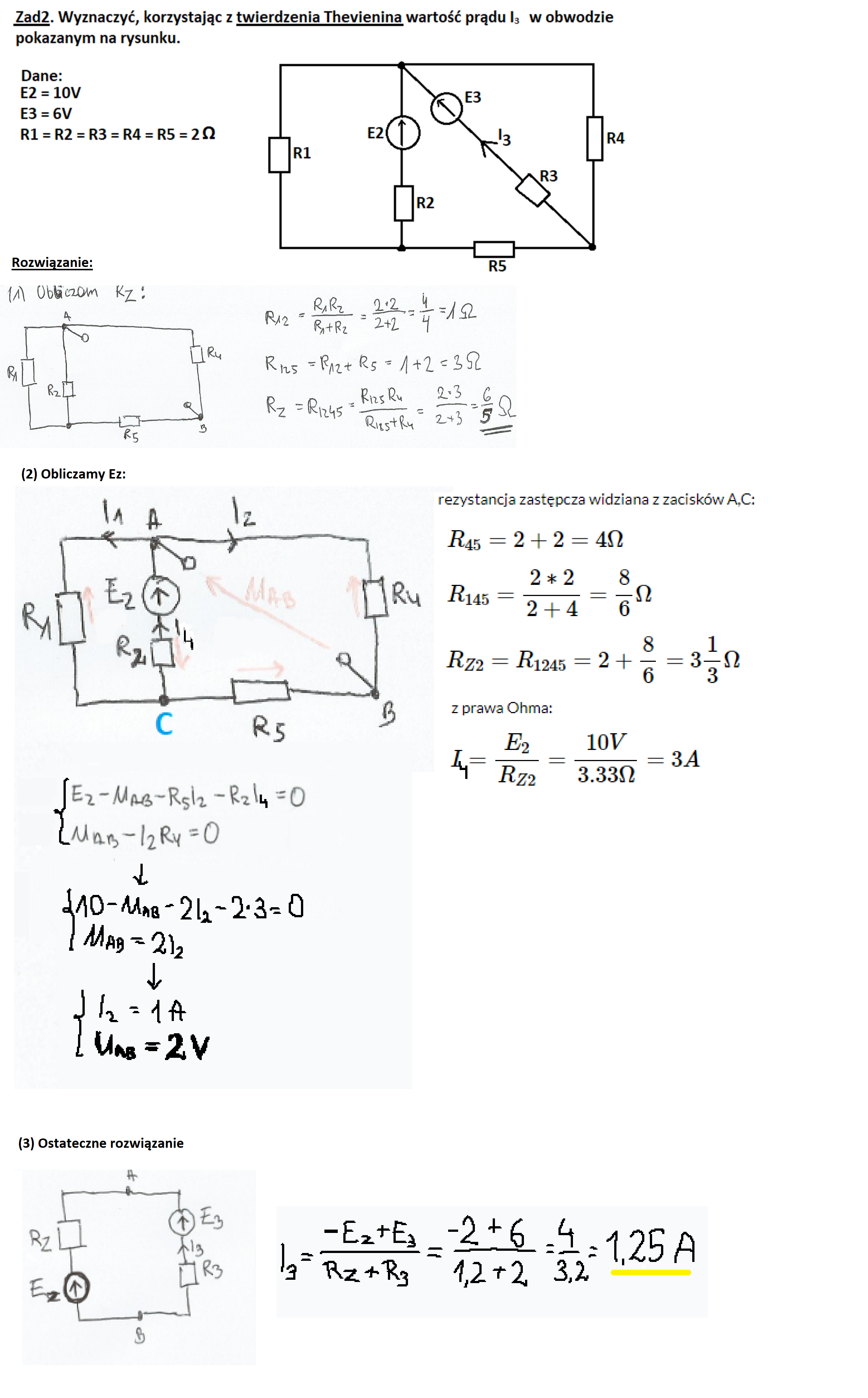

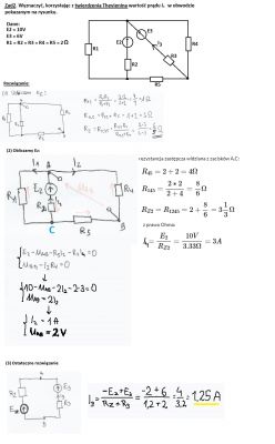

    Thevenin's theorem is that you "cut" the branch in which you want to count something (in this case I3 current).
    From the point of view of this cut branch, you count the resistance for shorted voltage sources in the remaining circuit "after cutting" (in this case, one will remain ...).
    Then you calculate the voltage at the terminals from which you cut the branch (i.e. the voltage drop from the only source - on the resistance R4). So "we roll the circuit and develop."
    Having the voltage on the terminals, the replacement resistance, you substitute it as a new system with series connected: voltage source and resistance that you have just calculated.
    You now "add" a cut branch to their terminals and you have a simple circuit with a source voltage difference and two resistances.

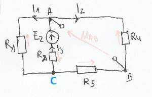

    You have calculated the replacement resistance,
    Now it's time to count the voltage in this system.

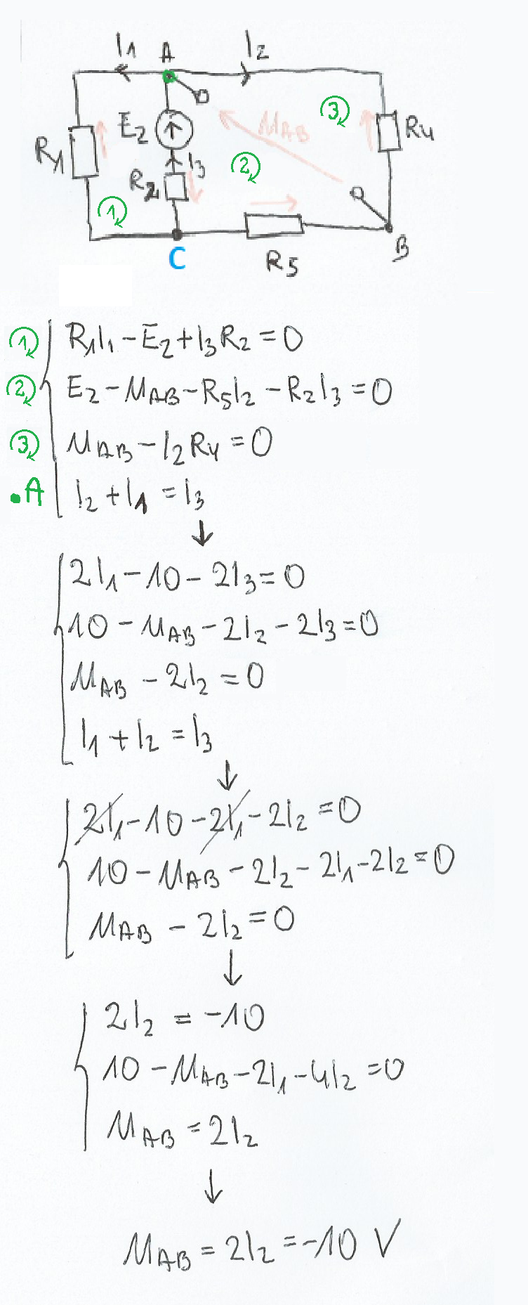

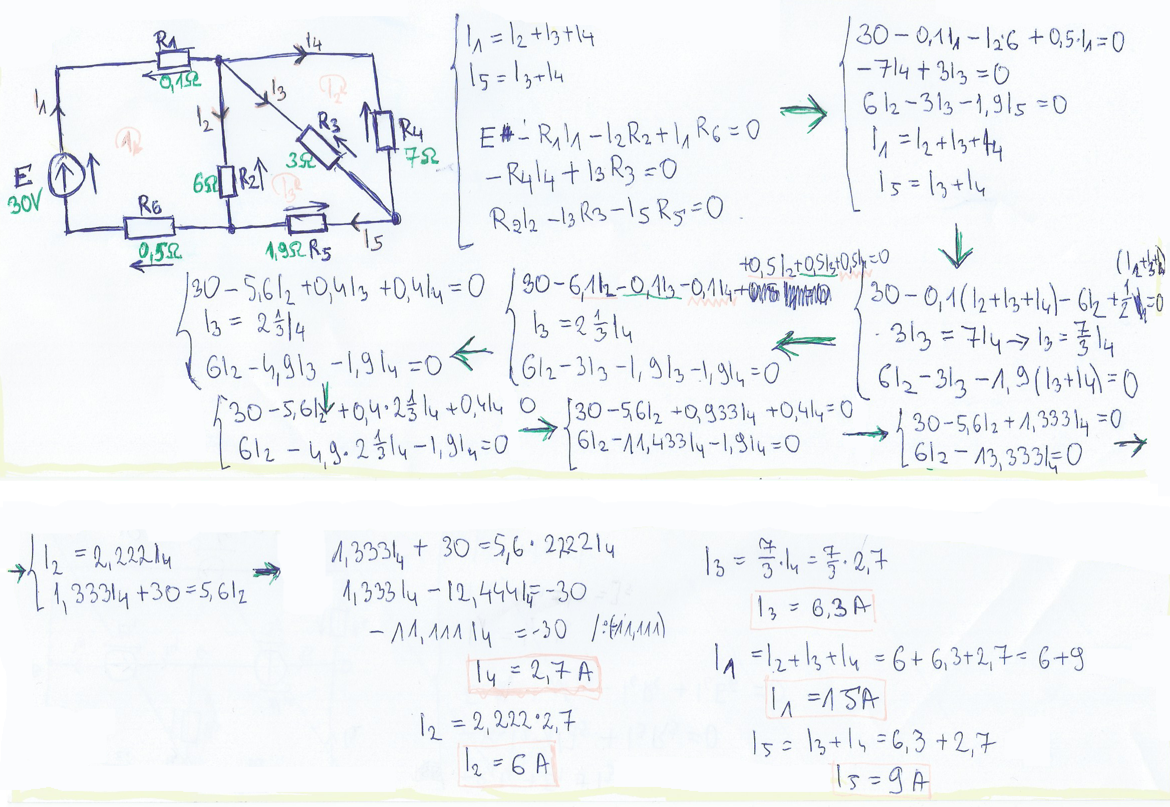

    Erwin14 wrote:
    is it best to count and paste it here?
    With all due respect, but you must be kidding. Should I write the exam for you?
    I do not understand what you have a problem with when counting currents and voltages from one source.
    Since you only have E2, you add the resistances R4 and R5, then connect them in parallel with R1, and then in series with R2. Then pure oma law, and again we develop the circuit to find currents I1 and I2 (although here instead of currents, you immediately have the voltage on the corresponding elements).

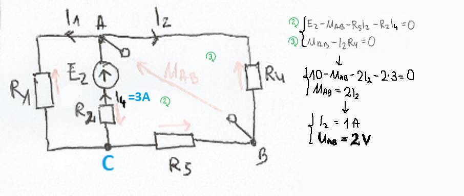

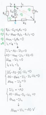

    Erwin14 wrote:
    Is this the current I3 and the end of the task?
    No and no.
    So far, we have not yet come to the use of Thevenin's Theorem to the end.
    Now count the I2 current in your configuration. Multiply it by the resistance R4 and you have a voltage drop on the element that interests us (i.e. you are able to calculate the Uab voltage).
    Having the Uab voltage, having a substitute resistance, you have to make a substitute circuit to which you attach the previously cut branch, here:
    Circuit Theory: Clarifying Source Power & Calculating No-Load Voltage with Thevenin's Theorem
    This shows that it's bad You have marked current I3 at the moment.

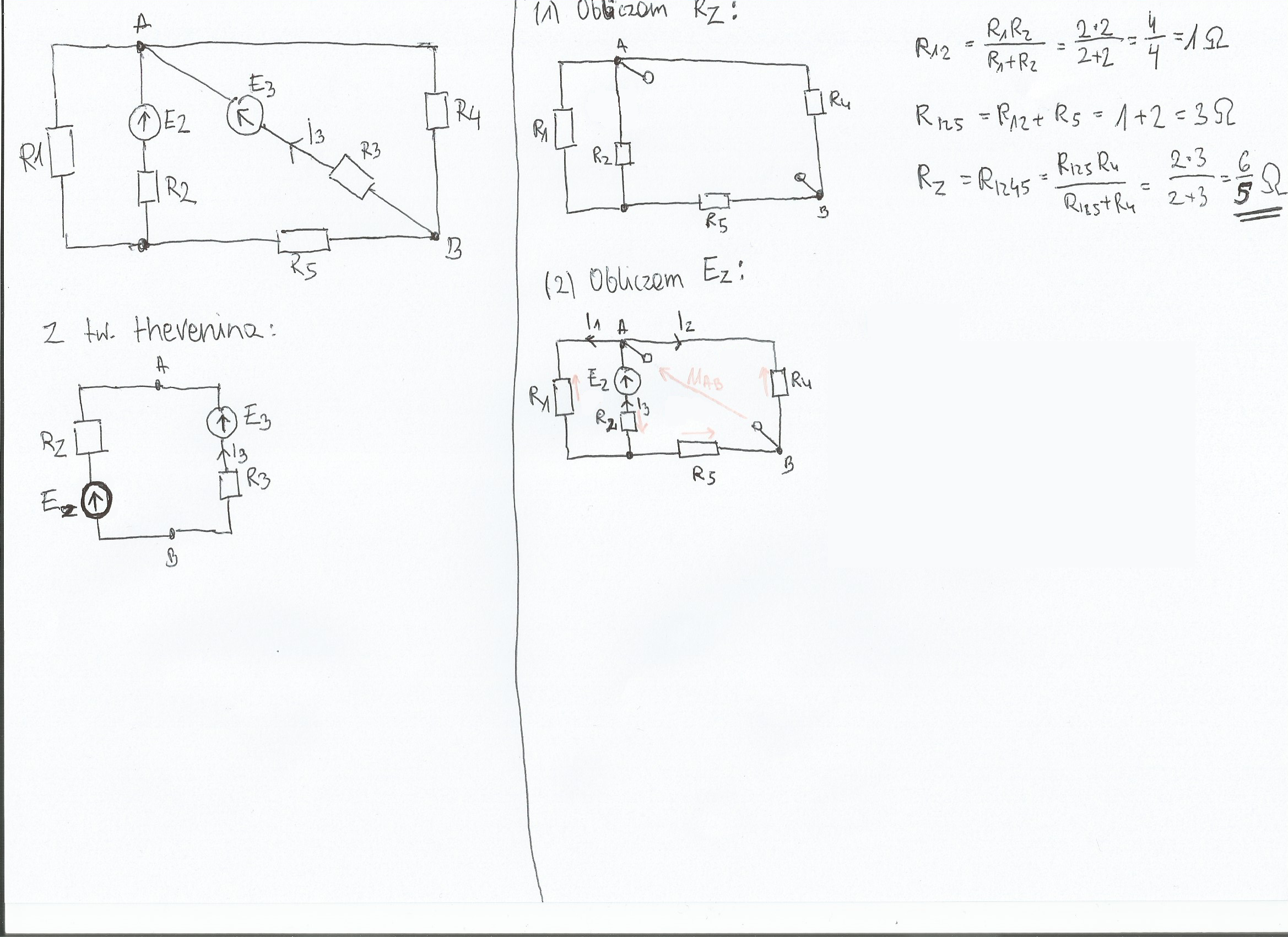

    Unfortunately .... it's not good. The equivalent resistance seen from the viewpoint of terminals A and B is 6/5 ohms. As you stated in post # 5.
    In post # 9 is good. Because in post 9 you count the "second" system, with the 6V source cut out.
    You have calculated a replacement circuit with a 10V source (where the 3A source current comes out). You just need to develop it to know the voltage drop at the extreme right resistance:
    If you know this voltage drop, this voltage drop is your substitute voltage in the Thevenin system.
    Only after that you create another layout to count, the one from post number # 10.
    PS
    In the circuit from post # 9 you have the error that you marked the current I3 as a current in the branch with a 10V source. Only that in the task, the current I3 (the correct one to count) is the current in the cut branch with a 6V source. From here you can get "mixed up".

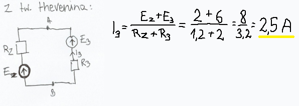

    Near!
    Just look at the direction of tensions ... they won't add up.
  • #15 16908889

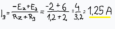

  • #16 16908926
    kozi966
    Posts: 6922
    Help: 599
    Rate: 1288
    That's right

The forum clarified they wanted the source current, not power. Compute source power later as P = U × I if needed. In Task 1, the accepted result is 10 A and Thevenin is unnecessary. “And the source current is the source current.” [Elektroda, Anonymous, post #16898183]
How do I get the source current in Task 1 quickly?
Use Ohm’s law directly on the given source and its connected resistance. Thevenin reduction is not required here. The checked answer in the thread is 10 A for Task 1, matching a direct calculation approach. [Elektroda, Anonymous, post #16898183]
