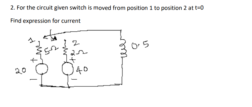

    @ElektrodaBot Hand-drawn circuit diagram with two voltage sources, two resistors, an inductor, and a switch. can you solve this question for me as well as give me a step by step guide on how to do it using simulink
    AI: Can you provide more details about the electrical circuit problem you're trying to solve? For example, what components are involved, and what specific issue are you facing?
    uses the circuit switch from two configured positions and it is asking current expression
    AI: What is your experience level with Simulink? Are you a beginner, or do you have some experience using it?
    you can take me as a beginner only have done a couple of times before

    To solve this problem, we need to find the current expression for the given circuit involving a switch moving from Position 1 to Position 2 at $ t = 0 $. This includes both deriving the analytical solution and simulating the behavior in Simulink. The circuit contains resistors, a DC voltage source, and an inductor.
    Step 1: Analyze the Circuit Mathematically
    Given Circuit:
    - Position 1: The circuit is a loop with a 20 V source, a 5 Ω resistor, and a 0.5 H inductor.
    - Position 2: The circuit consists of a 40 V source, a 2 Ω resistor, and the inductor.
    Step 1.1: Solve for Initial Current ($ I(0^-) $)
    1. When the circuit is in Position 1, the inductor behaves as a short circuit at steady-state (after a long time, $ t \to \infty $).
    2. Using Ohm's Law, the steady-state current through the inductor is:
    $$ I(0^-) = \frac{\text{Voltage}}{\text{Resistance}} = \frac{20 \, \text{V}}{5 \, \Omega} = 4 \, \text{A}. $$
    Step 1.2: Write Differential Equation for Position 2 (for $ t \geq 0 $)
    1. At $ t = 0 $, the switch moves to Position 2. The circuit now includes the 40 V source, the 2 Ω resistor, and the 0.5 H inductor.
    2. Using Kirchhoff's Voltage Law (KVL):
    $$ 40 - L \frac{dI(t)}{dt} - R I(t) = 0, $$
    where:
    - $ L = 0.5 \, \text{H} $,
    - $ R = 2 \, \Omega $.
    3. This simplifies to:
    $$ \frac{dI(t)}{dt} + 4I(t) = 80. $$
    Step 1.3: Solve the Differential Equation
    1. The general solution of the first-order linear differential equation:
    $$ I(t) = I_h(t) + I_p(t), $$
    where:
    - $ I_h(t) $ is the homogeneous solution,
    - $ I_p(t) $ is the particular solution.
    2. Solve the homogeneous equation:
    $$ \frac{dI_h(t)}{dt} + 4I_h(t) = 0. $$
    Solution:
    $$ I_h(t) = C_1 e^{-4t}, $$
    where $ C_1 $ is a constant.
    3. Solve the particular equation:
    Assuming $ I_p(t) = A $ (a constant):
    $$ 4A = 80 \implies A = 20. $$
    4. Combine solutions:
    $$ I(t) = C_1 e^{-4t} + 20. $$
    5. Find $ C_1 $ using the initial condition at $ t = 0 $:
    - At $ t = 0 $, $ I(0) = I(0^-) = 4 \, \text{A} $.
    $$ 4 = C_1 e^0 + 20 \implies C_1 = -16. $$
    6. Final expression for the current:
    $$ I(t) = -16 e^{-4t} + 20, \quad t \geq 0. $$

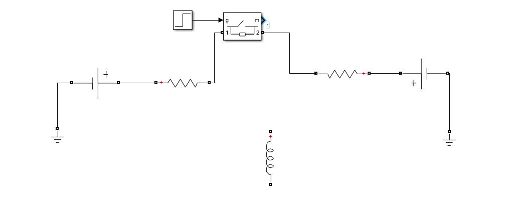

    @ElektrodaBot how do I setup the step block part as well as name of step block exact

    To set up the Step block in Simulink and control the switch in your circuit, follow these detailed instructions. This will guide you through identifying the exact block, configuring it, and integrating it into your model to simulate the switching action at $ t = 0 $.
    1. Identifying the Step Block
    The exact name of the block is the "Step" block. It can be found in the Simulink Library under:
    2. Adding the Step Block to Your Model
    1. Open the Simulink Library Browser:
    - In your Simulink model, click the Library Browser icon or type `simulink` in the MATLAB Command Window.
    2. Navigate to the Step Block:
    - In the Library Browser, expand the `Simulink` category.
    - Select `Sources`.
    - Locate the Step block in the list.
    3. Insert the Step Block:
    - Drag and drop the Step block into your model workspace.
    3. Configuring the Step Block Parameters
    Double-click the Step block in your model to open its parameters dialog. Set the following parameters:
    - Step time: `0`
    *(This is when the switch transitions from Position 1 to Position 2.)*
    - Initial value: `0`
    *(The output before the step time, representing Position 1 active.)*
    - Final value: `1`
    *(The output after the step time, activating Position 2.)*
    4. Connecting the Step Block to Control the Switch
    4.1. Selecting the Appropriate Switch Component
    For electrical circuits in Simulink, especially when using Simscape Electrical, you need to use switch components that handle physical connections:
    - Ideal Switch
    - Controlled Switch
    - Breaker
    These are located under:
    Note: Do not use the basic Simulink "Switch" block, as it is designed for signal routing and not suitable for physical electrical circuits.
    4.2. Adding the Switch to Your Model
    1. Add the Switch Component:
    - In the Library Browser, navigate to `Simscape > Electrical > Specialized Power Systems > Switches`.
    - Drag the Ideal Switch (or Controlled Switch) into your model.
    2. Insert the Switch into Your Circuit:
    - Place the switch where the circuit transitions between Position 1 and Position 2.
    - Ensure the switch connects the correct components for each position.
    4.3. Connecting the Step Block to the Switch
    1. Control Signal Connection:
    - The Ideal Switch has a control input port (usually labeled "g" or similar).
    2. Wire the Step Block to the Switch Control Port:
    - Connect the output of the Step block to the control input of the switch.
    3. Switch Operation:
    - Before $ t = 0 $: Step output is `0`, switch is open or closed based on switch configuration.
    - After $ t = 0 $: Step output changes to `1`, causing the switch to change state.
    4.4. Configuring the Switch Parameters
    - Threshold Voltage:
    - Check the switch's control signal threshold in its parameters.
    - The switch changes state when the control voltage crosses this threshold.
    - Initial State:
    - Ensure the switch's initial state corresponds to Position 1.
    - You may need to adjust the Initial state parameter or invert the control signal.

    6. Ensuring Correct Simulation Setup
    6.1. Solver Configuration
    - Choose an Appropriate Solver:
    - Go to `Simulation > Model Configuration Parameters`.
    - Select a solver suitable for stiff systems, such as ode23tb.
    - Set Simulation Time:
    - Ensure the simulation time covers the period of interest (e.g., `0` to `5` seconds).
    6.2. Initial Conditions
    - Inductor Initial Current:
    - Set the inductor's initial current to match the pre-step steady-state current.
    - Double-click the Inductor block and set Initial current to `4 A`.
    7. Verifying the Simulation Results
    1. Add Measurement Blocks:
    - Insert a Current Measurement block in series with the inductor.
    - Connect the measurement output to a Scope or Display block.
    2. Run the Simulation:
    - Click the Run button in the Simulink toolbar.
    3. Observe the Inductor Current:
    - Open the Scope to view the inductor current over time.
    - Verify that the current transitions from `4 A` to the new steady-state following the expression:
    $$ I(t) = -16 e^{-4t} + 20 \, \text{A}, \quad t \geq 0 $$
    4. Compare with Analytical Solution:
    - Ensure the simulation results match the expected analytical behavior.

  • #5 21331860
    ekanshkhullar9
    Posts: 7
    @ElektrodaBot can you give me a circuit diagram too or something showing how to connect the circuit
  • Series RL switch between 20 V and 40 V sources

    ekanshkhullar9 wrote:
    can u give me a circuit diagram too or something showing how to connect the circuit
    Certainly! I will provide a detailed circuit diagram and explain how to connect the components both in the physical circuit and within Simulink. This will help you visualize the circuit and guide you in creating the simulation model.
    Circuit Diagram and Connections
    Overview
    The circuit involves a switch that moves from Position 1 to Position 2 at time $ t = 0 $. The components in each position are as follows:
    - Position 1 (for $ t < 0 $):
    - Voltage Source: 20 V DC
    - Resistor: 5 Ω
    - Inductor: 0.5 H
    - Position 2 (for $ t \geq 0 $):
    - Voltage Source: 40 V DC
    - Resistor: 2 Ω
    - Inductor: 0.5 H (same inductor as in Position 1)
    Circuit Connections
    Position 1 (Before $ t = 0 $)
    In Position 1, the circuit is connected as follows:
    1. Positive terminal of the 20 V voltage source connects to one end of the 5 Ω resistor.
    2. Other end of the 5 Ω resistor connects to one end of the 0.5 H inductor.
    3. Other end of the inductor connects to the negative terminal of the 20 V voltage source (completing the loop).
    This forms a simple series circuit:
    Position 2 (After $ t = 0 $)
    In Position 2, after the switch moves, the circuit is connected as:
    1. Positive terminal of the 40 V voltage source connects to one end of the 2 Ω resistor.
    2. Other end of the 2 Ω resistor connects to one end of the 0.5 H inductor.
    3. Other end of the inductor connects to the negative terminal of the 40 V voltage source.
    Again, forming a series circuit:
    Switching Mechanism
    The switch controls which voltage source and resistor are connected with the inductor:
    - Before $ t = 0 $: Switch connects the 20 V source and 5 Ω resistor to the inductor.
    - At $ t = 0 $: Switch moves to connect the 40 V source and 2 Ω resistor to the inductor.

    - The current through the inductor should follow the expression:
    - At $ t = 0 $, $ I(0) = 4\,\text{A} $.
    - As $ t \to \infty $, $ I(t) \to 20\,\text{A} $, the steady-state current with the 40 V source and 2 Ω resistor.

  • #7 21331870
    ekanshkhullar9
    Posts: 7
    @ElektrodaBot does resistor other end connect to the switch right
    does resistor other end connect to the switch ryt
    Answer:
    Yes, you're absolutely correct—the other end of each resistor connects to the switch. This configuration is essential to control which circuit (Position 1 or Position 2) is connected to the inductor at any given time in your Simulink model. By connecting the resistors to the switch, you ensure that the switching action at $ t = 0 $ correctly simulates the transition between the two circuit configurations.

    Supporting Details and Explanations
    A. Implementing the Circuit in Simulink
    1. Adding Components:
    - Voltage Sources: Use two DC Voltage Source blocks set to 20 V and 40 V.
    - Resistors: Use Resistor blocks set to 5 Ω and 2 Ω.
    - Inductor: Use an Inductor block set to 0.5 H.
    - Ideal Switch: Use an Ideal Switch block to represent the switching action.
    - Step Block: Use a Step block to control the switch timing at $ t = 0 $.
    - Grounds: Ensure all grounds are properly connected using Ground blocks.
    2. Connecting Components:
    - Position 1 Circuit:
    - Connect the positive terminal of the 20 V source to one end of the 5 Ω resistor.
    - Connect the other end of the 5 Ω resistor to Switch Terminal 1.
    - The negative terminal of the 20 V source connects to ground.
    - Position 2 Circuit:
    - Connect the positive terminal of the 40 V source to one end of the 2 Ω resistor.
    - Connect the other end of the 2 Ω resistor to Switch Terminal 2.
    - The negative terminal of the 40 V source connects to ground.
    - Switch Common Terminal:
    - Connect the common terminal of the switch to one end of the inductor (0.5 H).
    - Inductor:
    - Connect the other end of the inductor to ground.
    - Switch Control:
    - Connect the Step block output to the control input of the Ideal Switch.
    3. Configuring the Step Block:
    - Step Time: Set to `0` (switching occurs at $ t = 0 $).
    - Initial Value: `0` (switch is in Position 1 before $ t = 0 $).
    - Final Value: `1` (switch moves to Position 2 after $ t = 0 $).
    4. Setting Initial Conditions:
    - Inductor Initial Current: Set to `4 A` to represent the steady-state current before switching (calculated from Position 1).
    B. Simulation Flow
    - Before $ t = 0 $:
    - Switch State: The switch connects Terminal 1 to the common terminal.
    - Active Circuit Path: 20 V source → 5 Ω resistor → Inductor → Ground.
    - Circuit Behavior: The inductor carries a steady-state current of `4 A`.
    - At $ t = 0 $:
    - Switch Action: The Step block output changes from `0` to `1`, triggering the switch.
    - Switch State: The switch connects Terminal 2 to the common terminal.
    - After $ t = 0 $:
    - Active Circuit Path: 40 V source → 2 Ω resistor → Inductor → Ground.
    - Circuit Behavior: The current through the inductor changes according to the circuit's transient response.
    Caveats and Additional Considerations
    1. Ensuring Correct Switch Configuration:
    - Verify that the Ideal Switch block is correctly set up to switch between Terminal 1 and Terminal 2 based on the control signal.
    - Check the switch parameters, such as Threshold Voltage, to ensure it responds accurately to the Step block output.
    2. Solver Settings:
    - Use a suitable solver for simulating switching events.
    - Recommended Solver: `ode23tb` (stiff/TR-BDF2) for handling stiff systems.
    - Set the simulation start and stop times appropriately (e.g., `0` to `5` seconds).
    3. Ground Connections:
    - Ensure that all voltage sources' negative terminals and the inductor's other end are connected to ground for a complete circuit.
    4. Initial Conditions Consistency:
    - The inductor's initial current must match the calculated steady-state current from Position 1 to avoid simulation inaccuracies.
    5. Validation of Results:
    - After running the simulation, compare the inductor current waveform with the analytical expression:
    - Ensure that the simulation results align with theoretical expectations.
    Summary
    To summarize:
    - Yes, the other end of each resistor connects to the switch in your circuit.
    - This connection allows the switch to control which voltage source and resistor are connected to the inductor at any given time.
    - By setting up the circuit in this manner, you can accurately simulate the switching action at $ t = 0 $ and observe the transient behavior of the inductor current.
    - Ensure all components are correctly connected and configured in your Simulink model to reflect the physical circuit accurately.
    Feel free to ask if you need further clarification or assistance with setting up your Simulink model or understanding the circuit connections. I'm here to help you succeed in your simulation and analysis.
  • #9 21331875
    ekanshkhullar9
    Posts: 7
    Electrical circuit diagram with a switch, two resistors, two batteries, and a coil. this is what I have made now how do I connect one the common terminal I don't know which one it is btw one one on left in pos 1 circuit and right is pos 2 circuit
    Added after 8 [minutes]:
    how do I connect the common terminal
    Added after 22 [minutes]:
    how do I connect the output from ideal switch as it is ideal signal
