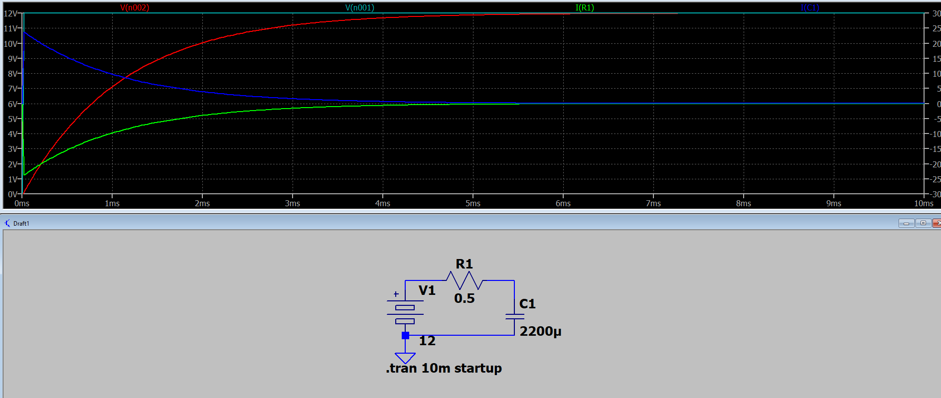

LTspice not congruent with Ohms law? Simple question from a newbie.
312 1
  • LTspice shows 23.745 A due to capacitor charging behavior

  • Use .tran 10m uic to avoid startup ramp
