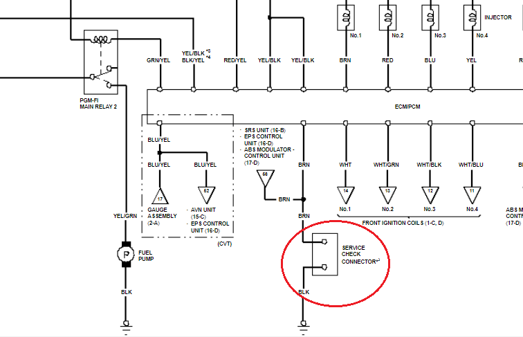

    1999 but apparently someone was replacing the engine and driver for 1.5 and the driver writes D15Z6 and I can not connect anything on pin 7 is 5 V which surprised me and my son bought a car with a check and ... cheap
  • #13 17896841
    piotrekwoj1
    Posts: 10521
    Help: 947
    Rate: 3433
    I would do that.
    He found the diagnostic line directly at the engine controller and there he flawed errors, go to the diagram there are pins described. It is not known who used myk there with this spacer.

    If it's d15z6 (mark on the engine block) then you have two options. Either there is obd2a or obd2b (pinout on ecu).
    Since 1999 it is rather obd2b there and we are looking for it in the browser.
    in 99-01 there is a OBD diagnostic connector but if it was a swap it may not be active / connected correctly.

    Already repaired and I read the Honda Logger program and read it correctly
