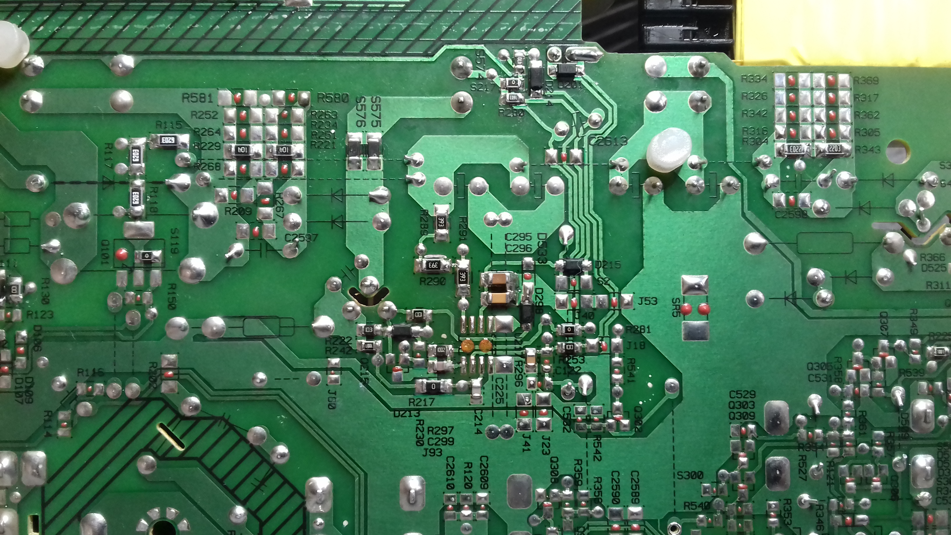

    17IPS20 power supply 23254564 I need information on the type of U217 system in the standby inverter on the 1Q001 5083 housing, after the schema analysis it is definitely not SG6742.

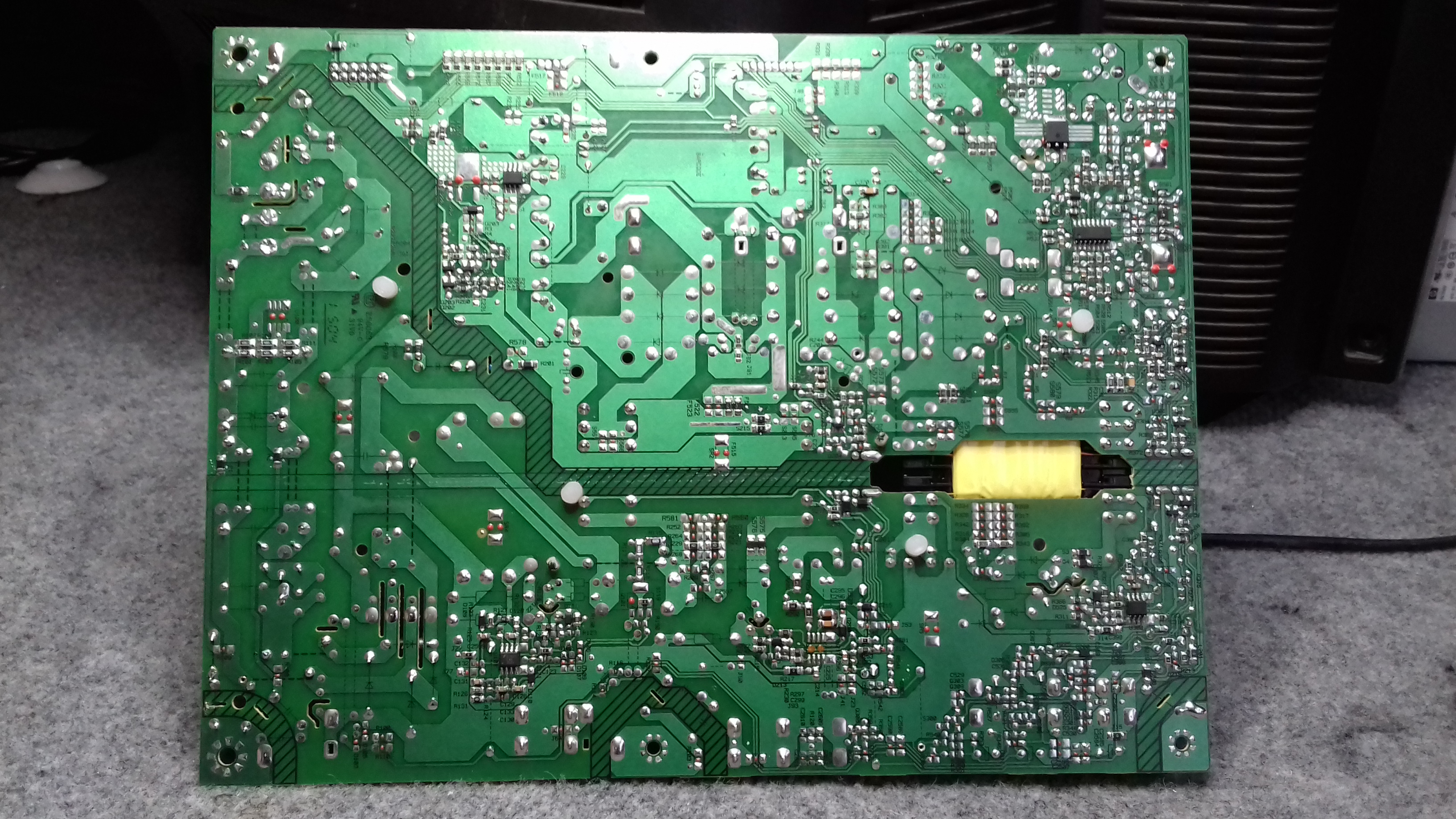

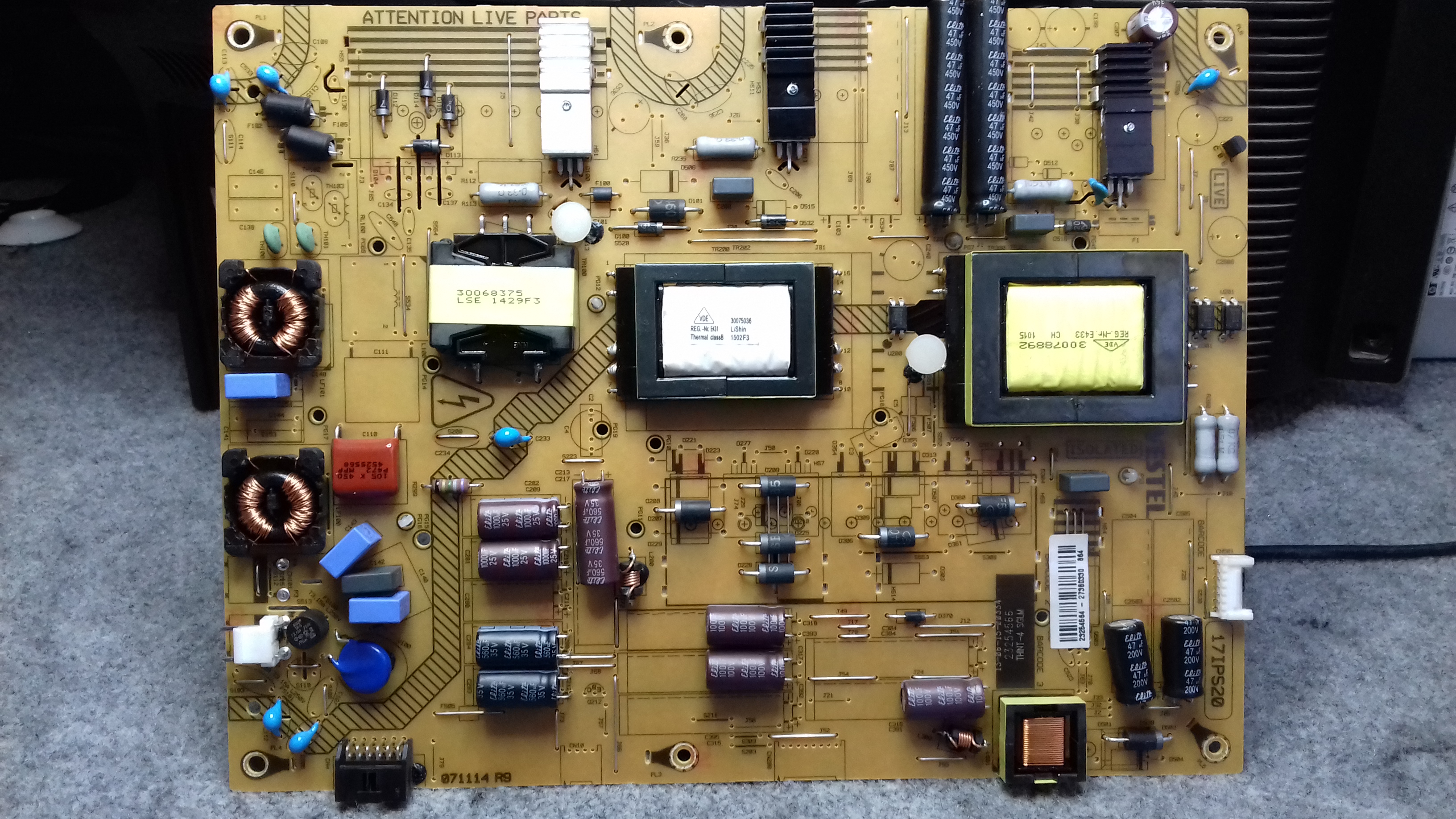

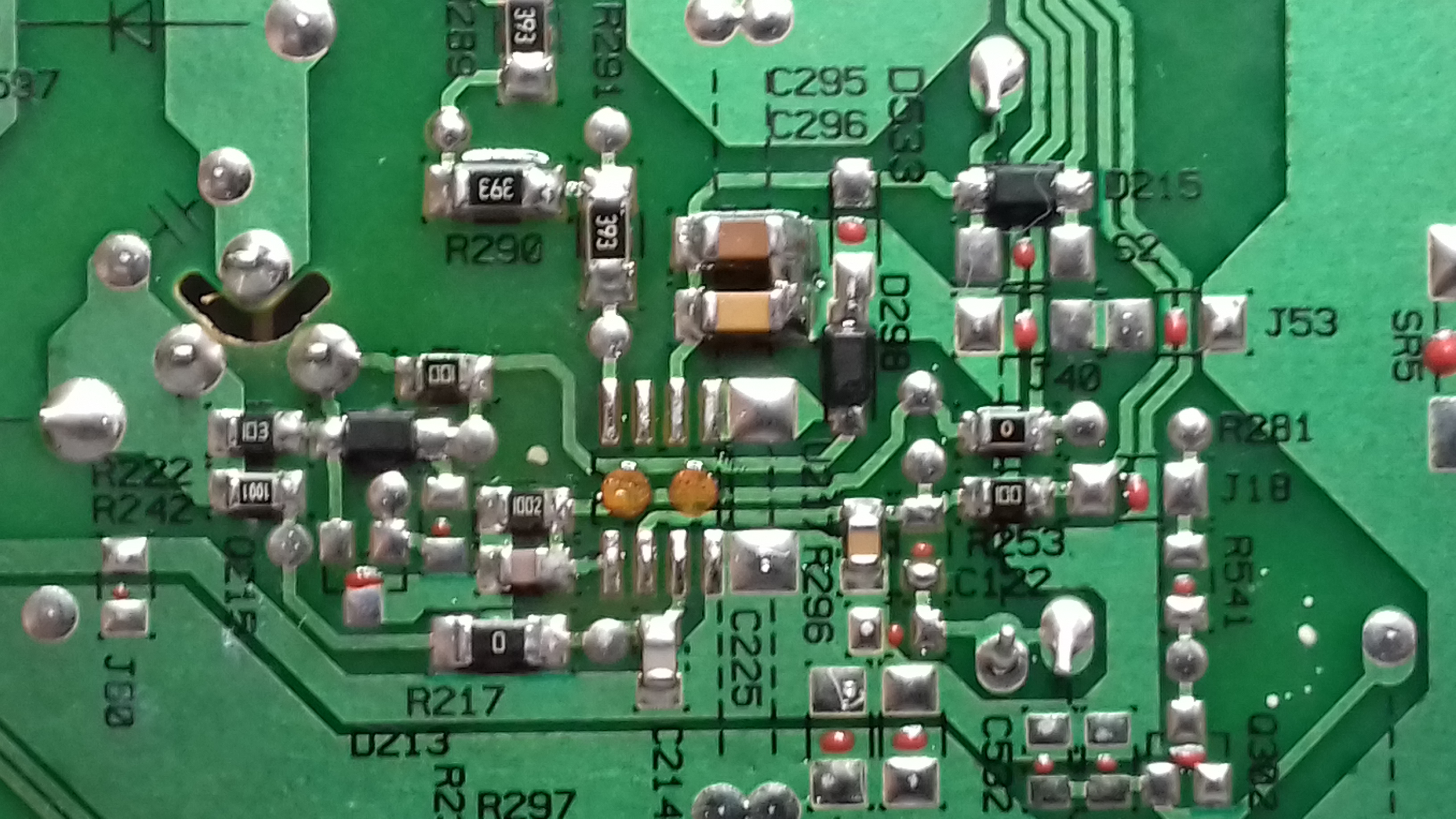

    And I will ask for pictures - the integrated circuit, the place of installation, the entire board.

    17IPS20 power supply - Identification of the 1Q001 5083 system 17IPS20 power supply - Identification of the 1Q001 5083 system 17IPS20 power supply - Identification of the 1Q001 5083 system 17IPS20 power supply - Identification of the 1Q001 5083 system 17IPS20 power supply - Identification of the 1Q001 5083 system
    Both systems are the same with the standby and main inverter.
    greetings

    In my opinion, this is some Chinese FAN6300 used in 17IPS20 R6.
    I also suspect that it is 10001 and not 1Q001.

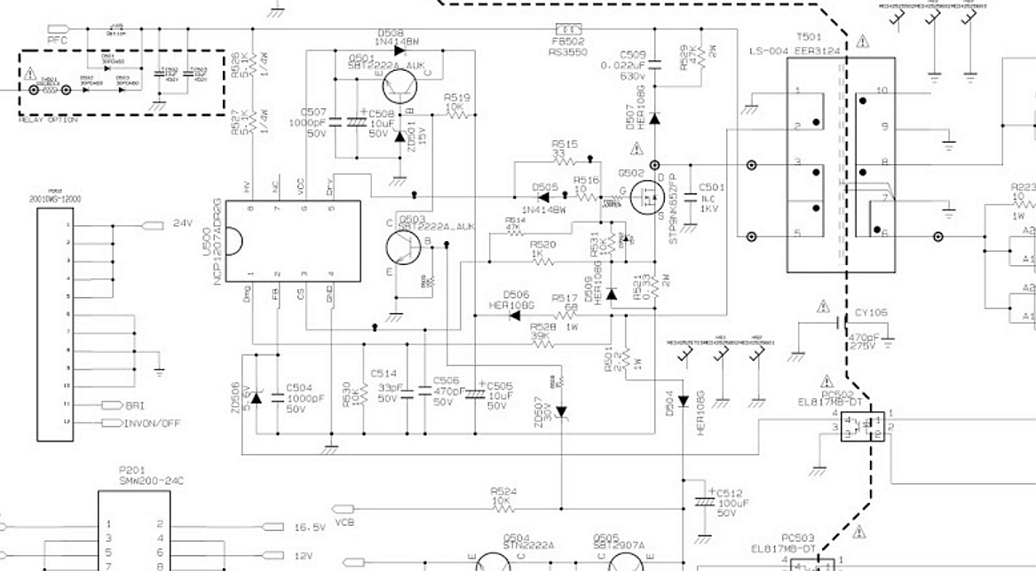

    Compare this application NCP1207 with 42LG5000 LGP42-08H EAY4050530
    - NCP1396A, SG6961, NCP1207
    For replacing FAN6300 with NCP1207A link

    The power supply of course is already repaired, FAN6300A has been inserted.
