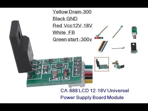

    Hello everyone, I'm new at the forum. I found a topic about my problem but I need more help about that situation. 1q001 is shorted, can I replace it with FAN6300 without modify?
    Thank you

    even though it looks the same, it is not compatible, use a 1q001 instead.

    You can mount a CA888 module. Fast and cheap installation.
