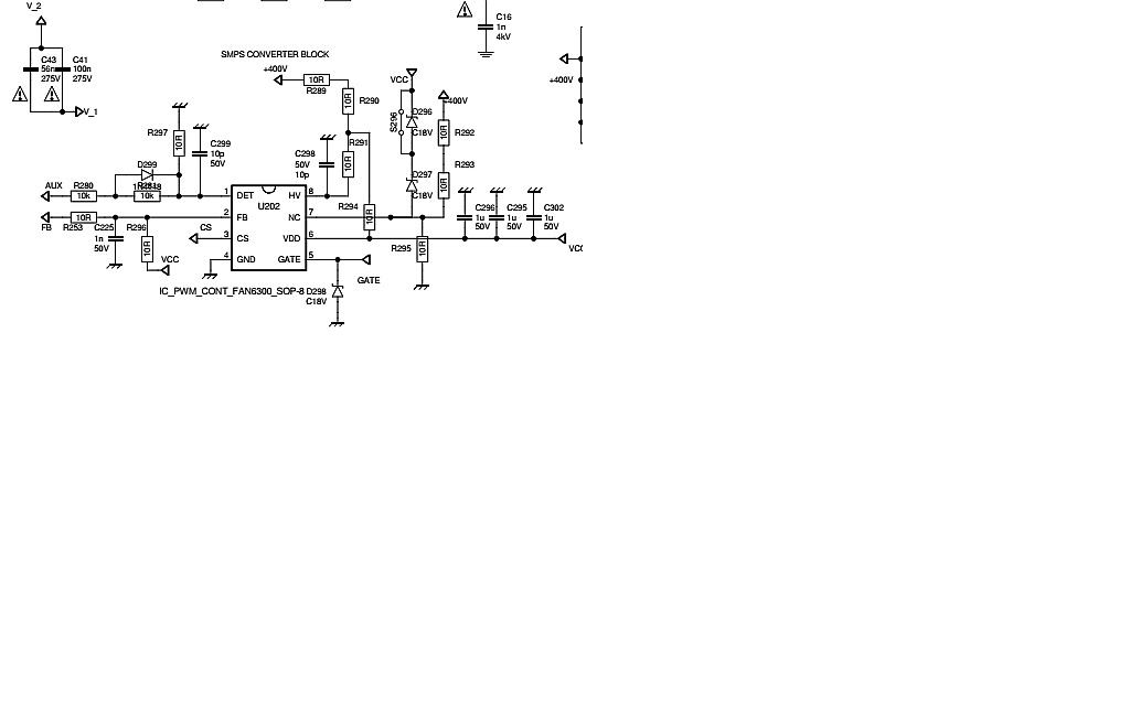

    Hello, Funai 40FDB7514 / 10 TV, damaged 17IPS20 power supply - request to identify burned elements: D298, R222, R242, U202. I have not found a pattern that matches this TV, mo with e someone from colleagues has such a power supply and saw the values of the elements. Please help.
    Identifying Burned Elements D298, R222, R24220161227_1..613.jpg (936.21 kB)You must be logged in to download this attachment. Identifying Burned Elements D298, R222, R24220170103_1..638.jpg (1.28 MB)You must be logged in to download this attachment.

    Hello, unfortunately this is not the diagram does not fit my 17IPS20-5p is a bit different
    All you need is a pencil and a sheet of paper, you draw in 15 minutes, then compare with what has already been written in this forum
    It's from this forum Link_ year 2014
    and
    link
    You have the "new" PSU 17IPS20 - R6 for this model, described as:
    23152101 -27163418
    - min. on link
    ______________
    Vestel 17IPS20-5P
    U202 SG6742HR
    U101 FAN7529
    U300 SG6742HR
    U500 MP3394
    17IPS20-R2
    U202 SG6742HR
    U101 FAN7529
    U300 SG6742HR
    U500 MP3394
