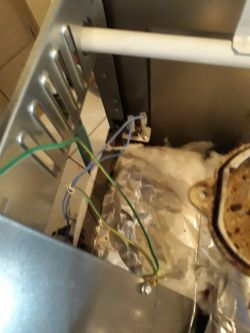

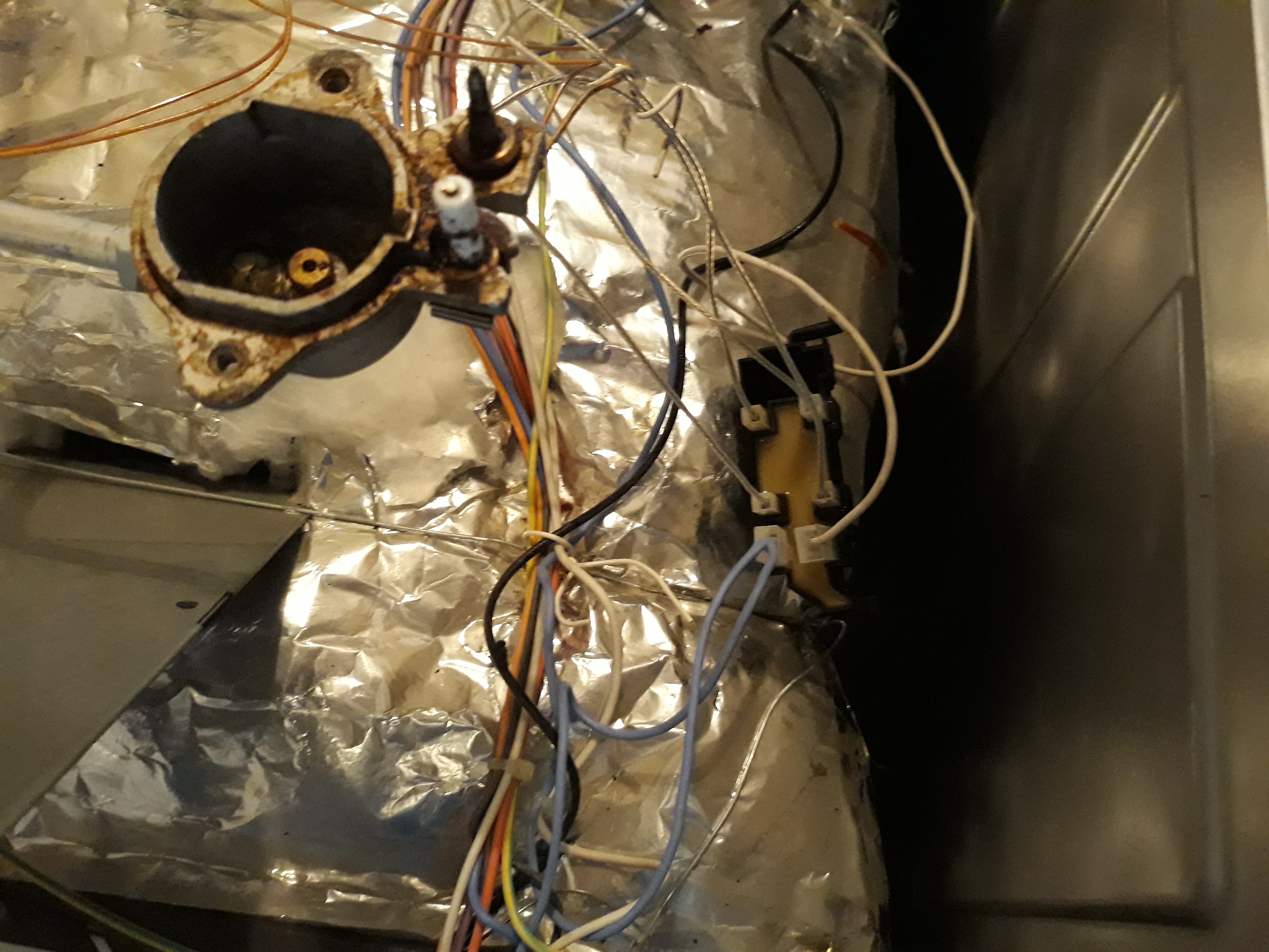

    I have a problem with the oven since I bought the oven. The gas hob works without a problem, only the oven does not work. After turning the taps, nothing happens, the light in the oven does not work, nor does the light bulb above the knob turn on. The oven does not heat. As if he didn't get electricity.
    Model is: Gorenje CC 600l Type 257d.82 Art. Number 344452/03.
    I am thinking about replacing the voltage generator: MIFLEX W10T-4A or the indicator light (bulbs): metalflex sl-656PAD t120 ...
    Can anyone advise me on what the problem is?

    Well, if the problems were new, I would bet on the thermal protection of the oven - one of which is defective. Open from the back and view the whole installation and then you can wonder. Show photos how it looks, we will come up with something.

    At the moment, everything is already complex, even today I will not upload pictures. If I find time tomorrow, I will send it, if not, I will not play with it until the weekend. I can add that from the news, to start the oven I had to pull out the plug and put it back in again. Thanks for every interest in the topic.

    Gorenje CC 600l Type 257d.82 Art. No. 344452/03 Oven Issue - Gas Hob Works, No Heat or Lights Gorenje CC 600l Type 257d.82 Art. No. 344452/03 Oven Issue - Gas Hob Works, No Heat or Lights Gorenje CC 600l Type 257d.82 Art. No. 344452/03 Oven Issue - Gas Hob Works, No Heat or Lights Gorenje CC 600l Type 257d.82 Art. No. 344452/03 Oven Issue - Gas Hob Works, No Heat or Lights Gorenje CC 600l Type 257d.82 Art. No. 344452/03 Oven Issue - Gas Hob Works, No Heat or Lights Gorenje CC 600l Type 257d.82 Art. No. 344452/03 Oven Issue - Gas Hob Works, No Heat or Lights
    I replaced the miflex generator, but it did not work. There is no voltage on the oven.

    In the photo I can see that there is a relay (black housing) 17A contact load. Short the contacts (they must be normally open, you can remove the relay housing - just press the anchor) that energize the heater switch. If the oven snaps, either the relay is damaged or the clock system itself has a drawback from new.

    It turned out that the display was a problem. When it is completely disconnected, the oven works. I will also give it for repair or replace it with a new one. Thank you for all the advice and for your interest in the topic. A great plus for forum and users. Thanks.
