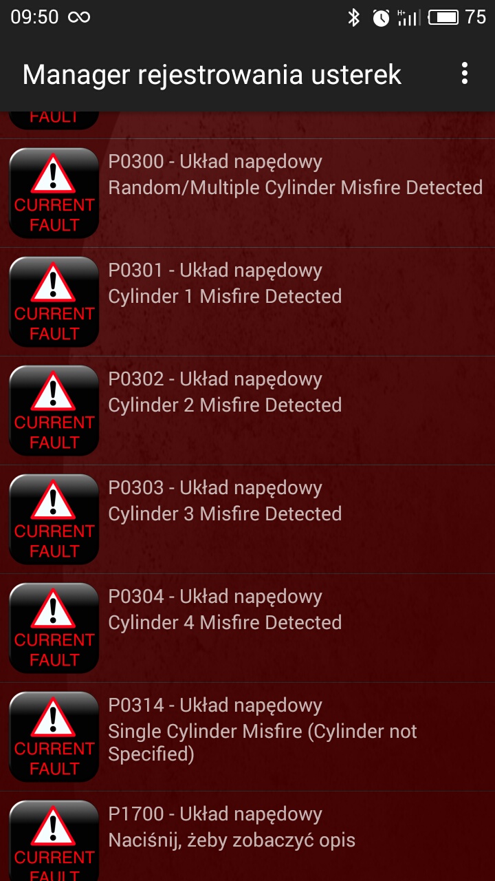

    bigos0204 wrote:
    I have had a problem for two months
    With ignition loss. I have already replaced the coil, candles, shaft position sensor and the whole module, i.e. this computer was in regeneration and the problem still appears
    Provide error codes and descriptions.
  • #7 16574933
    bigos0204
    Posts: 36
    Rate: 8
    This is how it looks with me
    • Opel Astra H 2004 1.6 LPG 105hp: Ignition Loss, Coil/Candles/Shaft Position Sensor Replaced S70708-095043.jpg (250.04 KB) You must be logged in to download this attachment.

    We can delve this topic without end. I don't know when he registers these errors about misfires. You can view in live data with a diagnostic device how and when these ignitions fall out. If, as you say, there is no difference whether it is PB or LPG, then you can skip the fuel system, i.e. fuel pressure, injectors. You changed the candles and the coil so I assume that the spark is checked and it's ok. So giving what is the vacuum in the manifold, what injection time, intake temperature, engine temperature, maybe something more will be known. And this is how we can - maybe a clogged catalyst, maybe a changed camshaft, maybe worn shafts or maybe burned valves etc. etc. If you don't feel tired, give it to a workshop, only to one where after reading the error they will not immediately replace the coils.
