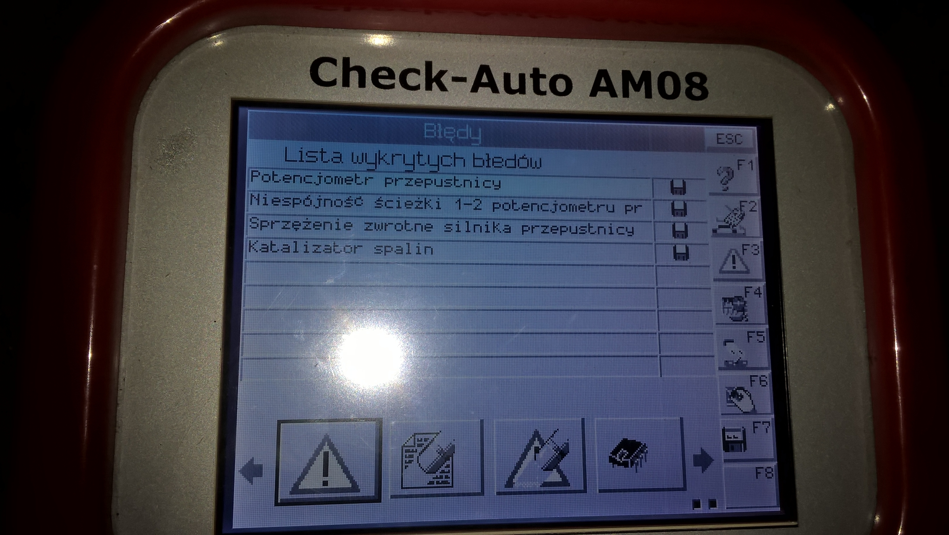

  • #14 16677924
    Dawid W
    Posts: 193
    Help: 8
    Rate: 88
    Hello interested.
    I changed the throttle with the second car and it would seem like a bull's eye. After the substitution, the "donor" got behavior like a "patient" or throttle. For a while the cars drove and the "patient" got the same symptoms on the new throttle as on the old one. That is, revolutions around 2500 and no reaction to gas, the engine behaved in the same way as I unplugged the throttle completely. I decided to buy a new throttle for heavy money, after putting on the "check" and the throttle indicator light went out, the car itself started to run normally, including idling. Full of joy, but for some time, after a long ride at a constant speed, the "check" was lit and the car did not run perfectly, although it was possible to drive. An error popped out of the catalyst (in fact, such a package as in the picture). Kat was exchanged for some replacement, which somehow did not surprise me and did not worry me. Can a malfunctioning catalytic converter affect the throttle. Or maybe the beam is lying somewhere? Does the driver have any software hole? Do you have any ideas? Because for me it is a harness to be interrupted and a driver to update.
    Have an idea.
    Thank you
