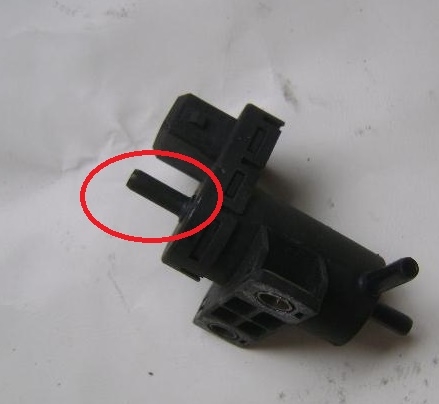

    I came to such a sensor:
    Renault Megane 2 1.9 DCI 2006 - No Power, Struggles at 3k RPM, Air Stabilizer Membrane Issues
    and I have a small question in the sensor sticking out "spindle" but no one is connected to it or is it supposed to be so?
  • #10 17127522
    coperfild
    Level 35  
    Posts: 2760
    Help: 291
    Rate: 1697
    So it has to be.

    There are three stubs in this valve:
    1. vacuum input
    2. vacuum output
    3. filters
    Maybe you have reversed vacuum lines on this valve. if not, there are two or three possibilities: a damaged beam, a damaged valve, a faulty controller. I would check in the order I wrote.
    greetings

    It could have jammed the valve in the open position. If it is still removed, blow in it with air, if air connected to it is going to be 100% of the valve to be replaced.

    Hello. I bought this sensor and it was only for me to mount it, unfortunately the weather does not let me, but let me know if anything has helped. Cheers and Merry Christmas :) )
    Hello again, I changed the sensor and the car is crazy :) ) regained power and even I would say that it got more energy only worries me such a whistle as if the turbine was driving (the sensation of power from the turbine begins at 2200 revolutions) but at revolutions up to 2 thousand. you hear such a gentle whistle of propelling "something" What can it be? Or is it supposed to be this way? Greetings.
The discussion revolves around a 2006 Renault Megane 2 1.9 DCI experiencing power loss and struggling to exceed 3,000 RPM. The user initially resolved a power issue related to the mapsensor but encountered a recurrence of the problem. They noted that disconnecting the air stabilizer membrane temporarily restored power. Responses suggest checking for underpressure in the hose, potential damage to the control valve, and ensuring correct vacuum line connections. The user later replaced a sensor, which improved performance but raised concerns about a whistling noise from the turbine. The conversation emphasizes diagnosing and replacing faulty components, particularly the control valve and sensors, to restore vehicle performance.
