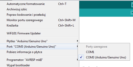

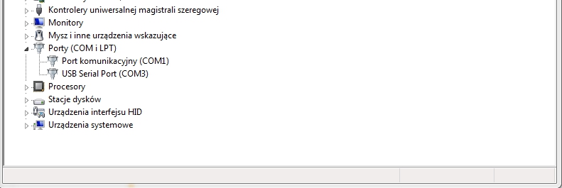

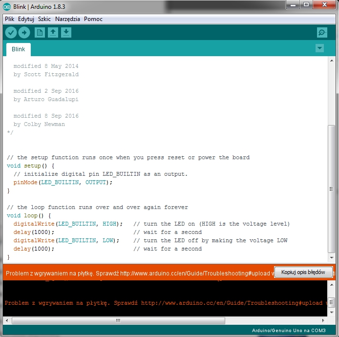

    I am a beginner user of arduino uno and I have trouble uploading any project to arduino

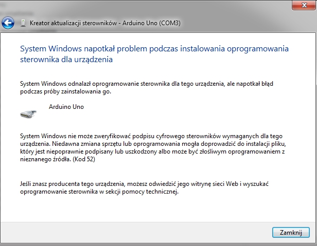

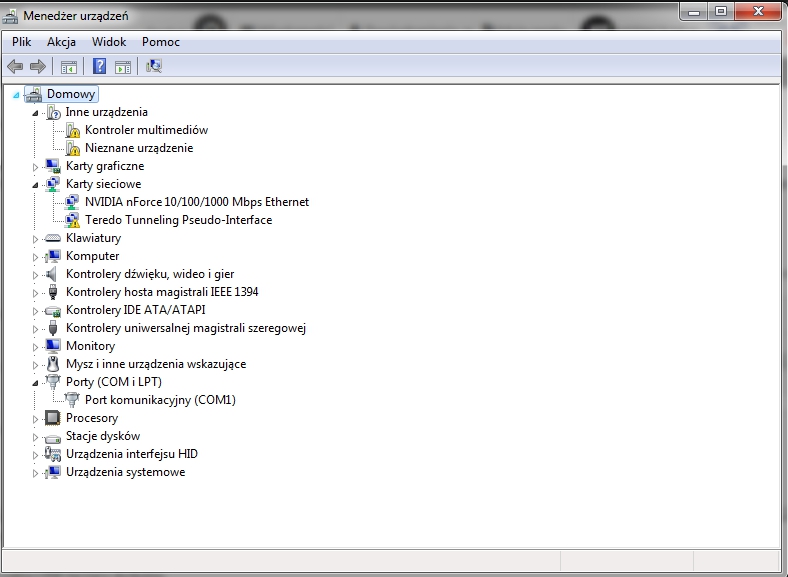

    Ok, first know that you showed us the screen where the most important information is hidden ... (I'm talking about screen # 3).

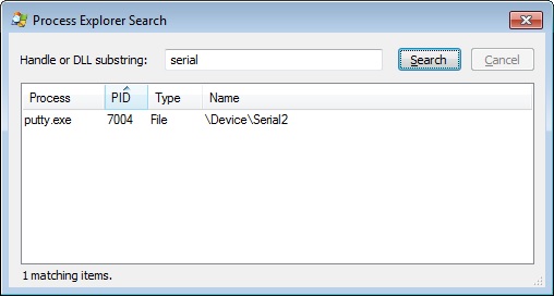

    Exactly, about this message in the last photo. Access to port COM3 is denied ... Something is blocking this port, are you able to determine what is taking access to it?

    I do not know how to check it, but when I change the USB cable, the device manager does not change the port and COM3 stays all the time and should probably change to a different one.

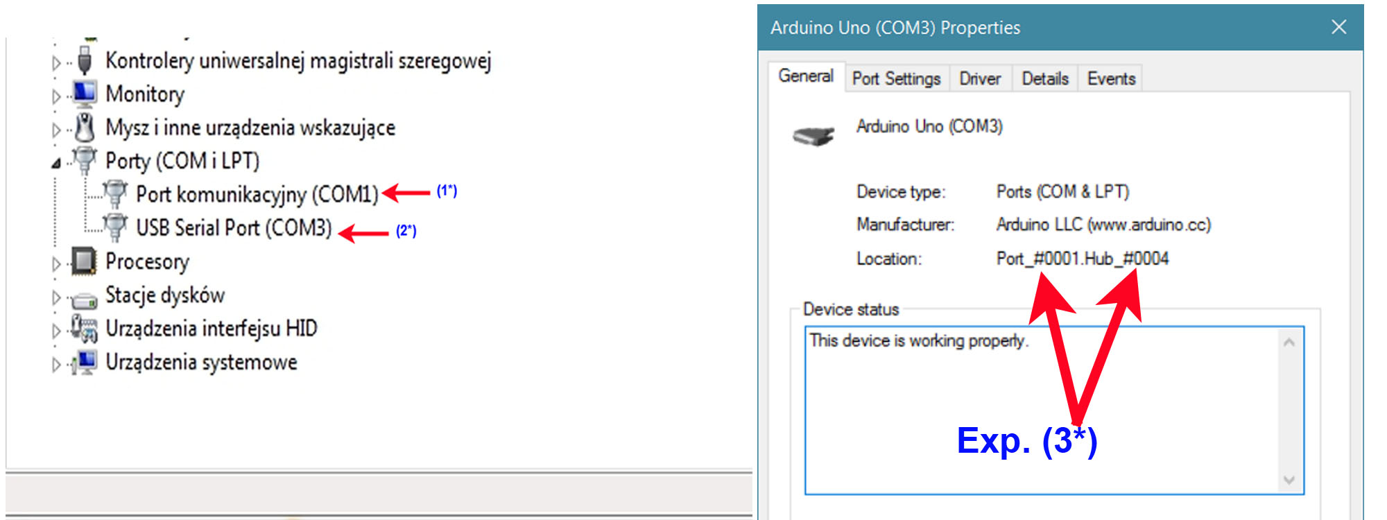

    emarcus wrote:
    Make a location note: Exp. (3 *). By changing the socket of the plug you will observe changes in the location of the socket, remaining constantly in the same configuration. for example com3 (default configuration).
    By opening the other tabs you will learn more details of this configuration.
    With the Device Manager still open, disconnect the USB cable connecting the Arduino.
    With proper configuration, this line should disappear from the list of connected devices. If both items disappear (com1 too), this would indicate errors in the configuration of this device.
    By changing the socket, the computer sees this change, and after disconnecting the plug, the computer stops seeing the COM3 port. Beginner Struggles: Difficulties Uploading Projects to Arduino Uno Plate Beginner Struggles: Difficulties Uploading Projects to Arduino Uno Plate Beginner Struggles: Difficulties Uploading Projects to Arduino Uno Plate

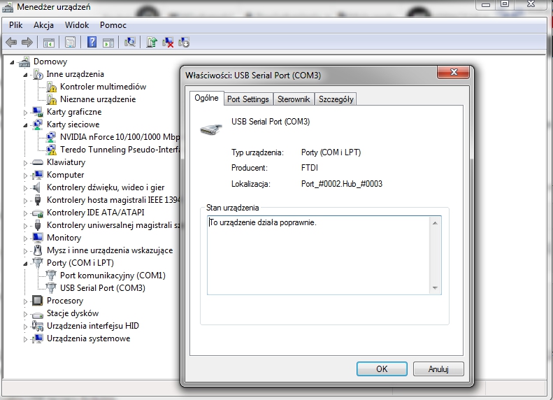

    emarcus wrote:
    This only confirms the physical connectivity (of "some device" ;) arduino with a computer, but this does not prejudge the correct communication for what the appropriate driver is used.
    In the previous post I asked about the type of circuit in the USB bridge of your board, which you deigned to skip.
    From the information you provided, it appears that you have installed the driver for arduino containing the FTDI chip as it was for Decimil and NG A-ino. I suspect your board is not built on this system, but rather on the cheap Chinese clone CH340 / CH341, which does not work with the original FTDI driver.
    If your board is similar to one below, then you need to install a different driver.
    The driver packet included in the Arduino IDE installation kit does not contain the driver for this option, so find yourself.
    Try searching the Internet for the right version of Windows, or here:
    http://www.wch.cn/download/CH341SER_EXE.html -original Chinese website,
    or
    http://sparks.gogo.co.nz/ch340.html
    e marcus

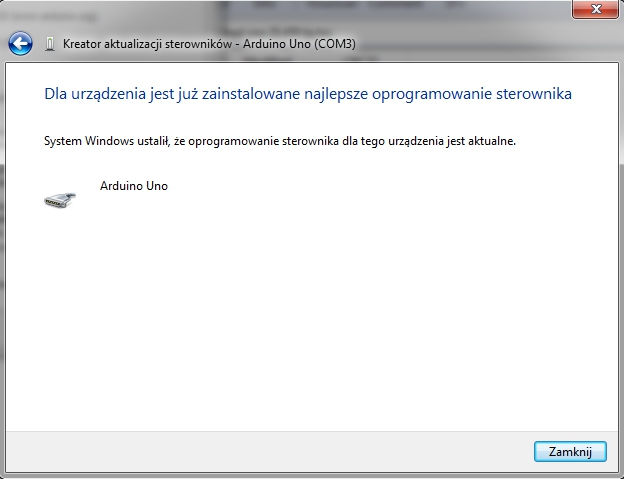

    I apologize for the omission. I have the original arudino uno board from the botland store, the board has a USB type A port
    https://botland.com.pl/arduino-moduly-glowne/1060-arduino-uno-r3.html

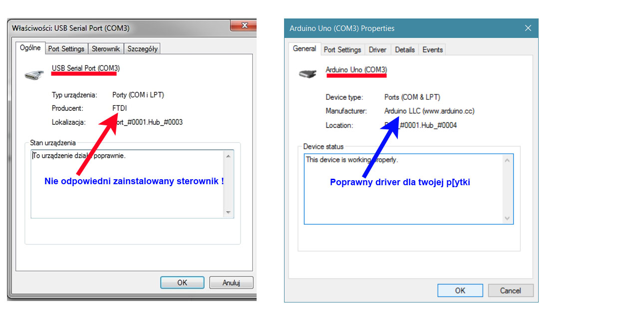

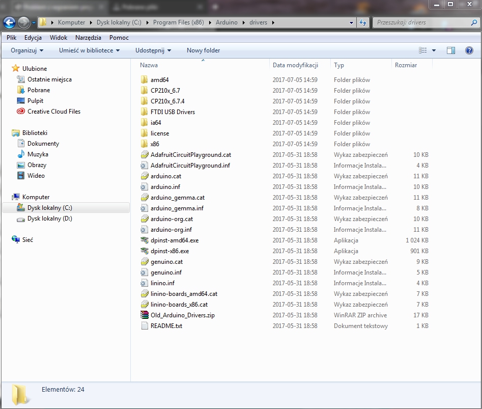

    So as I expected; Although this is not a clone, you still installed the wrong driver.
    There is no FTDI chip (FT232RL) on your board.
    Also, as I mentioned, older, original / authentic versions of Arduino were built with this system, but the current ones use a cheaper Mega16U2 processor that fulfills this role by having a suitable soft in them (it is even in the same place on the board) ...
    You will need to complete the correct driver installation ...
    This time (as I wrote earlier), do not choose automatic search, but indicate which driver you want to install.
    During the procedure ' update driver '(in a Polish-language system it probably will be' update the driver 'or something similar), indicate exactly the right path to the driver, for example:
    C: \ Program Files (x86) \ Arduino \ drivers; - select: including subfolders;
    To avoid further automatic errors, click rather on the bottom inscription: that you want to choose the driver. instead of clicking 'NEXT'
    From the list shown select 'Arduino Uno' and then 'Next'.
    This should solve your problem.
    For example, I give the difference between these variants (what you should get):

    I've tried this before and I'm showing you that the driver is up to date. I also looked into the drivers folder and found FTDI drivers, but there were no LLC drivers anywhere. So I looked for LLC drivers on the internet, installed but now there is another problem because arduino does not see the serial port.
    Beginner Struggles: Difficulties Uploading Projects to Arduino Uno Plate Beginner Struggles: Difficulties Uploading Projects to Arduino Uno Plate Beginner Struggles: Difficulties Uploading Projects to Arduino Uno Plate Beginner Struggles: Difficulties Uploading Projects to Arduino Uno Plate [Quote = "emarcus"] [quote = "XSPACE18"]
