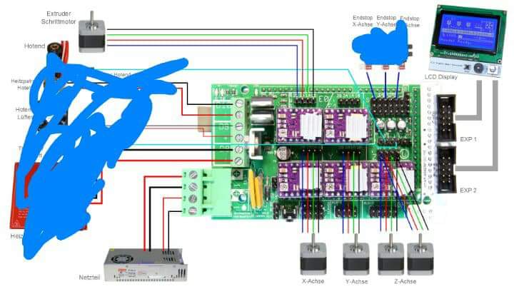

    Write how you pinned it all up or upload photos with the same sketch.
  • #7 16967314
    MkkGxPompa
    Posts: 67
    In the first attachment is my set, while in the second the connection (there is a shield in the attachment, but I have the ramps, but the connections are the same), what I have not yet blurred, under the stepsticks I bridged some pins, as in the video yt (I watched a few and each he did it)
