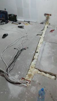

    Hi,
    In order to supply the future TV on the pole in the middle of the living room, today I led to it under the floor USB 3.0, 2x HDMI, 2x RJ45, antenna cable, tosilinka, chinche, minijack, 3x speaker cable and three-core cables to mount the socket:
    USB socket - How to make a USB socket - extension cord (not a charger)?
    In the wall I put 4 socket boxes: 230V, HDMI, RJ45, USB and minijack
    I have a problem finding a USB socket that is not a charger but an ordinary extension cord and I have not seen a minijack socket anywhere at all.
    Do you know where I can buy it?

    Gentlemen, the prices of these sockets are a drama, I will not spend PLN 500 on a frame and a few cheap cables in matching plastics ...
    I think I will buy short RCA, HDMI, 3.5 mm jack extension cords, plastic plugs and I'll fit and stick them myself ...
    The AS series from Ospel seems to be the cheapest, but they don't offer jack input.

    I have already laid a new floor, I do not want to hammer or pull the smoothed cable pipe out of the wall. I need a frame for 4 standard boxes as in the picture.
