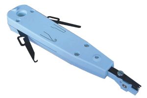

Yes—this kind of RJ45 wall socket is a punch-down (IDC/LSA/Krone) connection: put the conductors into the marked slots and press them in with a Krone/LSA tool, or carefully with a small flat screwdriver if you do not have the proper tool; do not strip the insulation first because the contacts cut through it [#7138938][#7139074][#7139131] Make sure the wires follow the socket’s T568B markings exactly; in B the order is white/orange, orange, white/green, blue, white/blue, green, white/brown, brown from the contact side [#7139074][#7139131] Insert the cable from the side of the cable tie/clip and keep the untwisted section as short as possible [#12934636] If it still does not work, the other end of the cable is likely wired wrong too, so verify that end is also T568B and test continuity with a LAN tester or, if needed, a multimeter or a 9V battery plus bulb setup [#7139074][#7139131]

    I always put on the tips and clamped the crimper.
    However, I never connected the cable to the socket. Could I ask for help? Is it also somehow tightening, or is it pushing the cable with a screwdriver into those hooks that are at the angle?

    for "pushing" there are impact knives that cut the cable straight away, but you can use an ordinary, small flat screwdriver. Of course, combine according to the appropriate standard.

    As for the tool, enter in the Allegro:
    lsa krone knife
    Connecting RJ45 Cable to Outlet: Step-by-Step Guide with Socket Reference Image
    Most likely, you have something wrong.

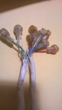

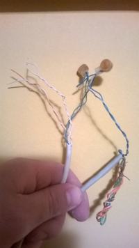

    yogishagy
    by connecting to the topic I will ask for help.
    Description:
    I would like to move the router from point A (living room - RJ45 socket) to point B (hall - box with cables entering the apartment).
    Some time ago there was an IT specialist from Netia and during the internet connection service he connected the router itself to a socket without a modem (originally it was a modem).
    My problem is that after unscrewing the box there is a bunch of network cables (9 wires, 5 of which are loose, not connected and 2 pairs of 2 wires connected (white and gray covers}) with which I can't really find my way.
    Below I will present photos showing the cables entering the apartment.
    Here I showed the incoming wires:
    On the right, 5 cables not connected, are marked with numbers / markings: 1,2,5,6,2A
    In the lower right corner - a yellow network cable which will be connected to the router on one side and with magic cabling on the other side (not visible).
    Here, the wires are marked with 2C and number 3 - I guess this connection is to the telephone line (socket in the hall)
    Another pair labeled 2B and 4
    Being in the electronics store, I was advised to use such an adapter instead of the cuffs visible in the photos - a lower speed drop than on the cufflinks.
    Going forward, my question is whether it is physically possible to connect the router to these magic wires :) ?
    It is enough to 'connect' to the current one or should a new connection be assembled?
    Thank you for your help,
    If you have any questions, please help.

    I changed to the connectors you have in the second and third photos, my attenuation dropped (in the case of ADSL). You can definitely connect to these magic wires. This Netia gives you the LAN immediately and the router has a WAN (without ADSL modem)? Do you have an ADSL Modem? The second photo shows that two wires, i.e. ADSL. The third photo simply shows a "soldered" cable, they taught me that "expensive" mains meters would not show an error, to somehow earn it like plaster sockets or just some connectors of this type. However, fast-connectors are also fine, if you connect on 100m of cable, then maybe it would have to be done precisely, and no one has fun. In the first picture I can see 8 lan cables + power. Where does the cable go from the RJ45 socket? And if you have no idea, mount DLAN adapters and guitar (as long as you have the same phase).
    Or maybe you just have a router that has one WAN / ADSL socket and you still have ADSL only an RJ45 socket. That's what I have in Fritz! Box 7240
