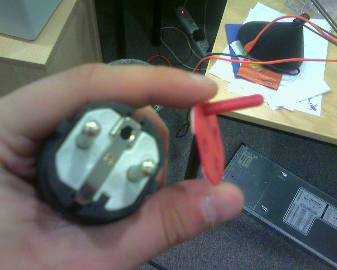

    #5 11204794
    andy127
    Level 30  
    Posts: 1249
    Help: 134
    Rate: 193
    biomedyczny wrote:
    Extension cords should not be connected to them. A strip with all computer equipment, for example.
    This strip is also a kind of extension cord. As he called, so he called what will hang at the end of this extension cord.
    MuNiO wrote:
    This is a protection (key) against connecting foreign devices to the UPS sockets.
    In addition. This key (red) sticks to the plug and thus the plug becomes compatible with the socket. Plugs without this wrench do not want to enter these sockets. This way it is determined which device can be connected to the coded sockets.
    Andrew

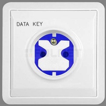

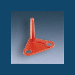

    There are different types and different security features, e.g. with a key.
    And the type you are talking about has become popular because it is on a flush-mounted rail.
    It looks like:
    Connecting an Extension Cord to a Red Socket in a Floorbox: Best Practices and Procedures

    The top photo shows an adhesive tape (white) on the back of the cap. And all clear.
