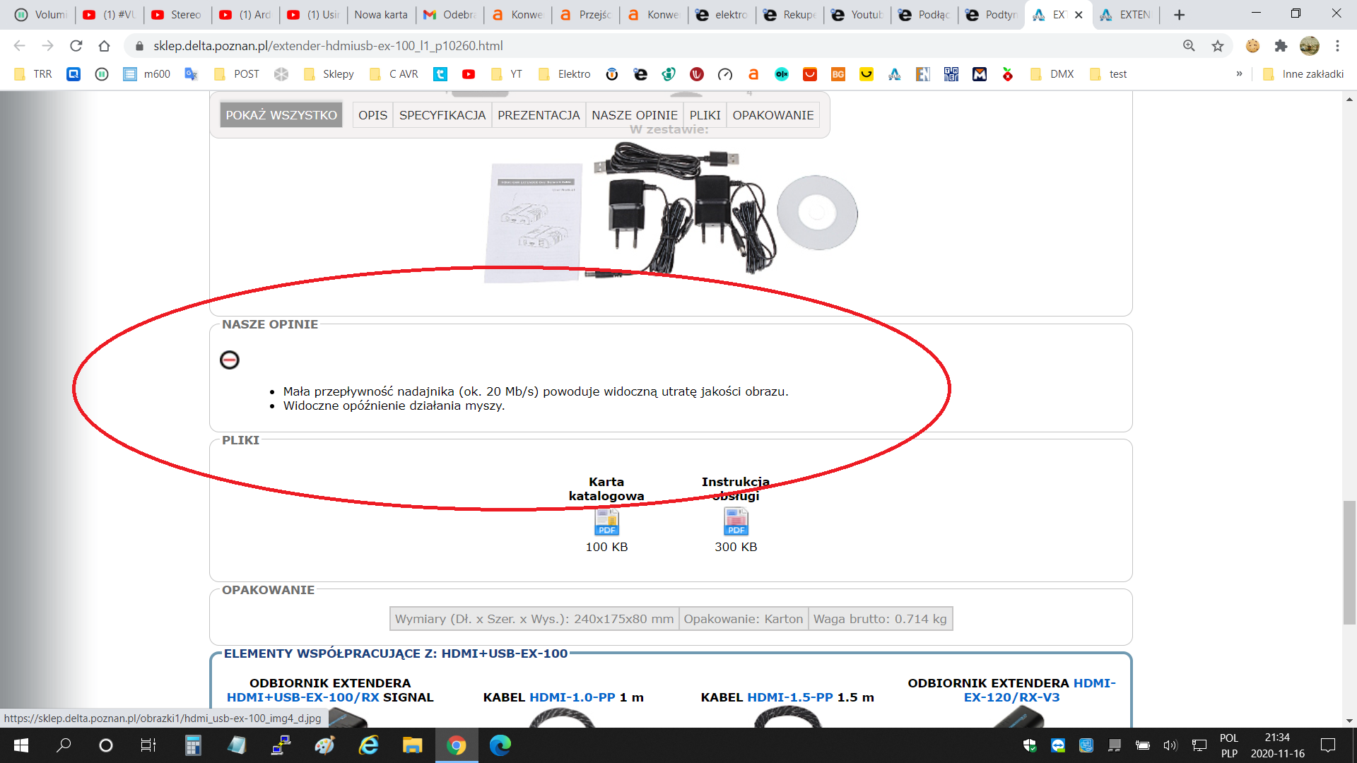

    And it's interesting that a colleague uses and doesn't see the quality and latency saving on this converter, even though the vendor himself describes these as downsides of this converter. Flush mounted cables 10m - communication with PC in other rooms .

    @adversus Maybe so drive up to Delta and check what they currently offer because for the 100m version they currently have a higher KVM model https://sklep.delta.poznan.pl/extender-hdmiusb-ex-60_l1_p13173.html with two USB ports and an HDMI pass-through socket on the transmitter side, the photo as well as the description on the website is out of date.

    I was referring to your post, and I was in Delta today :) because I was just buying HDMI converters (such a coincidence, I recommend fresh yeast from them as always - such a Delta marketing ploy as they are housed in an old bakery).
    You're recommending something that has a description that I've flagged up in the screenshot so that the author of the topic knows that the indicated extender isn't necessarily as great as you describe it, just so much on topic. Nothing personal.
