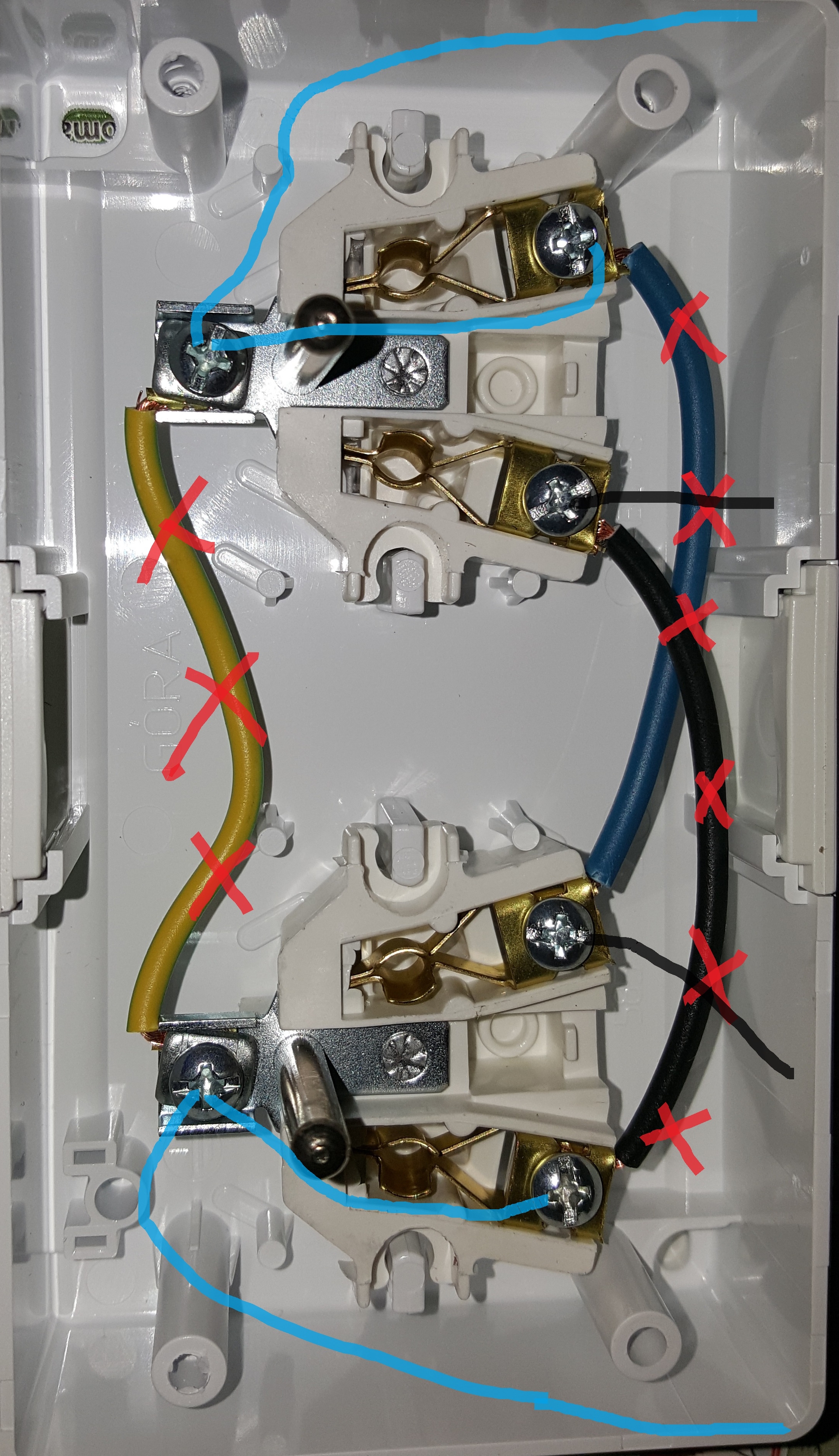

    kebi88 wrote:
    I have a question about connecting to electricity. Unfortunately, it is old construction, and there are two wires, no grounding.
    Basic question, there were any bridges between those old left and right sockets :?:
  • #32 16715652
    kebi88
    Posts: 58
    Rate: 18
    Board Language: polish
    earlier it was done so that the neutral wire went from the terminal to the pin ...
  • #33 16715660
    tzok
    Posts: 38661
    Help: 3162
    Rate: 6406
    From what you can see in the photos, there were two separate sockets, in separate boxes ...
  • #34 16715664

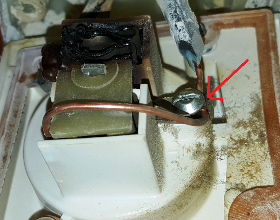

    kebi88
    Posts: 58
    Rate: 18
    No Electricity in Kitchen Sockets on Refrigerator Side: Identifying Cause & Solution No Electricity in Kitchen Sockets on Refrigerator Side: Identifying Cause & Solution That's right, only at one point one socket burned out, and it had to be replaced ... so I want to replace two sockets ...
    Added after 8 [minutes]:
    how well i understand so i have to do?
  • #35 16715696
    kortyleski
    Posts: 12260
    Help: 957
    Rate: 3833
    So it's not a loop after all, but two somehow separate circuits. Without knowing at least a part of the installation diagram, you cannot advise anything sensible. Except for mounting two separate sockets as it was done. The mere introduction of two unknown circuits into one gear housing can create a nice face for someone who will later rummage there.
    So there can be no bridges between the sockets, as some suggest, you should not create a double socket and two single ones as it was so far.
    Then replace two sockets, not one double.
    lisiorrr333 wrote:
    The sockets are in a loop from here, four wires
    lisiorrr333 wrote:
    You need to connect the wires by color to each other and to the socket to keep the loop
    melpin wrote:
    I agree with my friend 100%
    And I do not agree
    lisiorrr333 wrote:
    It will be fine, this is how I have all the sockets connected at home.
    And you are WRONG, do not suggest such a connection to the author.
    lisiorrr333 wrote:
    And in the previous one you had the wrong thing that you wanted to remove the two wires connecting the two parts of the socket to each other. The socket might work if the loop is properly powered from both ends, but the loop itself would lose continuity.
    Wrong suggestion.
    lisiorrr333 wrote:
    And that's the point, not to disconnect it anywhere, because then each socket gets power from both sides, with two independent 2x2.5mm cables. This gives greater reliability and safety, and the short circuit loop impedance in the circuit is reduced
    The current is the shortest path in which the impedance will drop :?:

    Gentlemen ... you could write a dissertation on this topic .... neutral to Bolec and from him to the terminal. Phase to clamp. I remove these factory cables from the new socket. Takkk ??
  • #38 16715798
    mawerix123
    Posts: 4143
    Help: 482
    Rate: 949
    No, replace this double socket with two single ones and connect the neutral wire through the pin clamp as you had before without cutting the vein to the second clamp.
  • #39 16715805
    kebi88
    Posts: 58
    Rate: 18
    thanks for the answer ... unfortunately it seemed strange to me and I shortened it a bit ... so I have to give a separate wire for this ...
    so the cable from the wall connected to the pin, and from it will go a new wire to the terminal ...

    Without recognizing the installation TWO SINGLE sockets!

    lisiorrr333 wrote:
    The question was whether these two sockets were connected with each other with two additional wires,
    They were not connected, do not write nonsense and do not suggest any bridges if you do not know a specific installation, if someone has it does not mean that it is everywhere.
    lisiorrr333 wrote:
    With all due respect, I think I know better how to install in my own apartment, right?
    And if I know there whether you know or not, let me just connect the protective pins in the sockets well.
