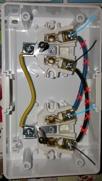

    I do not create a new post, I have a question regarding the power connection. Unfortunately, it is old construction, and there are two wires, no grounding.
    I am asking for advice, I am going to remove two factory wires (marked with red crosses, and plug the wires from the wall into these places.
    Could this be so? No Electricity in Kitchen Sockets on Refrigerator Side: Identifying Cause & Solution

    It all depends on the type of network - hence the possibility of such a connection.
    Check it, for example, on the contract with the energy supplier.
    There is no third protective conductor in the whole apartment? It is worth checking the kitchen and bathroom.

    I take it that you want to have two sockets on two separate circuits? Doesn't it matter?

    There is no protective conductor anywhere ...
    I want electricity in both sockets ... and I have 2x neutral and 2x phase wire for that ...

    kebi88 wrote:
    Could it be so?
    Regardless of the type of network, the connection shown in the picture is not correct.
    Such a solution is unacceptable, two separate power circuits cannot be combined in one box, housing, etc.
    To the author, if you care about grounding, and there is no such conductor (PE), you can perform zeroing, but with a reservation - it is about the type of power network.
    On the subject of zeroing, there were already some topics https://www.google.de/search?q=zerowanie+garó...x-b&gfe_rd=cr&dcr=0&ei=5zPFWbvbFsTb8Aer_oTgCA
    However, I think it is best if you ask an electrician to do this.

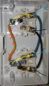

    So if I understand correctly, I have to do it No Electricity in Kitchen Sockets on Refrigerator Side: Identifying Cause & Solution
    and that combination, why is it wrong, I would like to know for the future ...

    kebi88 wrote:
    as I understand correctly I have to do it like this
    Not. Read how to properly perform a zero

    kebi88 wrote:
    if I knew it, I wouldn't write it
    If you don't know it, don't do it. First you connect the "pin" and then you make the bridge. Not the other way around !!!

    First, connect the blue wires together, from this connection you go to the pins and only to the working contact of the socket. The phase wires also together and only for the socket. The thin cables pre-installed in the socket must not be used as a loop connector.

    So I have to remove these factory wires from this socket? Sorry, but I'm a bit fooled ...
    Second question should I use a wire or a line?
