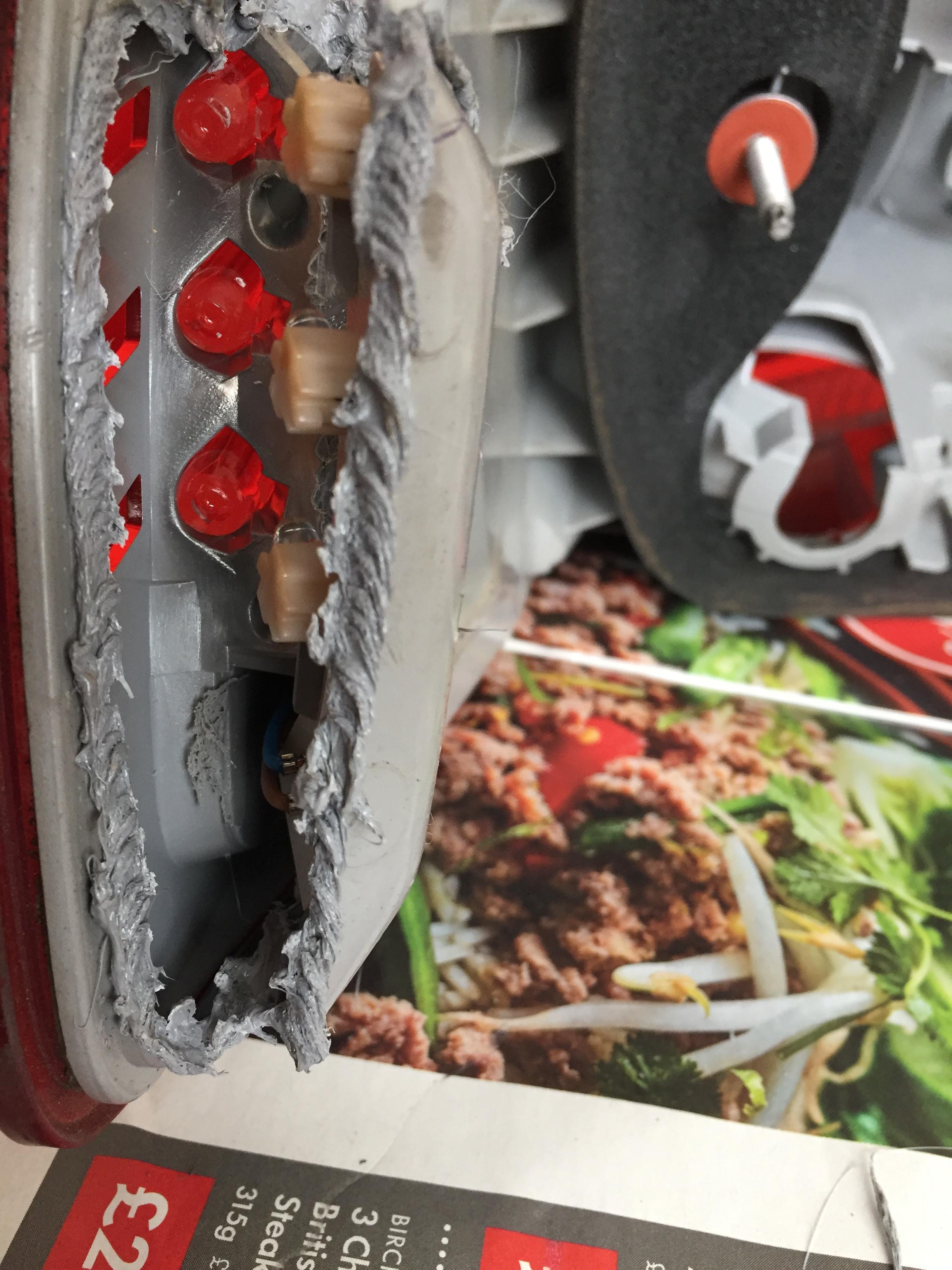

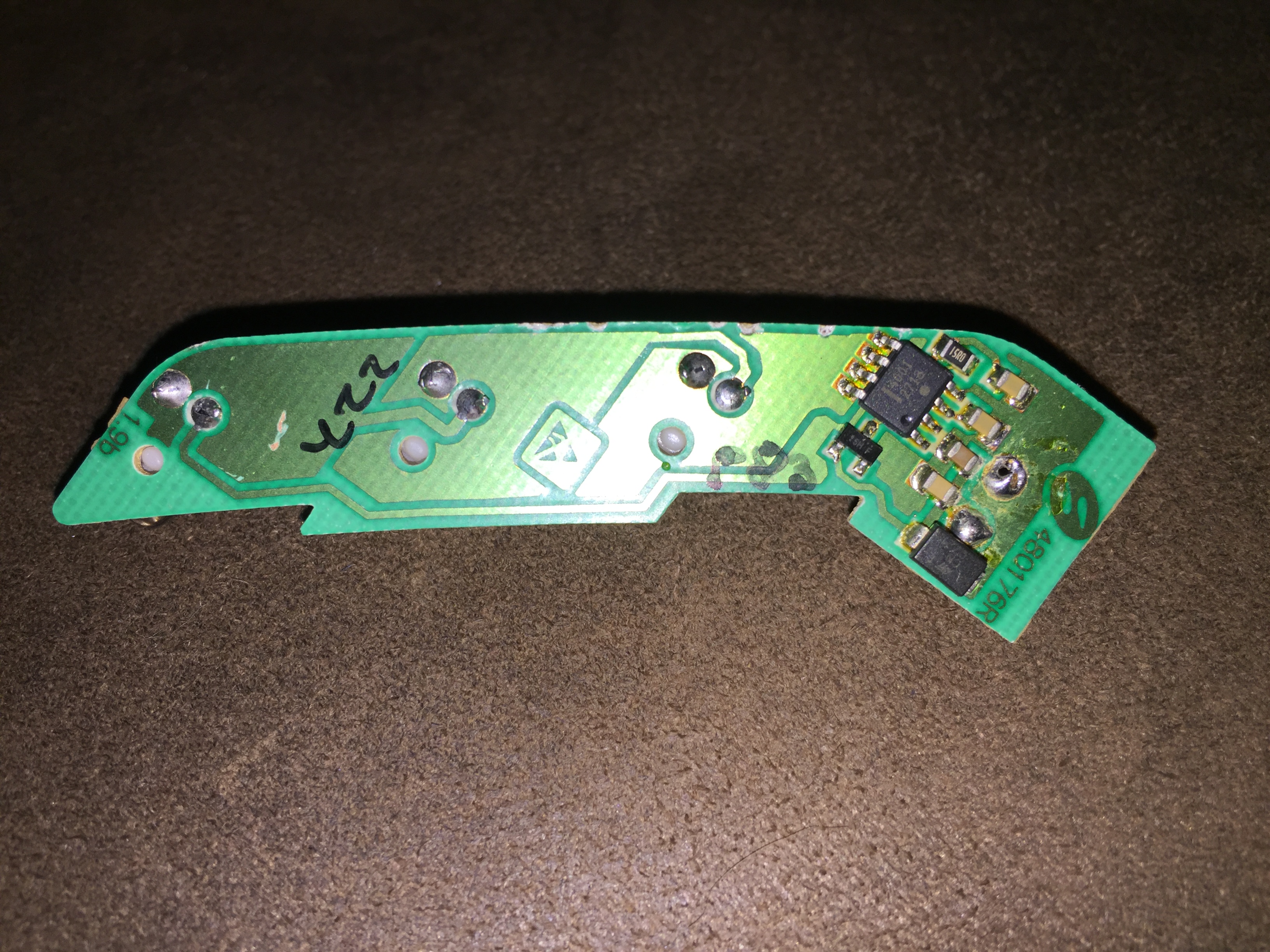

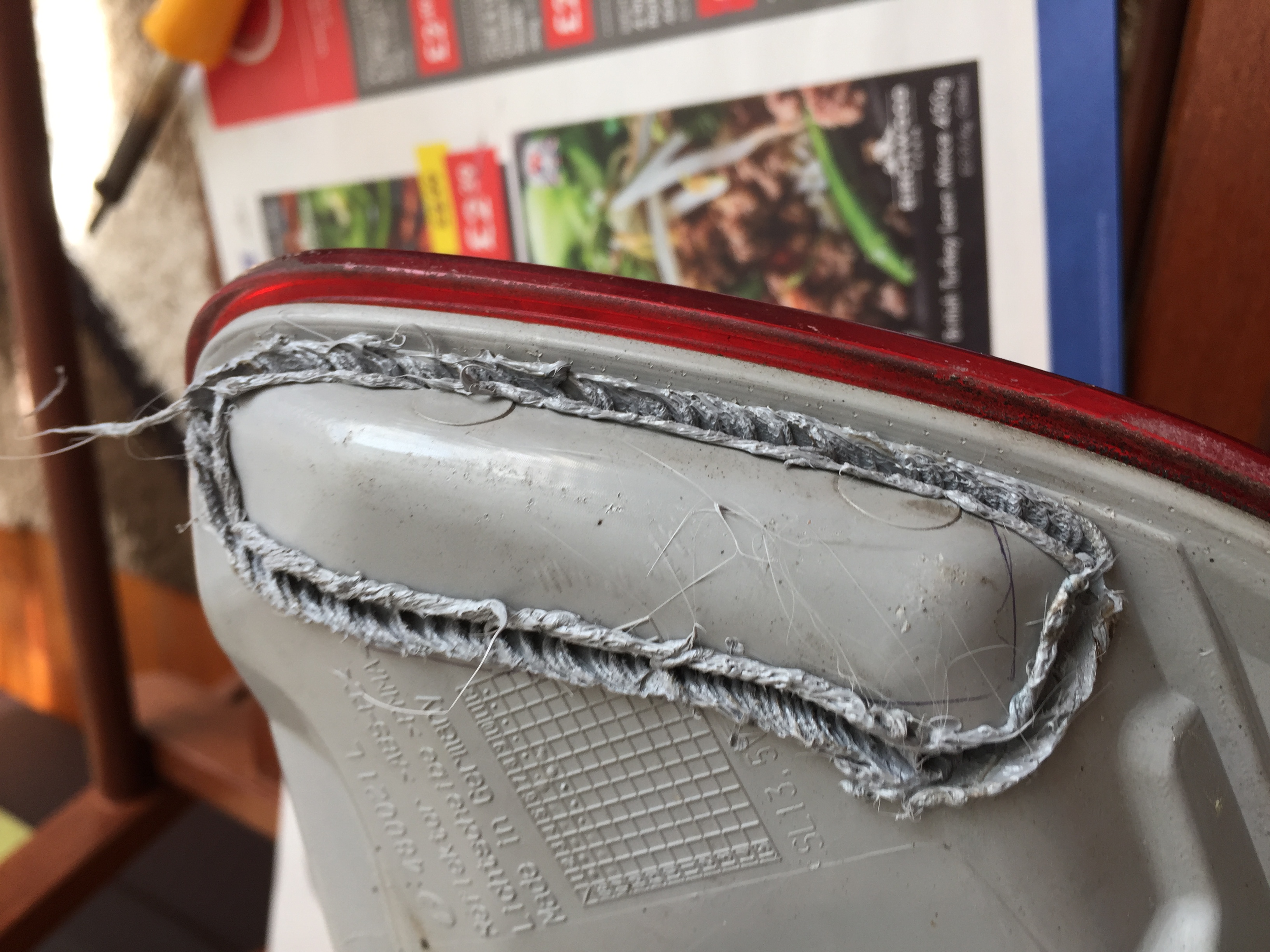

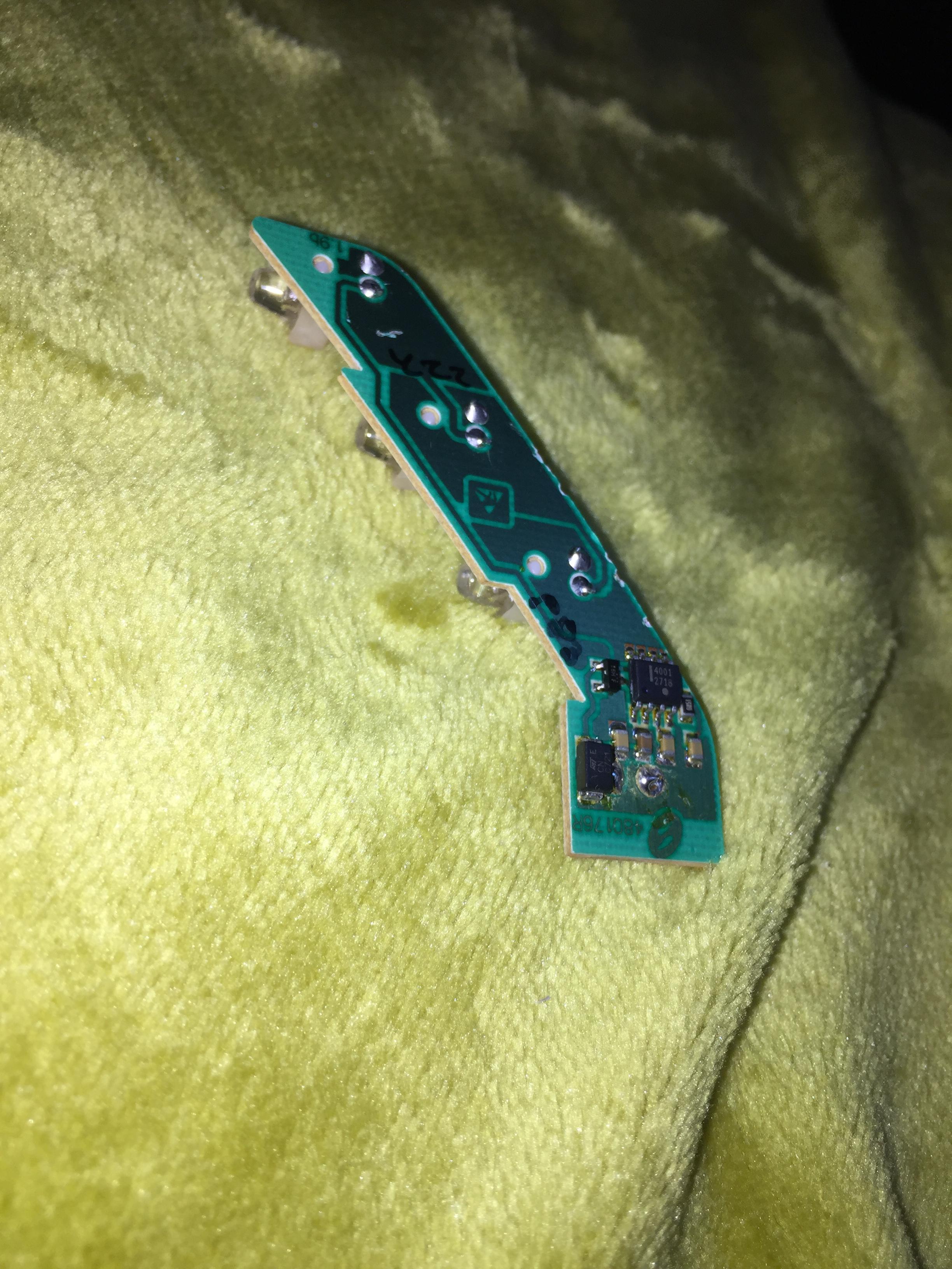

    The rear lamp in the BMW e92 has a parking led light. Mine stopped shining, I decided to explain the plate and check.
    The plate is under the plastic housing. LEDs are still good cables also 12v power supply. Can't find what smd 4001 is? Or maybe fix it differently. Thanks for helping fix this lamp.

    Start by checking the tile power supply from the car.

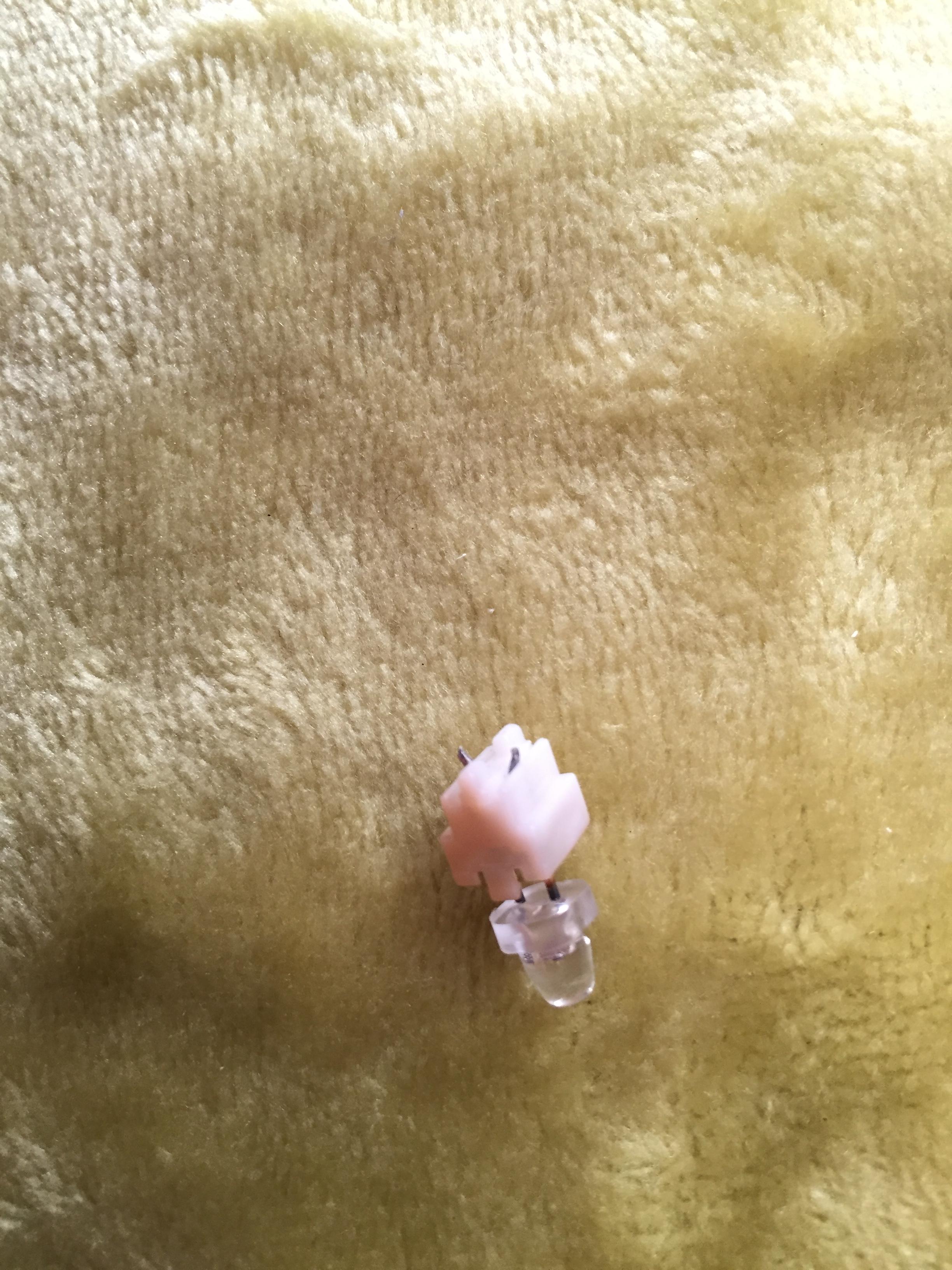

    The lamp is already working. One diode burned out. I founded a similar led, looking for the same. greetings
