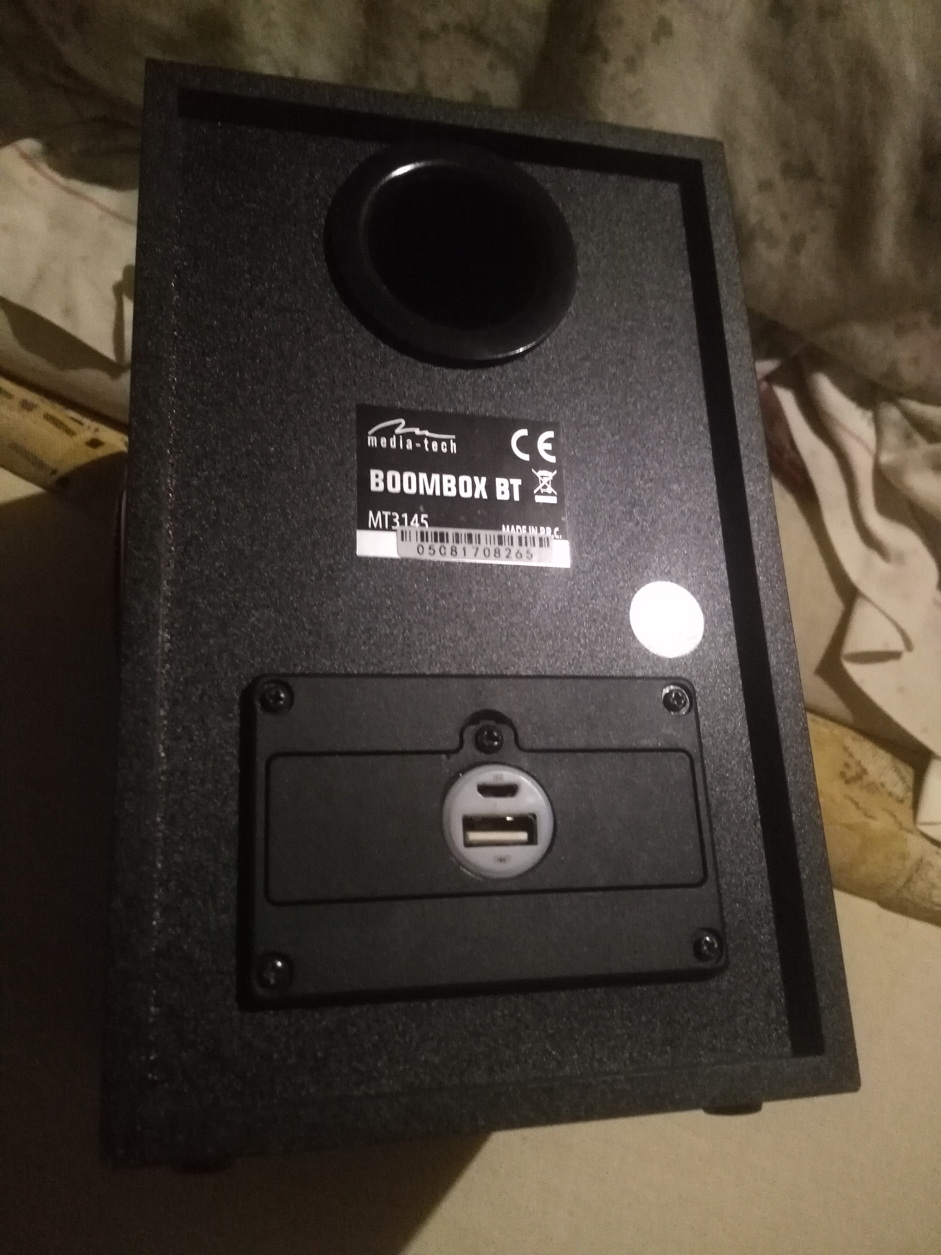

How can I charge a MediaTech Boombox BT MT3145 when the micro‑USB socket has broken off, and where can I connect +5 V and ground safely?
You can bypass the broken micro‑USB socket by soldering a 5 V supply to the marked + and − points on the board, rather than to the damaged connector itself [#16594387] The thread shows these points near the socket; the board needs the solder mask scratched off there first, and you should verify with an ohmmeter to avoid a short circuit [#16594387][#16594273] For micro‑USB pinout, the first and last pins are + and −, with the middle pins used for data [#16587117] One reply also suggests using the diode D1 as the + point and ground as the − point [#16594273] An alternative that worked for another user was charging through the USB socket instead of the damaged charging socket [#16629449]
  • Locating 5 V and ground for bypass charging
    #1 16587040
    esk2
    Posts: 33
    Rate: 10

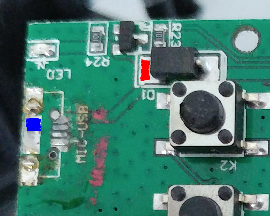

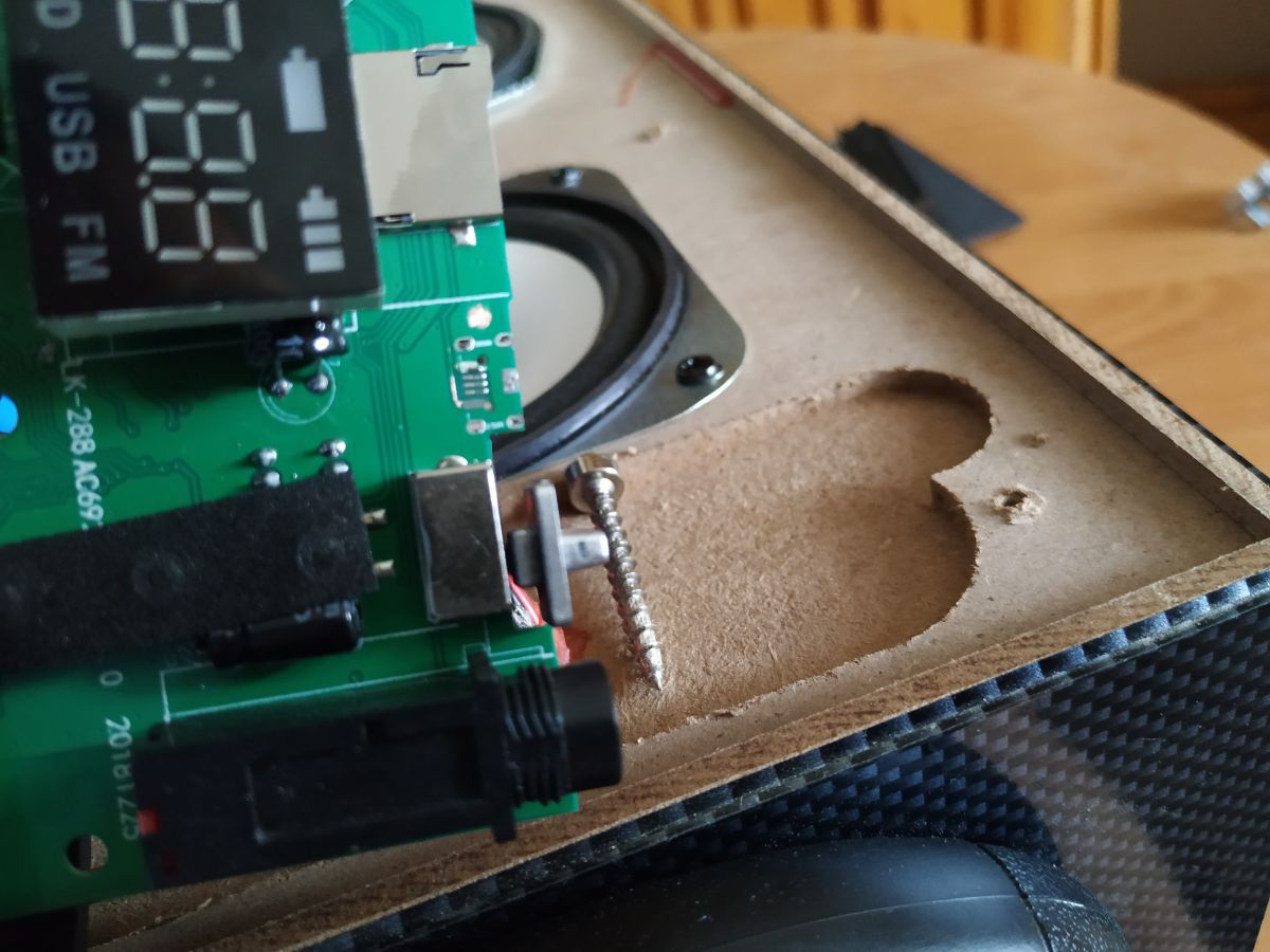

    The USB socket after soldering again fell off, so this is the number 1 defect of this device.
    Now the question is how to solve the problem of charging the device bypassing the micro USB port?
    Soldering it without a specialized soldering iron is not an option, too close paths and you can easily solder them together which will lead to a short circuit; (
    Is it enough to locate the red Vcc (+5 V) and the black Ground? Only how to locate them since I don't have the factory charger ..?
    Help.

    The first and last path is + and -, the rest is for data transfer (at least on phones etc.). Check with the meter in your smartphone charger which pin is + and which one - solder the socket anyway.

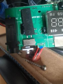

  • #3 16593928
    esk2
    Posts: 33
    Rate: 10
    Where the micro usb has dropped out there is no chance to solder properly. I plugged into the bat1 socket and the room is working, only the loading diode is not lit, so we will see.
    Generally, somehow this product is a failure
    • MediaTech Boombox BT MT3145: How to Charge Device Bypassing Micro USB Port? 20170716_120914.jpg (6.5 MB) You must be logged in to download this attachment.
  • #4 16593946
    jdubowski
    Tube devices specialist
    Posts: 21595
    Help: 2511
    Rate: 2804
    esk2 wrote:
    I plugged into the nest bat1 and poki what works
    Isn't that where the battery is connected? If so, it'll blow you or fireworks.
    But next to it enough soldermask to scratch and solder wires.
  • #5 16594168
    esk2
    Posts: 33
    Rate: 10
    so exactly where the battery is connected, it looks like it has been recharged .. but it turns out that I use it for a long time ..
    and more specifically? because I'm not so good at electronics? you can point this place more precisely or edit my picture ;)

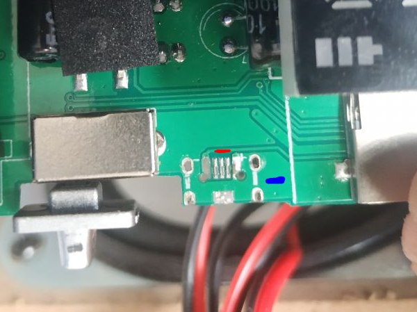

  • #7 16594387
    jdubowski
    Posts: 21595
    Help: 2511
    Rate: 2804
    Then don't you, because with lithium batteries such games end badly.
    You may lose stitches.

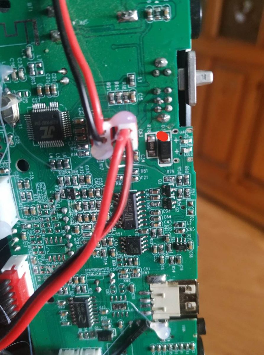

    I marked in red ("+") and blue ("-") points where you can solder with a 5V power supply:
    rimot wrote:
    First of all, clean thoroughly (get rid of excess tin) in the mounting location of the socket - it looks like there is a short circuit between pins 4 and 5.
    Check with an ohmmeter.

    thanks to 'jdubowski' I did according to your advice how it works so far, the charging diode glows slightly during charging, we will see after a few cycles.
    I have to buy the right usb-usb cable because I plan to convert the charging socket into a full usb socket, I will show you the photo when I'm done.

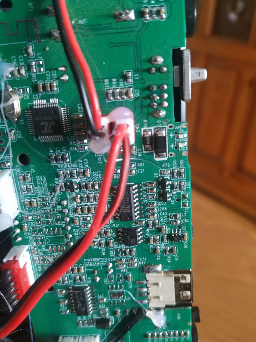

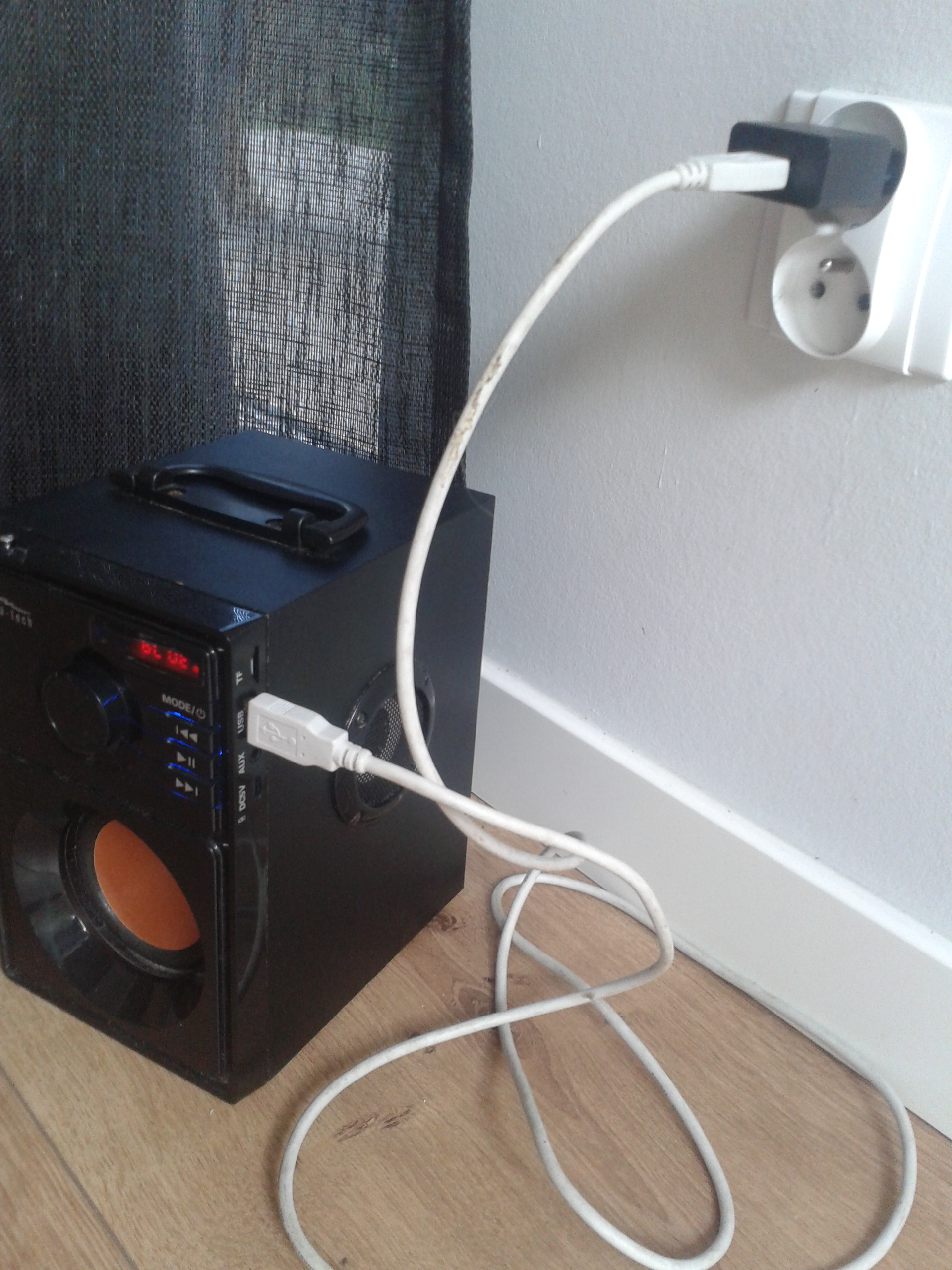

    If you have a damaged charging socket, charge via USB socket. I did it and it works :) .
    I am currently testing this solution because in this configuration the charging diode does not light up in red, and additionally the charging in the USB causes the device to start. from what I remember while charging, the battery icon on the display was blinking in the broken socket. see

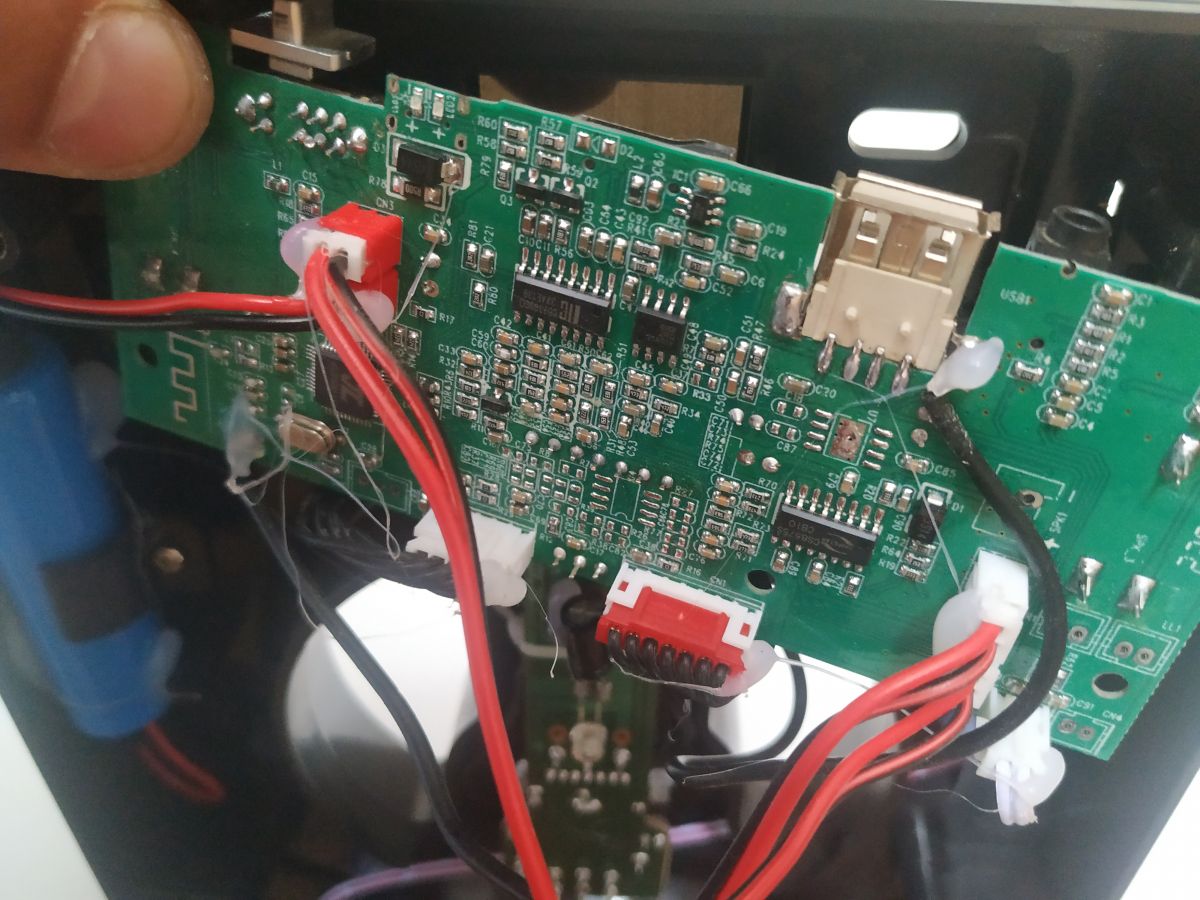

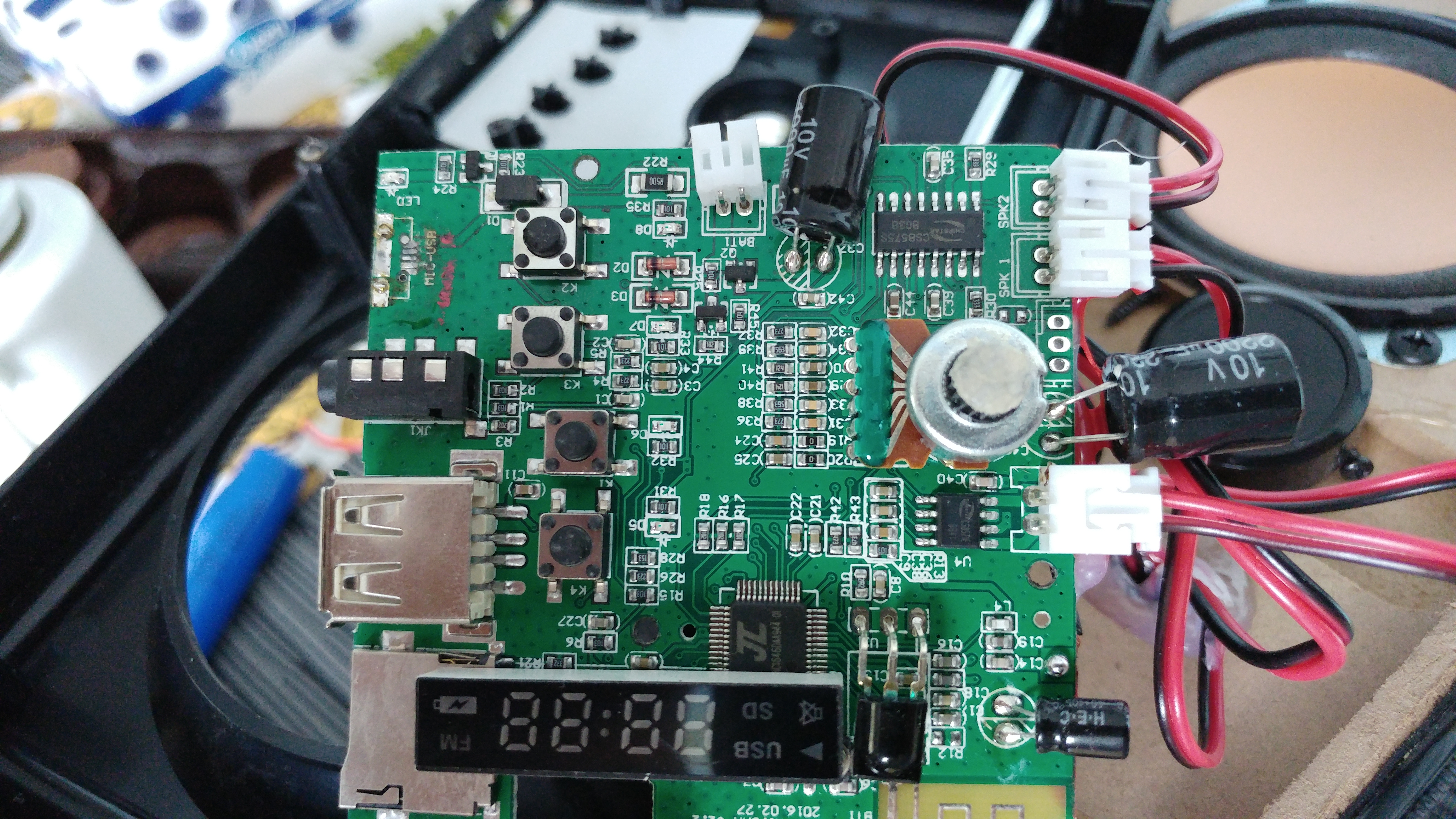

    I recommend such a thing only that I gave there 5x18650 so the power bank charges faster than from this original socket. I recommend this solution for someone who doesn't like or can't be under the charger every now and then. After unscrewing the battery container, there is a lot of space inside.

    Saffron can you write what components you used? Some photo from the inside would be helpful ;)

    #13 20610831
    ivanharry
    Posts: 9

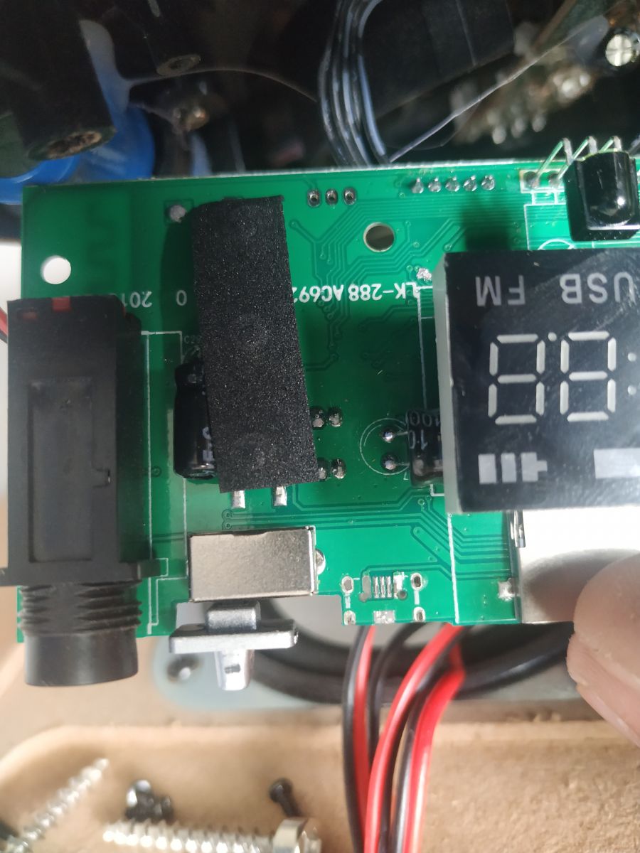

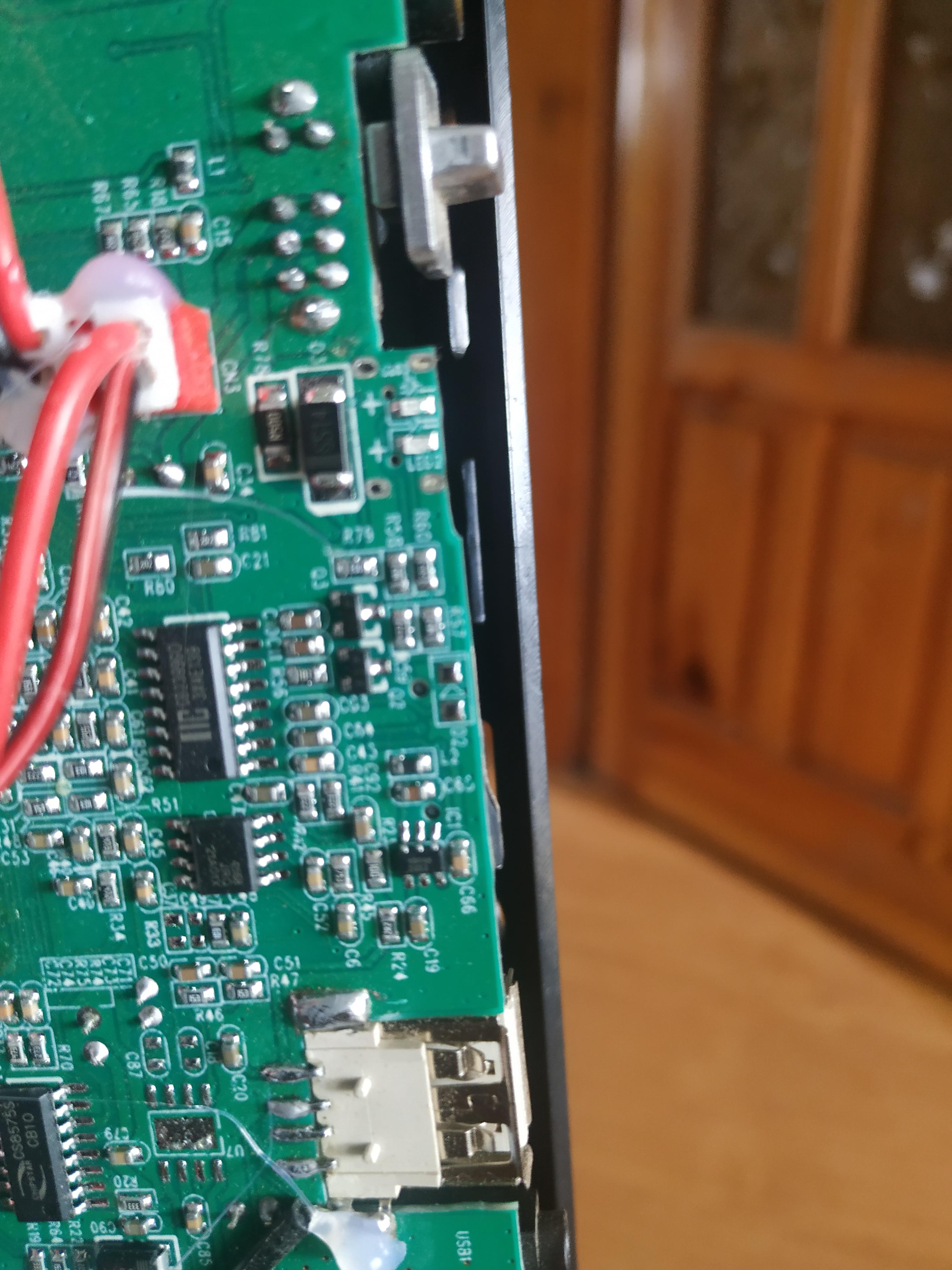

    I have a similar problem, only one that I can make a plus and minus on the final and initial pin because the soldering place is broken where would you give a plus and where minus I send photos MediaTech Boombox BT MT3145: How to Charge Device Bypassing Micro USB Port? MediaTech Boombox BT MT3145: How to Charge Device Bypassing Micro USB Port? MediaTech Boombox BT MT3145: How to Charge Device Bypassing Micro USB Port? MediaTech Boombox BT MT3145: How to Charge Device Bypassing Micro USB Port? MediaTech Boombox BT MT3145: How to Charge Device Bypassing Micro USB Port? MediaTech Boombox BT MT3145: How to Charge Device Bypassing Micro USB Port? MediaTech Boombox BT MT3145: How to Charge Device Bypassing Micro USB Port?
    • MediaTech Boombox BT MT3145: How to Charge Device Bypassing Micro USB Port? IMG_20230609_153723.jpg (865.85 KB) You must be logged in to download this attachment.
  • #14 20610917
    jdubowski
    Posts: 21595
    Help: 2511
    Rate: 2804
    ivanharry wrote:
    where would you put a plus and where a minus
    You have in post #7 painted.
  • #15 20611377
    ivanharry
    Posts: 9
    Yes, but there is a slightly different layout and a different description, so I don't know which diode to give
  • #16 20611471
    jdubowski
    Posts: 21595
    Help: 2511
    Rate: 2804

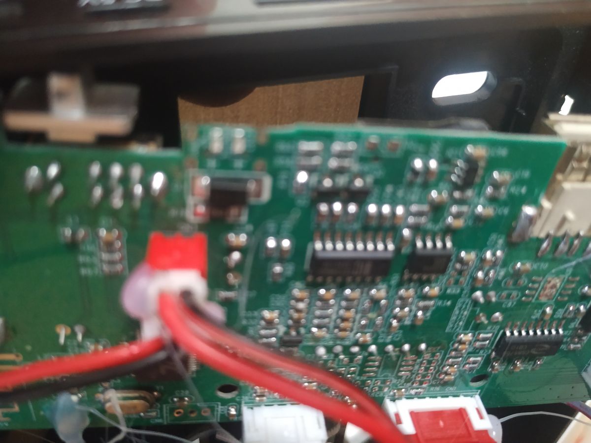

    Another version of MediaTech Boombox BT MT3145?
    Because it looks like something else to me...
    Solder in the marked places, you have to scratch off the soldermask:
  • #17 20611477
    ivanharry
    Posts: 9

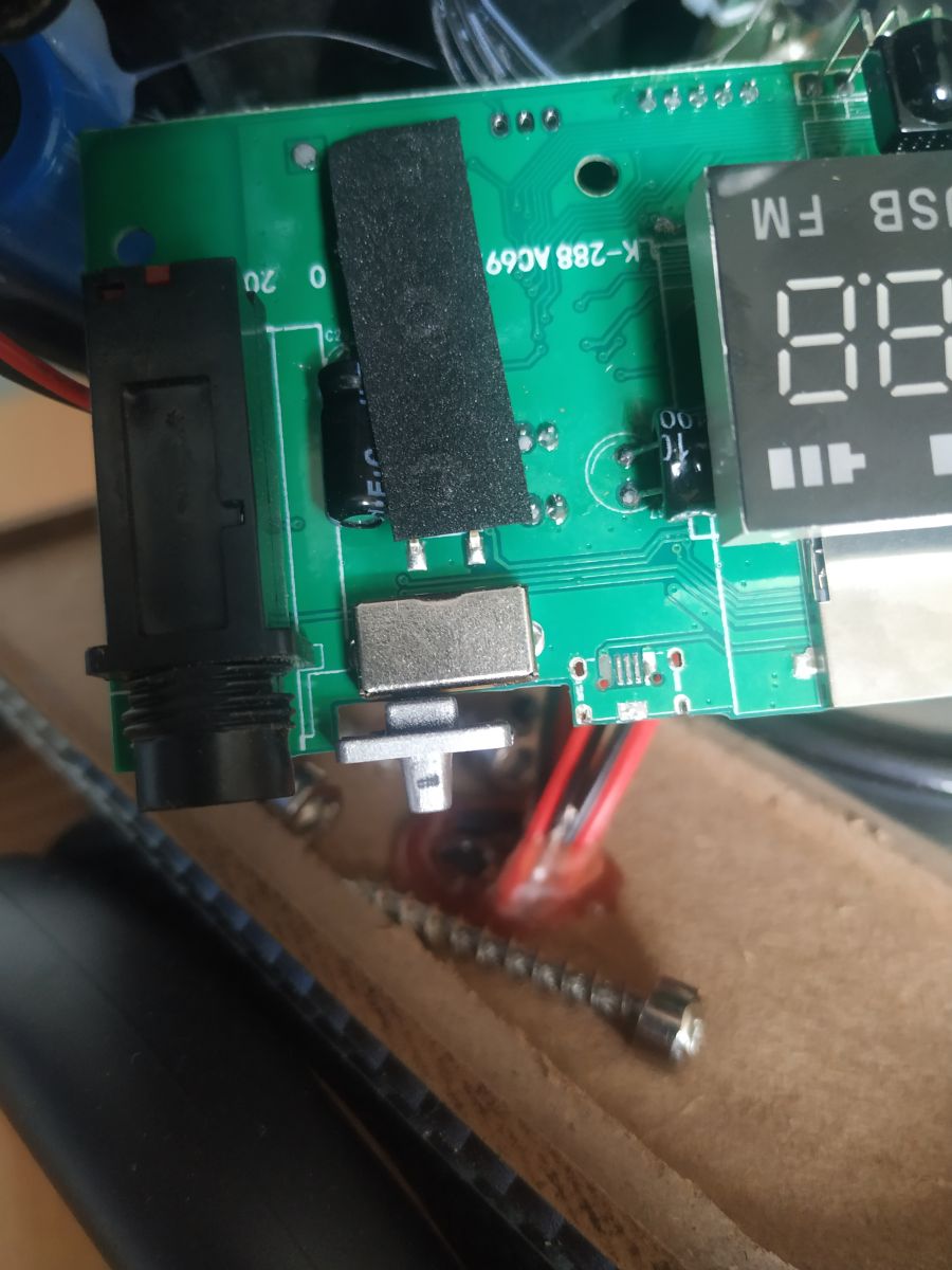

    It is not the MT3150 MEDIATECH
    Added after 7 [minutes]:
    I scratched it as you said, I'll try to solder it and see if it works MediaTech Boombox BT MT3145: How to Charge Device Bypassing Micro USB Port?
    It'll be all right ?
  • #18 20611513
    jdubowski
    Posts: 21595
    Help: 2511
    Rate: 2804
    It will be, unless you make a short circuit (check with an ohmmeter) and you have no other damage.
  • #19 20616014
    ivanharry
    Posts: 9
    Is there any other option to solder it because I scratched it but I don't want to solder it and the plus can't be done because the path is too thin is there another option on some diodes or these battery inputs? MediaTech Boombox BT MT3145: How to Charge Device Bypassing Micro USB Port? MediaTech Boombox BT MT3145: How to Charge Device Bypassing Micro USB Port?
  • #20 20617102
    ivanharry
    Posts: 9

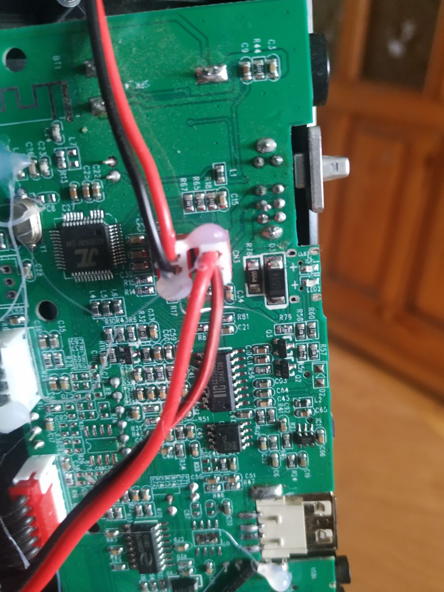

    I can do it as stated
  • #21 20618430
    jdubowski
    Posts: 21595
    Help: 2511
    Rate: 2804
    Either the wrong equipment and materials, or a lack of skill. Learn to solder on some electronic scrap.
    Alternatively, take it to someone who can.
    And is it exactly the same path? Because the picture doesn't show it...
  • #22 20618481
    ivanharry
    Posts: 9
    I checked with a meter and it's the same
    Added after 4 [hours] 45 [minutes]:
    I did as indicated and it works
