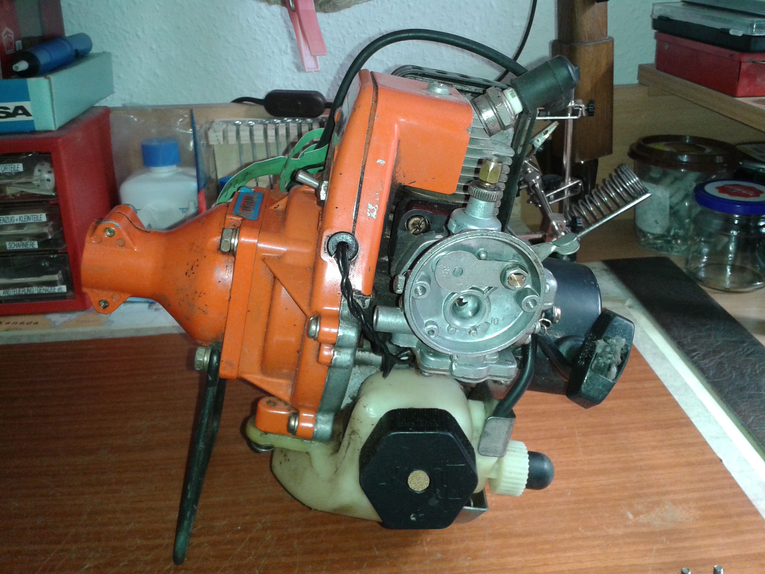

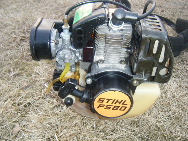

    Hello, I have a problem with the old model of the Stihl FS 80 brushcutter, I have no spark, I have a question how to check the ignition coil?
    I still have such a question, there is such a small device under the manual starter, is it a capacitor?
    The photos show what the Stihla model is.

    Under the cutter? That black ball? It's a fuel pump to start!
  • Check HV wire, coil gap, and spark plug

    As mentioned above, it is a fuel pump button (we use it before starting the engine, especially when it is cold). Check the HV wire, whether it is torn from the HV coil, whether the wire from the ignition switch is not chafed and does not come into contact with e.g. the engine crankcase (metal), whether the HV coil is properly fixed, i.e. with a minimum gap between the magnet wheel and the HV coil . Replace the spark plug with a good one and pull the starter more vigorously.

    Hello, it's black, I know that the pump has a bad photo loaded and I did not check the post later, now I will attach a photo what I mean, a small silver box next to the shaft

    The scythe is rather lukewarm, so in my opinion it will probably be a "box" with a traditional interrupter. Unscrew the screw and you will probably find out that it will be an ignition module. Read type, name etc ..

    so old over 20 years old for sure because she still writes made in japan
    ok and I'll see what's writing on that box in my free time
    Added after 7 [minutes]:
    Skoda, I dump somewhere for scrap because it has great compression only with this spark I have to get in order
