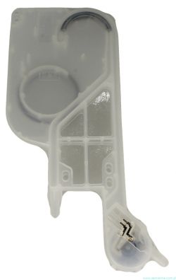

    I have a problem with my dishwasher. After a few minutes, the display shows error H.
    After switching on, the dishwasher pumps water somewhere, then drains into the drain, then begins to fill with water. After a while, the H error appears and begins to quit without closing the valve and thus overflows the chamber with water. After opening, it drains the water immediately.
    Did any of you have such a symptom?

    The problem was a damaged reed switch (tube) counting the amount of water. It is on the left side of the dishwasher. Look at the bottom of the item from the photo. Ariston LTF11H132 Dishwasher - Error H Display, Overflow & Draining Issues .

    Replacing this separator also helped me. Thank you for your tips.
