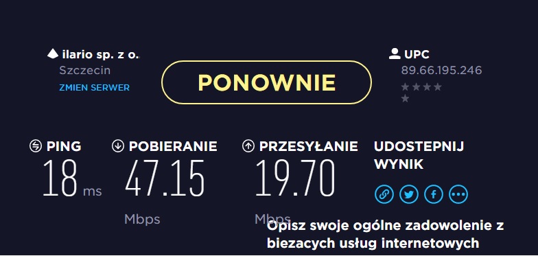

  • #6 16594652
    bkrodman85
    As for the router itself, I have Horizon from UPC, the router is a meter away from me, no more, the more I'm surprised by such a low connection. I have HT Mode enabled
    Below are the photos you wrote about.
    Configuration of the network card to work in the 802.11n standard
    Added after 5 [minutes]:
    This is my speed.
  • #7 16594670
    Heinzek
    Posts: 3732
    Help: 554
    Rate: 494
    Speed Is OK for your "synchronization" with the router - 72.2Mbit / s
    Where you have 802.11n width set to 40MHz and in the router also set the channel width to 40MHz. The speed should increase to around 80Mbit / s
    As if you had a card with a "full" N, the synchronization on the 20MHz channel is ~ 150Mbit / s
  • #8 16594707
    bkrodman85
    Unfortunately, but in this 802 / 11n I only have 20Mhz Only and Auto.
    What does the "full" N card mean? Is it worth changing the card, especially if I change to 250Mbit / s?
  • #9 16594778
    Heinzek
    Posts: 3732
    Help: 554
    Rate: 494
    Set to "Auto".
    A card with N that supports a connection up to 300Mbit / s (synchronization) in real about 100-120Mbit / s
    You won't reach 250Mbit / s on WiFi at 2.4GHz. Here only the 5GHz band with AC mode. Of course, the router also needs to support it.
  • #10 16594792
    bkrodman85
    The change to Auto did nothing, even as I changed the router to 40Mhz.
    The Horizon router itself has a 5Ghz option, so you should think about changing your network card to AC support. Now I don't think I can change anything, unless I connect it via a cable, then I will have a speed of up to 100Mbps, this is my card's maximum speed.
