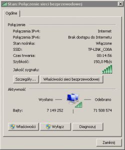

    @_cheetah_ , in device manager I don't know which device to choose:
    Check Network Card Speed: Steps for Wi-Fi Maximum Internet Speed Evaluation
    In the connection properties (when connected via Wi-Fi) it shows me a speed of 65.0 Mb / s - so this is the maximum speed I can achieve without a cable?
    I am asking this because in the near future I am going to switch from neostrada to 300 Mb/s optical fiber and I would like to achieve the highest possible speed by connecting via Wi-Fi.
    Should I buy a different/newer card to get the maximum speed?

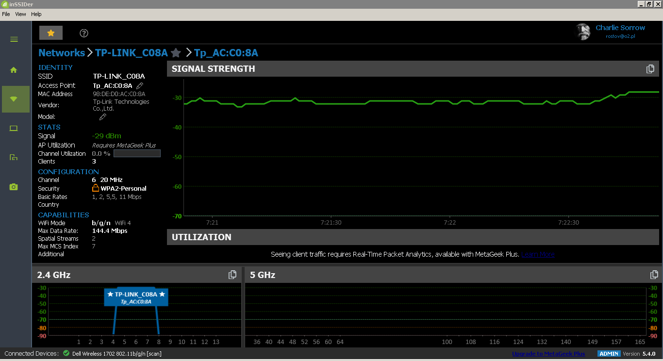

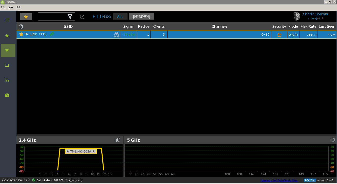

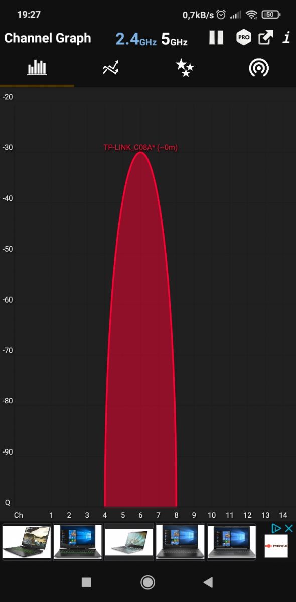

    #11 19379986
  • InSSIDer screenshots from laptop near router
    #13 19380077
    rostov84
    Posts: 924
    Rate: 213
    @_cheetah_ , my version of InSSIDer looks a bit different, so I'm posting 2 screenshots. I hope that's about it.
    In my case, one location is the most important - the laptop on the desk, the router is about 0.5 m from it.
    Check Network Card Speed: Steps for Wi-Fi Maximum Internet Speed Evaluation Check Network Card Speed: Steps for Wi-Fi Maximum Internet Speed Evaluation Check Network Card Speed: Steps for Wi-Fi Maximum Internet Speed Evaluation

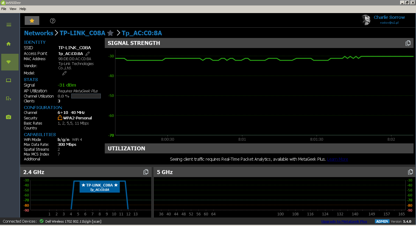

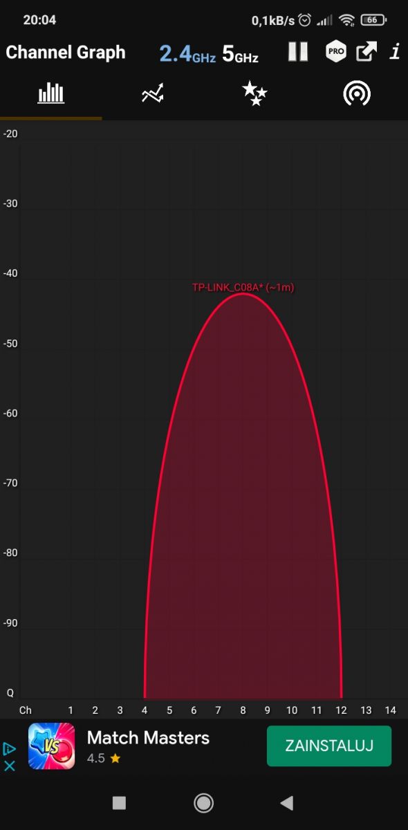

    #14 19380112
  • Configured 20/40 MHz channel width on adapter and router
    #15 19380174
    rostov84
    Posts: 924
    Rate: 213
    @_cheetah_ , in the network card settings, in the '802.11n Bandwith' property, I set the value '20MHz/40Hz Auto' (I don't have the 40MHz value).
    However, in the router's wireless network settings, I set the channel width to '20/40MHz' (there is also no 40 MHz value here).
    Now the situation looks like this:
    Check Network Card Speed: Steps for Wi-Fi Maximum Internet Speed Evaluation Check Network Card Speed: Steps for Wi-Fi Maximum Internet Speed Evaluation Check Network Card Speed: Steps for Wi-Fi Maximum Internet Speed Evaluation Check Network Card Speed: Steps for Wi-Fi Maximum Internet Speed Evaluation
