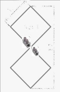

    Can I use aluminum wire (instead of copper) to build a biquad antenna for TV reception?

    Certainly you can, most of the factory antennas are made of aluminum, in amateur constructions copper is used because it is easy to connect by soldering

    Well, you can only that aluminum cannot be soldered ...
    There are special alloys and fluxes for soldering Al

    There are, but their cost will exceed the cost of the antenna, or at least a copper wire ....
    BTW, a 4.8mm copper tube is about PLN 8 / meter

    jarek_lnx wrote:
    most of the factory antennas are aluminum
    How do I fix this soldering problem? Give me an electric cube?

    Outwardly, I do not recommend the connector oxidizes very quickly. In general, aluminum is quite a nasty material in contact with other metals.

    If I would make copper and solder, do I have to put it in a can? Is it just for decoration?
    It is such a temporary solution with this aluminum.
