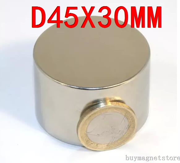

    I wonder what effect a neodymium or other magnet can have on electronics and household appliances?
    One of my observations is that when I placed a neodymium magnet (dimensions 45mmx30mm) next to it, the smartphone turned off after a few moments. I also suspect a negative impact on the SIM card.
    Anyone know anything more?

    • Effect of Neodymium Magnet on Electronics & Household Appliances: Smartphone & SIM Card Impact 45-30-font-b-45mm-b-font-x-30mm-font-b-disc-b-font-powerful-font.jpg (79.49 KB) You must be logged in to download this attachment.
