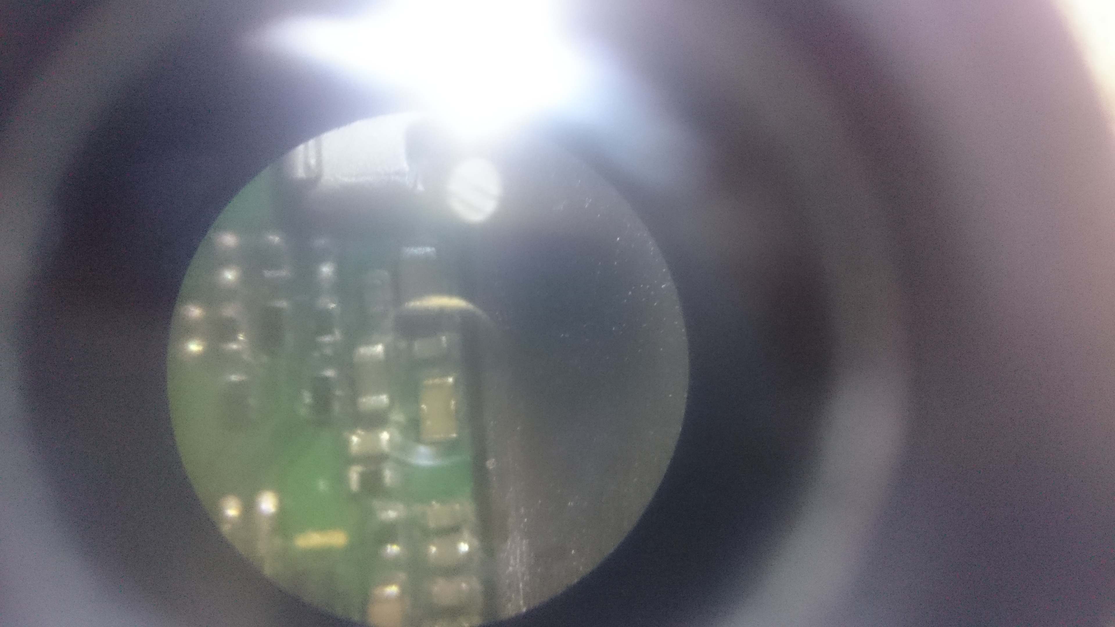

    Huawei P8 Lite phone - no GSM coverage
    Phone damaged due to flooding.
    Dead due to a complete short circuit in the power supply caused
    corrosion of capacitors.
    After cleaning the corrosion and removing the short circuit, the phone starts correctly.
    No GSM coverage for both SIMs.
    Further examination of the plate allowed to determine the lack of the element marked in the picture.
    Does anyone know what this element is?
    Can it affect the GSM range?
    Identifying Unknown Component in Flood-Damaged Huawei P8 Lite Affecting GSM Coverage Identifying Unknown Component in Flood-Damaged Huawei P8 Lite Affecting GSM Coverage
    It looks like a capacitor on the pads :) Usually the lack of capacity does not bring anything special, except in the converter circuit (pump / feedback / reference voltage)

    If it's a capacitor, it should not really affect this behavior. I wonder, however, that there are 4 empty pads on the missing element. What kind of capacitor?

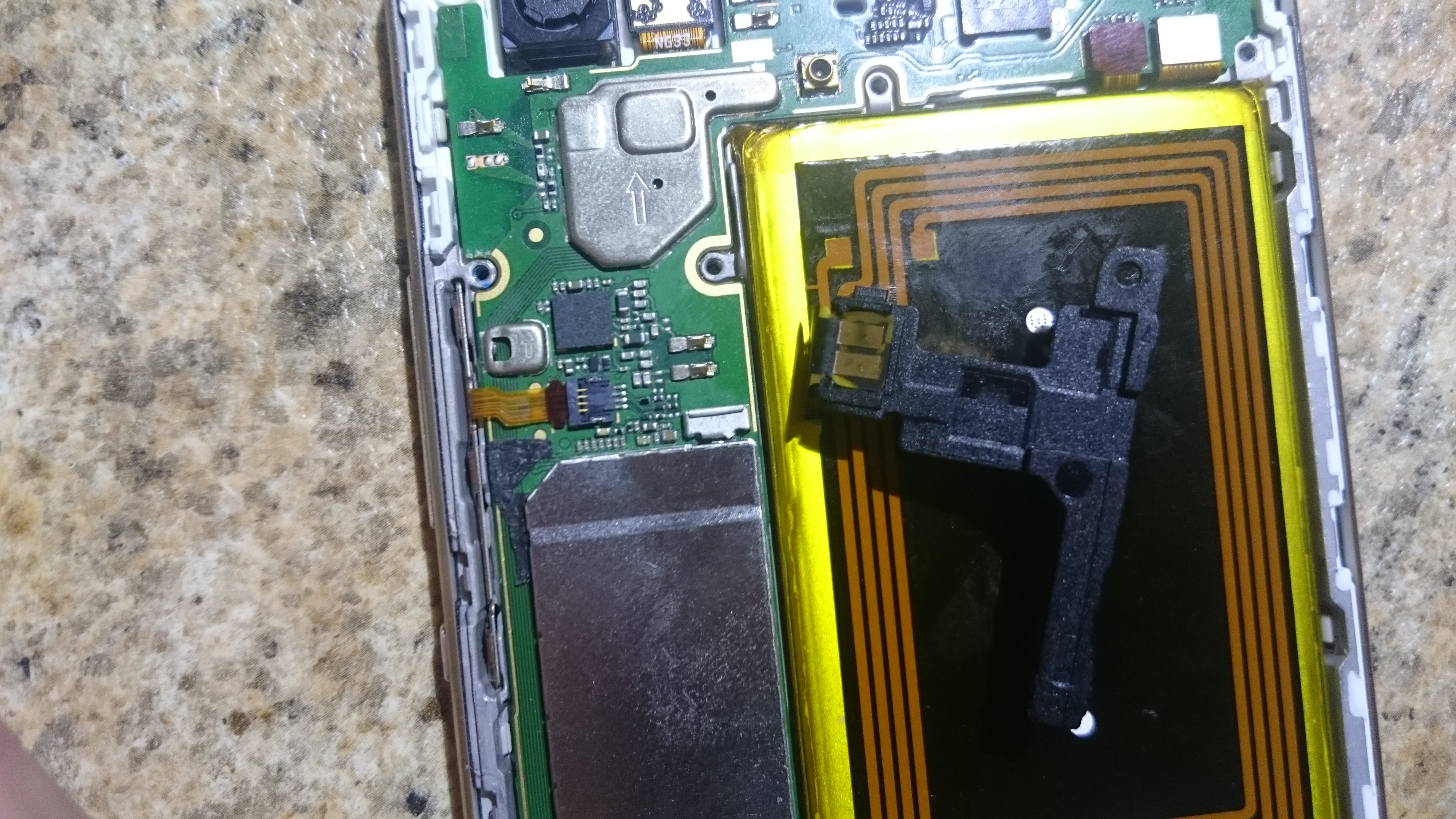

    I apologize for the poor quality of photos (I do not have anything better at hand) but it may be useful to someone. For me, the element is, and unfortunately, the range is missing. Tel also after flooding. Anyone have any suggestions ??

    I recommend searching for x2y filter capacitor.
