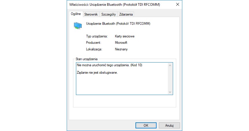

    Hello. I have an Acer Aspire One 722 laptop, the laptop has a built-in bluetooth. After upgrading to Windows 10, the device disappeared. There is no sprite in the action center, the bluetooth device manager is not listed even if hidden devices are shown. I've tried many things, I have restored the system - it did not help, in the manager the services related to bluetooth are turned on to automatic mode, I uploaded various drivers and programs - the drivers do not work and nothing is detected by bluetooth devices, as if it was not there. I tried to add to the manager the older device and bluetooth found -> network cards ---> tab windows ---> bluetooth device (RFCOMM TDI protocol), but after adding the message "Can not start this device (code 10)" pops up. In addition, I think that there may be a related error in the AMD Catalyst Control Center software update (an error 182 pops up). I do not know what could help, especially since I do not know it, that's why I count on help.

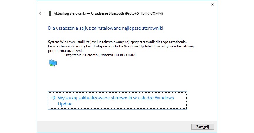

    You have device manager run, search for a device with a problem ie BT and install the driver with the "Update driver" function.
    Post the view of this device manager.

    #4 16603584
    Ana614
    Posts: 7
    update nothing away. Below photo without added Bluetooth device, with added and after update. When it comes to windows update, the latest updates are uploaded.

    Post info about the error code from sceena # 2 (properties).
