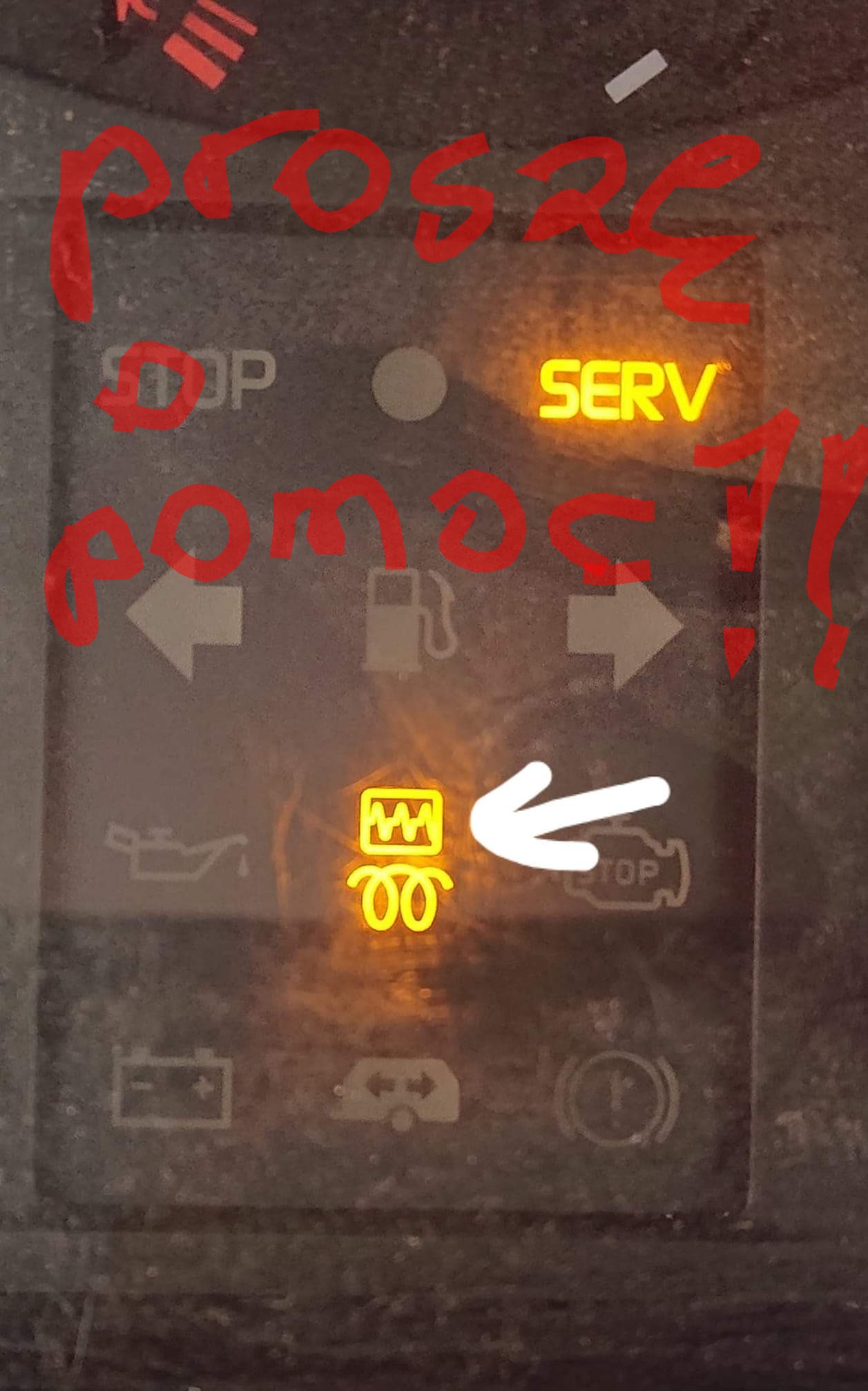

    I have a problem because for some time Laguna has entered into an emergency mode after heating up and switching to LPG. It does not lose its power but wavers with revolutions as in emergency mode (2000-3000) of revolutions.
    The glow plug indicator lights up all the time ...
    Potentiometry showed error - eliminated - but the situation continues.
    Now it shows the error of the lambda probe - but the combustion is normal.
    Only the candlelight is lit, no other service, etc ..
    Please, help me. What can she go about?

    Buddy, this is not a candle lamp but a problem of the electric system. After 1, make a specific diagnostics with a clip and not an invention. What you describe looks like a throttle problem

    Hello, I have the same problem. I've already been at the gasifier I exchanged filters candles the temperature was elevated because I thought the regulator was freezing but still the problem was. As soon as the car switches to gas, this indicator is displayed, whether you and the car go into this mode where the gas pedal does not work at all and the car is driving slowly. Did you get what was the reason?
