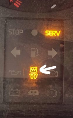

  • #8 18060346
    Agata1231
    Rate: 10
    Hello, can you write to me what was the cause of your breakdown because I also have this light on, and it's only when I'm on gas, then the car goes into the travel mode because it drives alone and
    Renault Laguna 2 1.8 16v - Glow Plug Indicator Issue, RPM Limit, Gas, Mechanic Diagnosis & Cost
    gas pedal does not respond. I thought they were filters or candles, but I replaced them and that but the problem remained. First, I was at the gas engine, but I found nothing, then I went to the mechanic and said that it could be a speed sensor, but if it only happens on gas, it must be checked by a gas mechanic. So I'm in a bind, I am asking for advice.
    • Renault Laguna 2 1.8 16v - Glow Plug Indicator Issue, RPM Limit, Gas, Mechanic Diagnosis & Cost FB_IMG_1562928172745.jpg (131.84 KB) You must be logged in to download this attachment.
  • #9 18060787
    kamiloskop
    Posts: 555
    Help: 42
    Rate: 279
    Hello. There may be many reasons for this. It fits in the car for diagnostics and then you will know what the electronic problem is
  • #10 18061176
    Agata1231
    Rate: 10
    First, I was at a mechanic who deals with gas, he showed no error Then I went to another mechanic, he also did not work out and said that if it only happens on gas, I should go to a mechanic who deals with gas, so they send me from one to another I do not know
