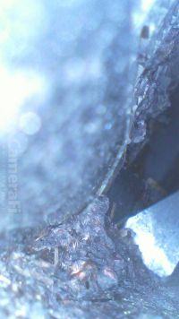

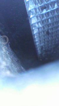

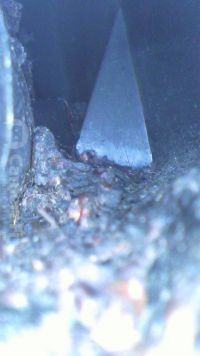

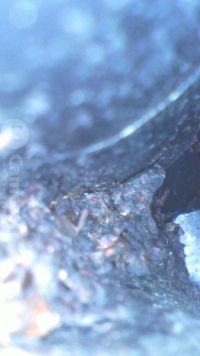

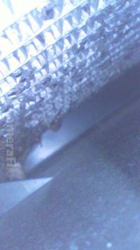

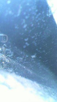

    Colleagues, I have a problem with the air conditioning. It smells terrible. 4 years ago I bought a car and after about half a year later (when it started to get warm), it turned out that the climate stinks. Since then, I have tried ozonation in cheap and expensive plants many times, tried various types of gases, foams and specifics, it did not help much.
    Klima stank for a moment from the moment of switching on and for a long time after switching off. There was nothing wrong when it was not used. This year I gave to the "spec" who did ultrasound cleaning for me. For a week, maybe two were ok. Unfortunately, then the smell returned and it was stronger. I went to the amendment and unfortunately after 3 tries now it smells mercilessly and in addition non-stop. I checked with a probe how it looks inside and it doesn't look nice. What can this be done here?

    What you marked in the picture - the black box with the yellow connector is a pillow driver.
    You can do it yourself but you need to pump the refrigerant from the air conditioning system.
    Disassembly board, heater housing for removal and evaporator from it. It needs to be washed from the outside to remove the fungus, and to clean the inside of the heater housing.
    After completing the works, check for leaks and purchase of the system.
    I suggest replacing the O-rings on the evaporator connector.
    If you have a fungus on the evaporator, you will not remove it, no ozonation, ultrasound or foam.
    Mechanically it is hard to do, let alone some miracles.
    There are special liquids for cleaning air conditioning + hot water for cleaning. Look for a company that makes air conditioning in offices / homes and they'll sell you some of this liquid.
    Do not go crazy with some inventions so that you do not chew aluminum.
    Ozone treatment, etc. is a preventive measure and not a medicine for stench, as it stinks it is only people who are starting to take care of the atmosphere but then it is too late.
