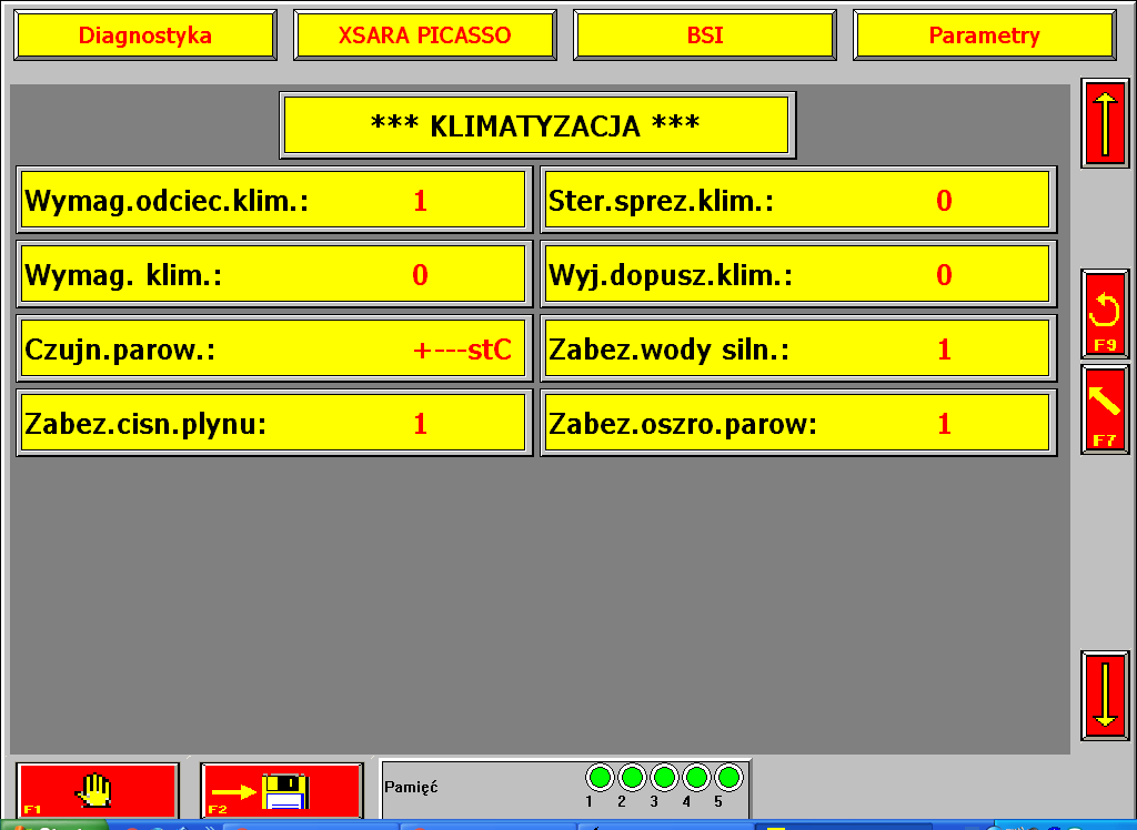

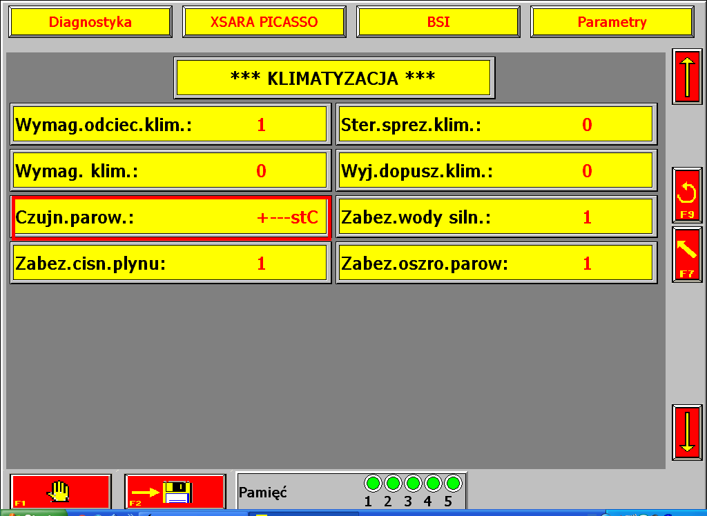

    There is a cutoff request.
    • Xsara Picasso Air Conditioning: Condenser, Low Pressure Pipes Installation & Activation Issues klima.png (40.24 KB) You must be logged in to download this attachment.
    • Xsara Picasso Air Conditioning: Condenser, Low Pressure Pipes Installation & Activation Issues 2017-07-16_061932.png (53.85 KB) You must be logged in to download this attachment.

    In the diagram I see a temperature switch that cuts off the climatic water in case of overheating the liquid and in the first picture I see "protecting the water of the engine" as active - to be checked first.

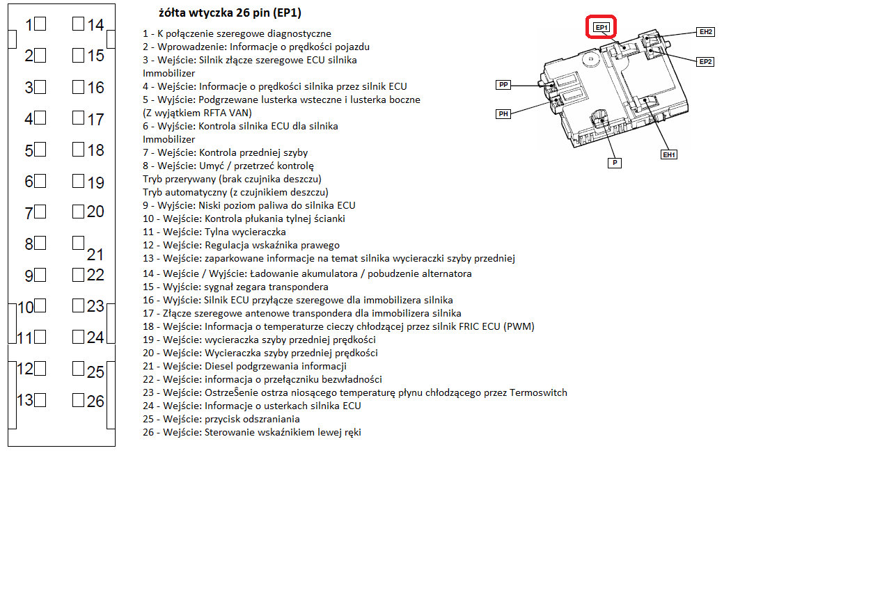

    I have checked the cables 401, 405 it is the yellow plug 26 pin EP1 connector and has a full transition to the motor controller.
    I do not know if this has any effect on the air conditioning, but burying today I unscrew the can with the fan relays, there are three relays first left after connecting shortly turns the fan on max, the third relay turns the fan slow and the second relay (middle) it is controlled from the pressure switch from the third pin and after joining it for a short time, nothing happens, there is no voltage at terminal 30, contact 87 goes to the gray fan resistor.
    Should it be like that ???

    And one more thing puzzles me, in the option of configuring the item the air conditioning is NO,
    can someone suggest something?

    in the option of configuring bsi, the air conditioning position is NO,
    Probably from here the system can not see the pressure of the factor and other options related to air conditioning, you can do it in BSI, check the other modules.

    Only I have a problem with this configuration,
    how I change to yes. this system asks for the code, enters 03114 and the system asks for a secret code, enters the code two digits and two letters which I bought in aso and the system displays the wrong code.

    Welcome back,
    after recovering the pin code and correct coding, it was possible to code the air conditioning.
    But unfortunately the climate still does not work, there are zero everywhere.
    Please help.

    After coding the bsi and changing the multiplex air conditioning on, the 55mm evaporator sensor is on, and the air conditioning is on, the air conditioning is ON.
    Thank you very much for all your help.
    Subject to be closed.
