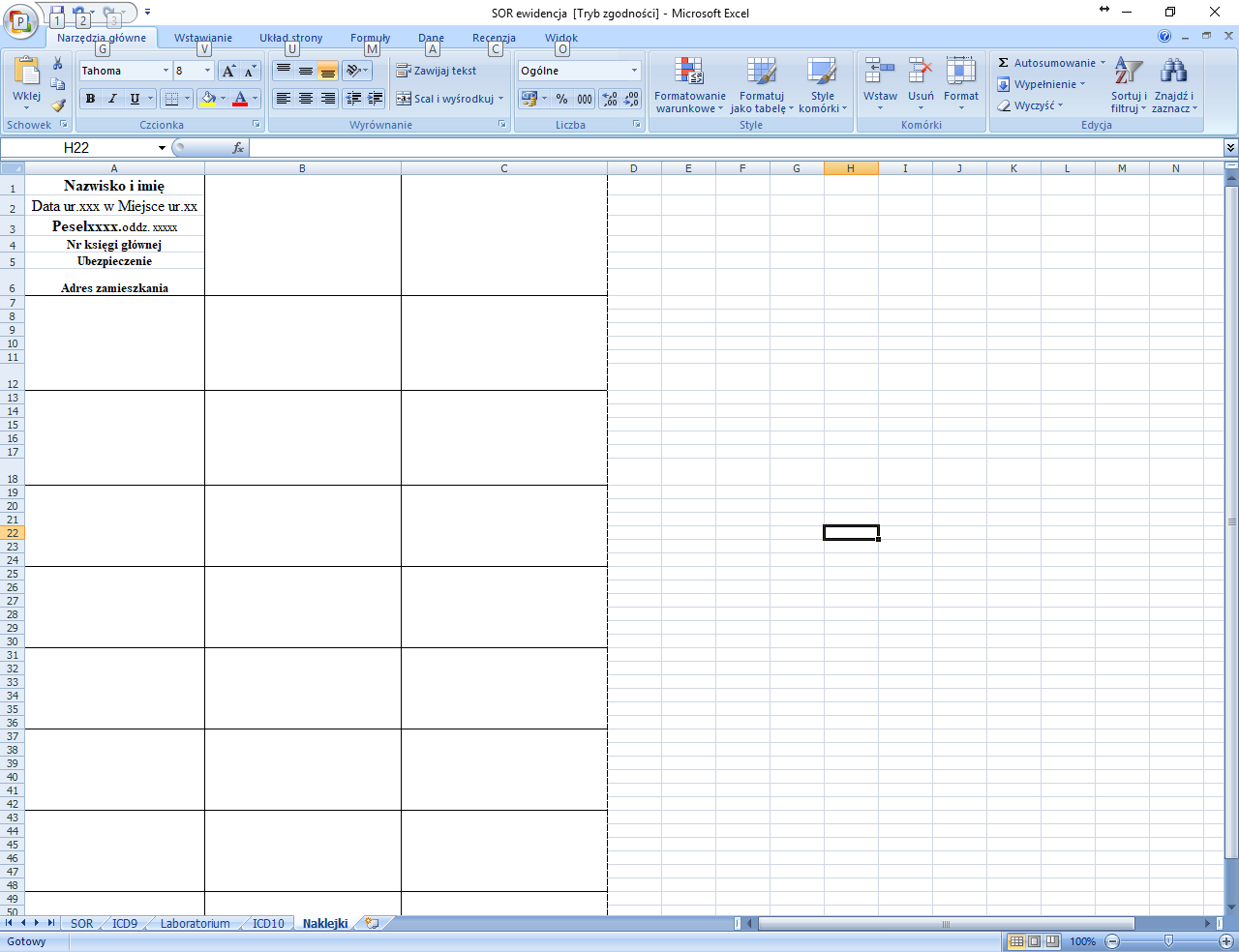

    Hello, I have a problem.
    I got a request to create an Excel file that has several sheets.
    Namely, the point is that the data entered in the sheet "SOR" (or more precisely, each last entry), transferred to the sheet "Stickers" and automatically completed.
    The data to be transferred are:
    First name and last name
    Date of birth
    pesel
    Branch
    General ledger number
    Insurance
    Address.
    The point is that when you introduce a new patient, it automatically filled in the patient's data to the "Stickers" sheet so that they would not have to enter the data manually a second time.
    This is my first post on this page. I am asking for your understanding.
    Attached are screenshots of these sheets
    Transferring Last Entry Data from SOR to Stickers Sheet in Excel Transferring Last Entry Data from SOR to Stickers Sheet in Excel

    I don't know if I understand correctly, but just in case I will write: the simplest way of direct cell reference is not an option? You enter the "=" sign in the target cell, then you change the worksheet, select the cell to be moved and confirm. In this way you link all others. With the right arrangement of rows and columns, you can do it with one drag.

    With the assignment, the cell will not burn permanently, because when a new patient arrives, he will not display it. There must be something such that from each last entry in the "SOR" tab, this data also lands in the "Stickers" tab and repeats in 27 fields (3 columns x 9 lines).

    It can overwrite, even better if it overwrites. Because they only print these stickers for a given patient once. And how will the new patient get overwritten with the data of the new patient for the previous one, and so on.
    The point is that every new patient should be overwritten in stickers.

    e.g. for A1 in "Stickers" enter
    = INDEX (ED! C: C COUNTA (SOR! C: C))
    The last row will always be given
    Column D for SOR and almost attention - integrated cells
    then for example A5 will be already
    = INDEX (ED! I: I; COUNTA (SOR! I: I) 1)
