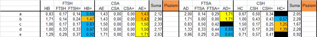

    I need help with a similar matter. I want to create a sheet with a drop down list. Pattern:
    Excel: Auto-Fill Cells in Second Sheet Based on Data & Dropdown Selection from First Sheet
    Please help!

    It is important to me that when changing R1, R2 etc. these coefficients assigned to a specific R1, R2 etc. have changed. i.e. e.g.
    when selecting R1, it automatically completes the cells related to R1
    when selecting R10 -ll- -ll- -ll-
  • #12 16536373
    krzychu.m
    Level 19  
    Posts: 839
    Help: 19
    Rate: 94
    So if you change the value to R1 in cell A3, the values should change in the entire row 3, right?
  • #13 16536407
    Junior85
    Posts: 29
    Rate: 14
    Exactly,
    for R1, the data assigned to HB and HF as well as HC and HH should change
    (FTSH and HB = are calculated as HB * HF = FTSH and HB-FTSH = HB = ) - similarly in the case of CSH and HC =
    with R2, the data assigned to AE and AI as well as AD and AG should change
    (CSA and AE = are calculated as AE * AI = CSA and AE-CSA = AE =

    But what should HF, HH, AI, AG change for? You do not have data for them, and if they are to change, what is to be calculated there?
    Added after 12 [minutes]:
    Something like that?
    • Kopia Test1.xlsx (12.66 KB) You must be logged in to download this attachment.

    I changed because there were references to cells, not headers. It should be clear now.
    Gray box - cells that are calculated
    Colored fields - should be automatically completed with "data"
    • Test-Nowy.xlsx (11.74 KB) You must be logged in to download this attachment.

    The previous sheet is super because there is a drop-down list and the data is in a separate tab.
    Will adjust, thanks and sorry for the confusion!
    Greetings!
    Added after 1 [hours] 12 [minutes]:
    Unfortunately, there are errors:
    FTSH - instead of 0.33 a is 0.40
    CSH instead of 0.17 a is 0.00
    AD instead of 0.83 a is 1.17
    And one more question, is it possible to add, for example, 100 records to "data" and will something need to be changed in the spreadsheet?
    • Test2.xlsx (11.83 KB) You must be logged in to download this attachment.

    President open the file copy test-new.
    instead
    = VLOOKUP (L2, $ A $ 2: $ I $ 17,2,0)
    you write
    = VLOOKUP (L2, $ A $ 2: $ I $ 100,2,0)

    1. Would like to do conditional formatting for HB, AE and AD and HC cells. If any of these cells has the value = 1.5 AE> = 2
    HB> = 1 AE> = 2
    HB> = 2 AE> = 2
    HB> = 0.5 AE> = 2 - all in one color
    I mean the formulas
