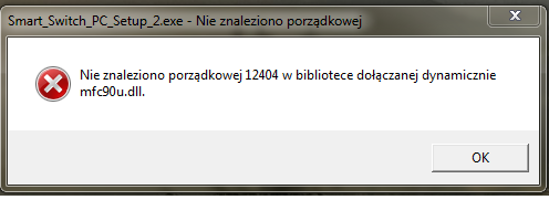

    Hello. I need to install the program as in the subject, but I get a message like a photo. I downloaded the program from various sites and the same error all the time.

  • Install all Microsoft Visual C++ redistributables
    #2 16617907
    Kolobos
    IT specialist
    Posts: 85182
    Help: 17174
    Rate: 10460
    Zainstaluj wszystkie wersje:
    Microsoft Visual C++ 2005 Redistributable
    Microsoft Visual C++ 2008 Redistributable - x64
    Microsoft Visual C++ 2008 Redistributable - x86
    Microsoft Visual C++ 2010 x64 Redistributable
    Microsoft Visual C++ 2010 x86 Redistributable
    Microsoft Visual C++ 2012 Redistributable (x64)
    Microsoft Visual C++ 2012 Redistributable (x86)
    Microsoft Visual C++ 2013 Redistributable (x64)
    Microsoft Visual C++ 2013 Redistributable (x86)
    Microsoft Visual C++ 2015 Redistributable (x64)
    Microsoft Visual C++ 2015 Redistributable (x86)
    Z WU lub ze strony MS.

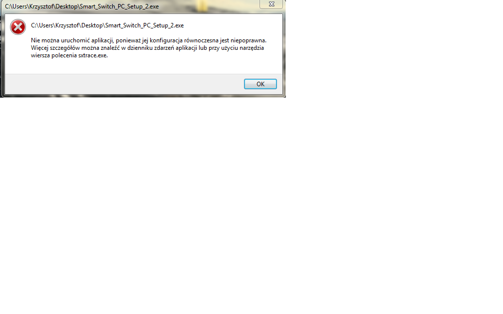

    After installing all versions of a colleague Kolobos, the error continues.

  • #6 16618711
    MrDoimer
    Posts: 5691
    Help: 271
    Rate: 125
    This is still a Microsoft Visual C ++ error.
    System updated?
    All installations went without a problem?
    Try to uninstall MS Visual version 2008 and reinstall.

  • #11 16619208
    Kolobos
    IT specialist
    Posts: 85182
    Help: 17174
    Rate: 10460
    This file is included in the Microsoft Visual C ++ 2008 Redistributable - x86:
    https://www.microsoft.com/en-us/download/details.aspx?id=10015
    However, even after installation, the error may still be displayed, it is enough that the wrong file is in a different directory than the one to which this update is installed.
    Uninstall Microsoft Visual C ++ 2008 Redistributable - x86 for now
    Download https://www.bleepingcomputer.com/download/farbar-recovery-scan-tool/
    To the program window, paste: mfc90u.dll
    Click Search Files and place in the attachment the log that will be created after execution.

  • #13 16619295
    Kolobos
    IT specialist
    Posts: 85182
    Help: 17174
    Rate: 10460
    Only this left:
    C: \ Windows \ winsxs \ x86_microsoft.vc90.mfc_1fc8b3b9a1e18e3b_9.0.21022.8_none_b81d038aaf540e86 \ mfc90u.dll change its name to mfc90u.bck
    Install https://www.microsoft.com/en-us/download/details.aspx?id=10015 and check if Smart Switch will start, if not try to replace the file from system32 (because it probably installs there) on this:
    C: \ Program Files (x86) \ Samsung \ Kies3 \ mfc90u.dll
  • #14 16635065
